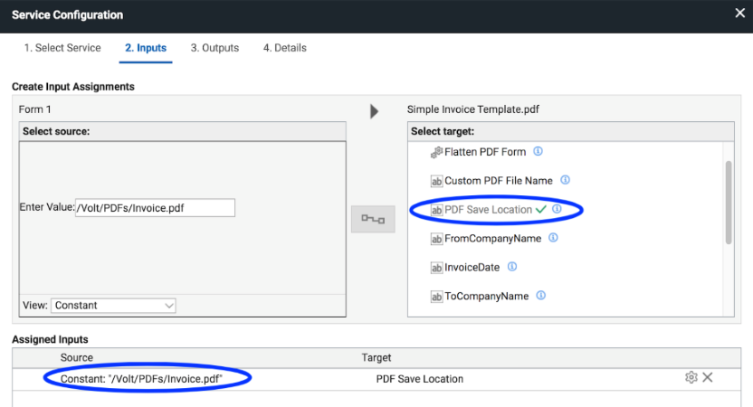

storageBaseDirWhiteList = /Volt/locationA , /Volt/locationBThe option for PDF Save Location appears in your PDF fill
service configuration if a location has been whitelisted as described above. You
need to map the location you want to save to the option in your service
configuration. This can be done as an input item from the form or a constant (shown
in the following graphic). The path must match exactly to what is whitelisted and
the location must include the file name and path.
