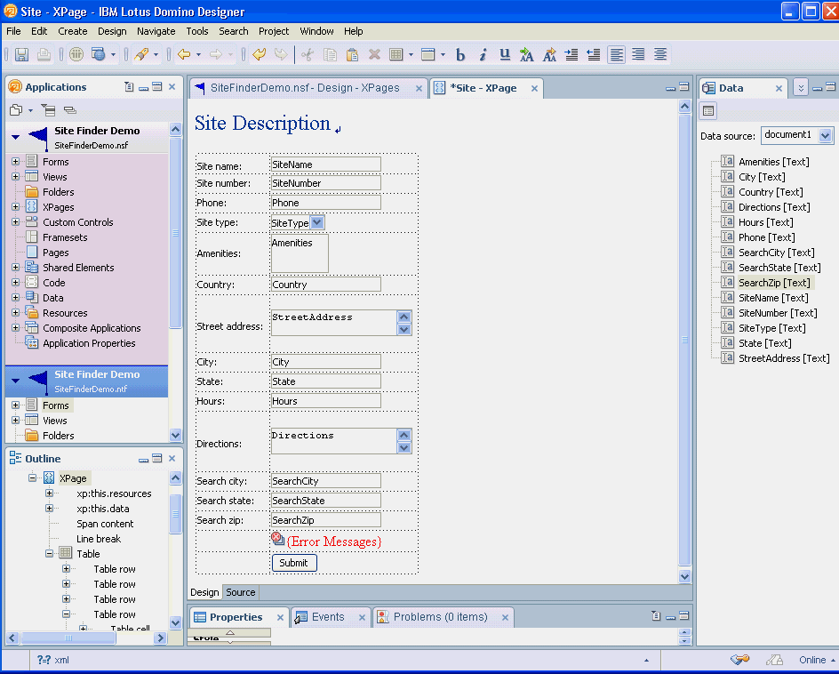

  7. Select and drag all fields from the data palette onto the XPage under the title.
    The Select Data Bound Controls dialog box opens.
  8. Fill in the dialog box as follows:
    1. Leave all checkboxes checked to say you want to include the fields.
    2. Leave all label text as is.
    3. Change the control type for Site type to Combo Box by selecting it and using the dropdown menu.
    4. Change the control type for Amenities to List Box
    5. Change the control type for Directions to Multiline Edit Box
    6. Check Add Submit button to generated code.
    7. Check Add messages control to generated code.
    The dialog box should like this.
  9. Click OK.
    This creates a two-column table with labels in the first column and controls in the second column. The second column also has an area to display validation errors and a Submit button.

    Your XPage should look like this.
    Site Description XPage
    At this point, your XPage should be similar to Site1 which you can open for comparison.
