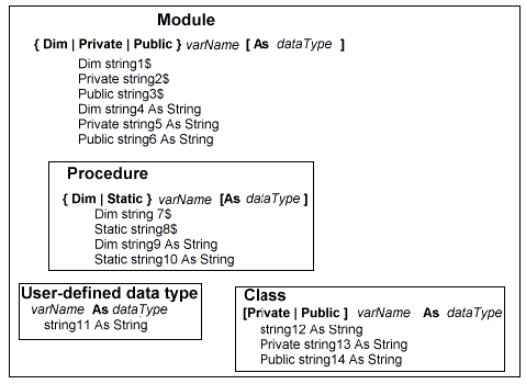

The following diagram summarizes the syntax for declaring a single scalar variable (in this example, a variable of type String):
The syntax elements in the declaration of a scalar variable are summarized in the following table:
| Element |
Description |
| Dim |
Declares a variable with Private scope. |
| Public, Private |
Public declares a variable with Public scope. Private declares a variable with Private scope. |
| Static |
Only applicable to variables declared inside a procedure. Static variables retain their values (rather than going out of existence) between calls to the procedure while the module in which the procedure is defined remains loaded. |
| varName |
The name of the variable. At module level or within a procedure, varName can end in any of the data type suffixes that LotusScript® recognizes. This determines the type of data that the variable can hold. You can append a data type suffix to a variable name when you declare it only if you do not include the As dataType clause in the declaration. |
| As dataType |
Specifies the type of data the variable can hold. If you include this clause, varName cannot end in a data type suffix character. This clause is required in the declaration of a variable within the definition of a user-defined data type or class, but optional in the declaration of a variable at module level or within a procedure. |

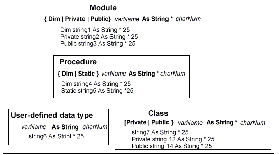

A String variable can be of variable or fixed length. The syntax for declaring a variable-length String variable is shown in the preceding diagram. The syntax for declaring a fixed-length String variable is shown as follows:
The charNum argument specifies that varName is a fixed-length String variable of charNum characters.
When you assign a string to a fixed-length String variable, LotusScript® truncates the string or pads it to the declared length with trailing spaces if necessary.
