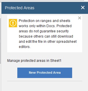

- Click . The Protected Areas panel
is displayed in the sidebar.
Note: To show the sidebar panel that contains comments, close the Protected Areas panel. - Click New Protected Area.

- If you want to modify or remove protected areas, hover
over an area in the panel and then click the Update
or Delete button
