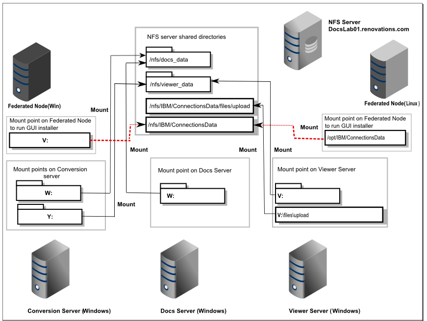

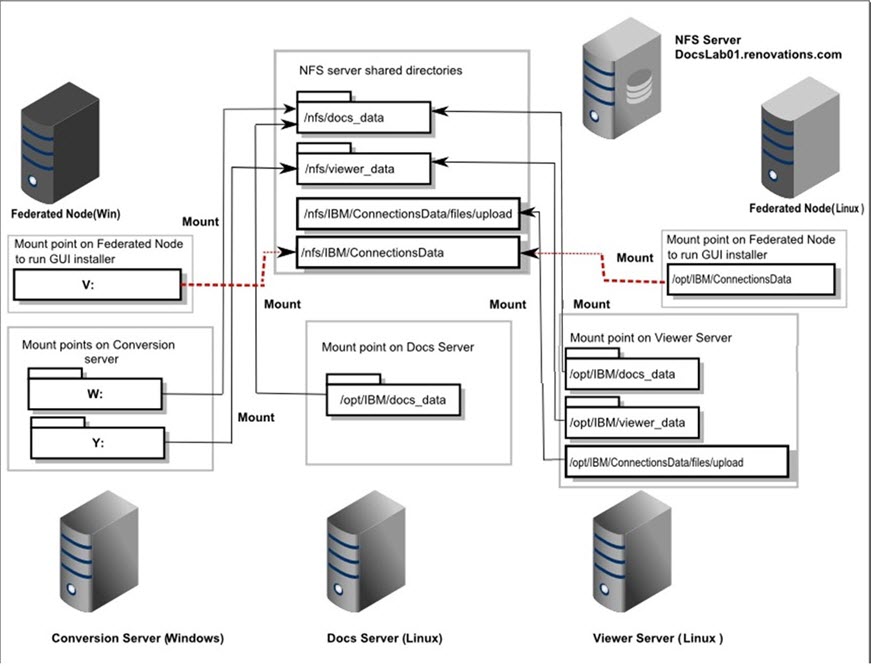

  • If a federated node is selected to run the GUI installer, and this node is different from Connections nodes, a client point must be mounted to Connections share point and this client point will be used to deploy Docs Extension or Viewer Extension. In the diagram, the client point is V: for Windows node or /opt/IBM/ConnectionsData for linux.
The following diagrams illustrate the HCL Docs specific shares and how they are mounted.
The diagrams and the server information worksheet later in this guide assume that you are using an NFS server running on one of your Connections or HCL Docs servers. If your File Viewer data will be shared via CIFS (SMB), follow the Windows™ documentation or your filer documentation for setting up a CIFS share.
  • On Linux:
    How shares specific to HCL Docs are mounted on Linux
  • On Windows:
    How shares specific to HCL Docs are mounted on Windows
