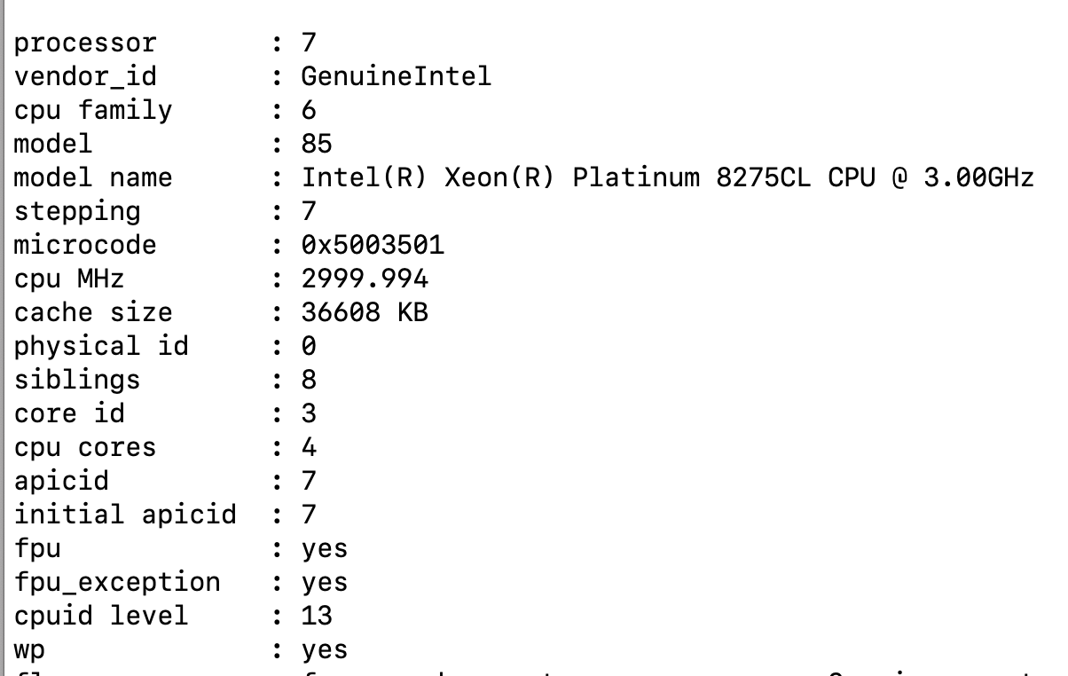

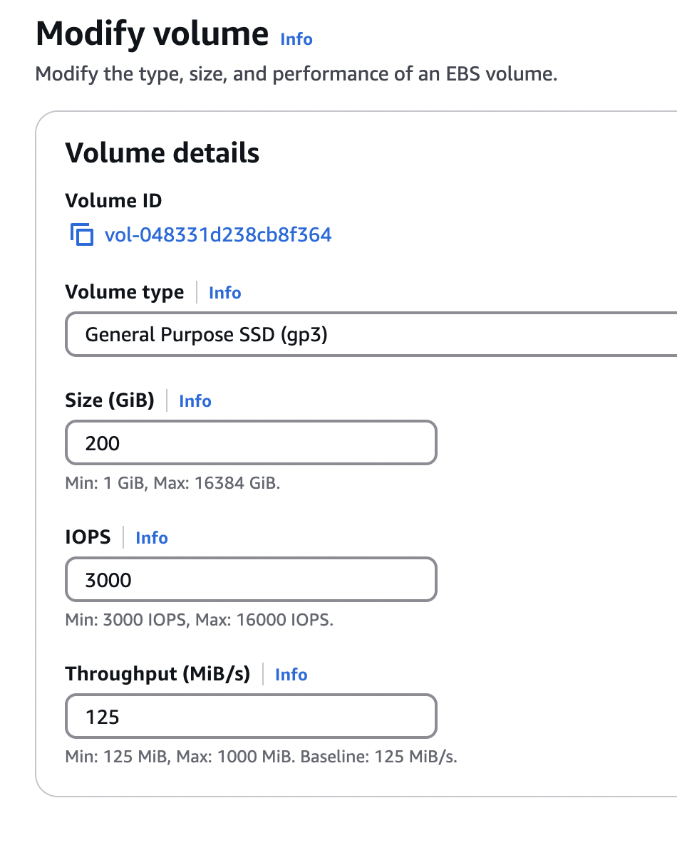

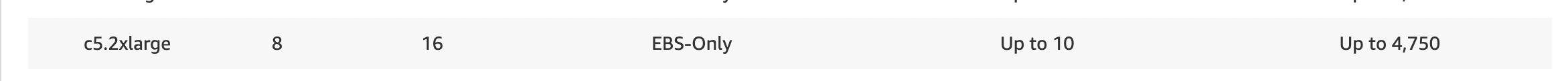

The Kubernetes platform was deployed on an Amazon EC2 instance with DX Compose images installed and configured. In the AWS/Native Kubernetes setup, the tests were conducted on three EC2 instances using a c5.2xlarge node. This instance type was used for the remote DB2 instance (core database) and the JMeter instance.
Refer to the following setup details:
c5.2xlarge
Node details
Processor details
Volume details
Note
Ramp-up time is 0.4 seconds per user. The test duration includes the ramp-up time plus one hour at the peak load of concurrent users.
