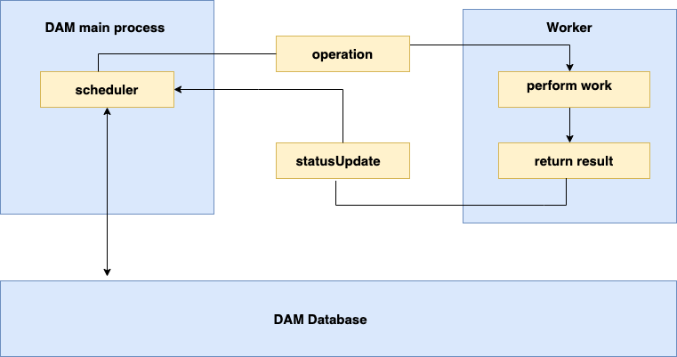

One integral part of HCL DX Digital Asset Management is the so-called "operations framework". This tooling allows DAM to run asynchronous background processes.
The operations framework consists of four key components:
- For storing
operationswe leverage ourDAM database. On top of it sits aschedulerwhich always looks foroperationsthat need to be handled and will assign those toworkers. Thoseworkersreceive theoperationto be handled from the scheduler and will return their results after being done.
Glossary
Operation
A specific task that needs to be performed. Will be stored in the DAM database and handled by the scheduler.
Worker
A forked task will be created by the DAM main process. This worker will receive the operation from the DAM main process and carry out the work necessary. After the work is done, it will report back to the master. It can only handle one operation at a time. A worker has a metadata value called lastTouched which is used to determine how long a worker is in its current state.
StatusUpdate
Will be sent by the workers to the DAM scheduler to inform about the result of handling an operation.
Scheduler
The scheduler is the controlling mechanism of the framework of the operations. It takes care of creating workers, feeding them with operations to work on and, ensuring expired operations and expired workers are being cleaned up.
Scheduler heartbeat
The scheduler heartbeat defines the intervals in which the scheduler will try to claim operations for workers. This can be configured.
