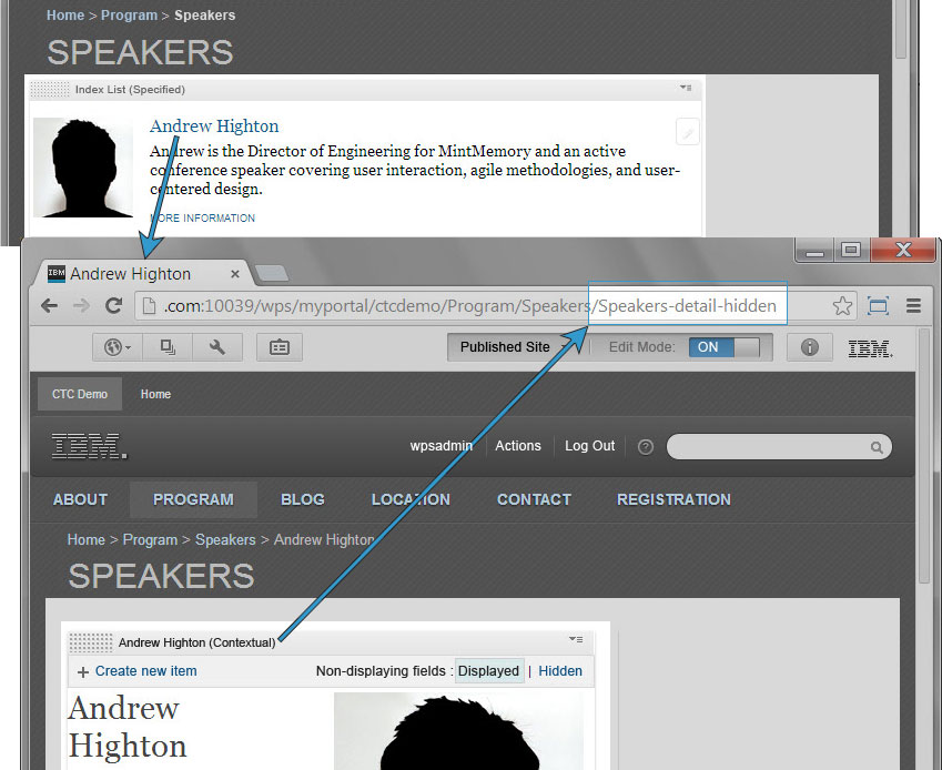

You are responsible for managing the biographies of speakers at a conference. In the past, you created a new portal page for each speaker. With hundreds of speakers now attending this conference, you need to simplify how you manage the biographies and reduce the effort required in maintaining this area of your site. You do not want to create a page for each speaker.
Audience for content:
This content applies to anyone that is attending the conference or is considering attending the conference.
Configuration details:
In this example, you have a page listing summaries for 300 biographies. For more information about a speaker, you want a visitor to click on the biography summary to view the full biography. Rather than managing 301 pages (1 page with your summary list of biographies plus 300 pages of biographies), you only have to manage 2 pages (1 page with your summary list of biographies and 1 details page that provides a view to your web content). Contextual content allows you to use the content associations on the page to only display the biography information for the speaker that is clicked by your visitor on the biography list page.
