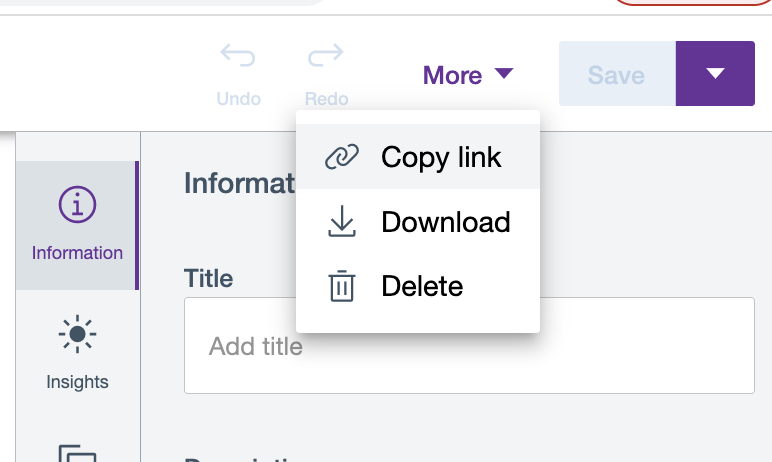

In contrast, a binaryUrl you get from Copy link on the Edit page, consists of a string of characters representing the collection_id, item_id, and rendition_id.

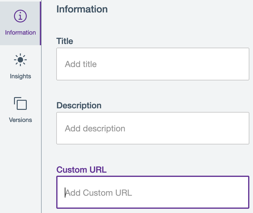

Meanwhile, a customUrl provides the original rendition of an asset. The customUrl is not related to a friendly URL.
Sample customUrl:
https://sample-url.com/dx/api/dam/custom/car

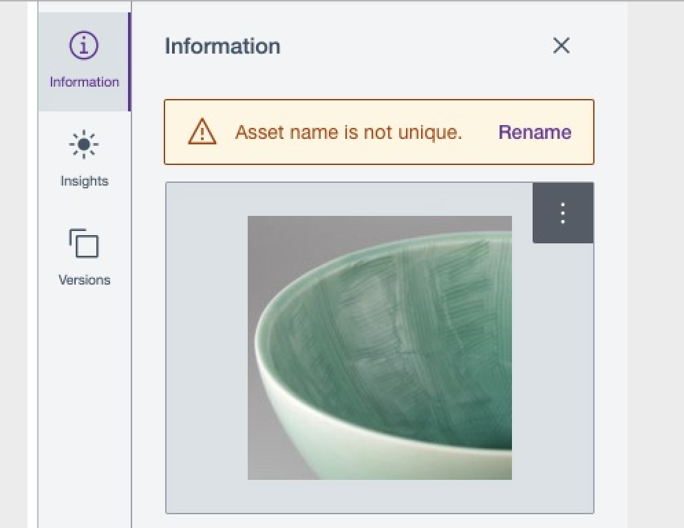

How to change duplicate asset names using DAM

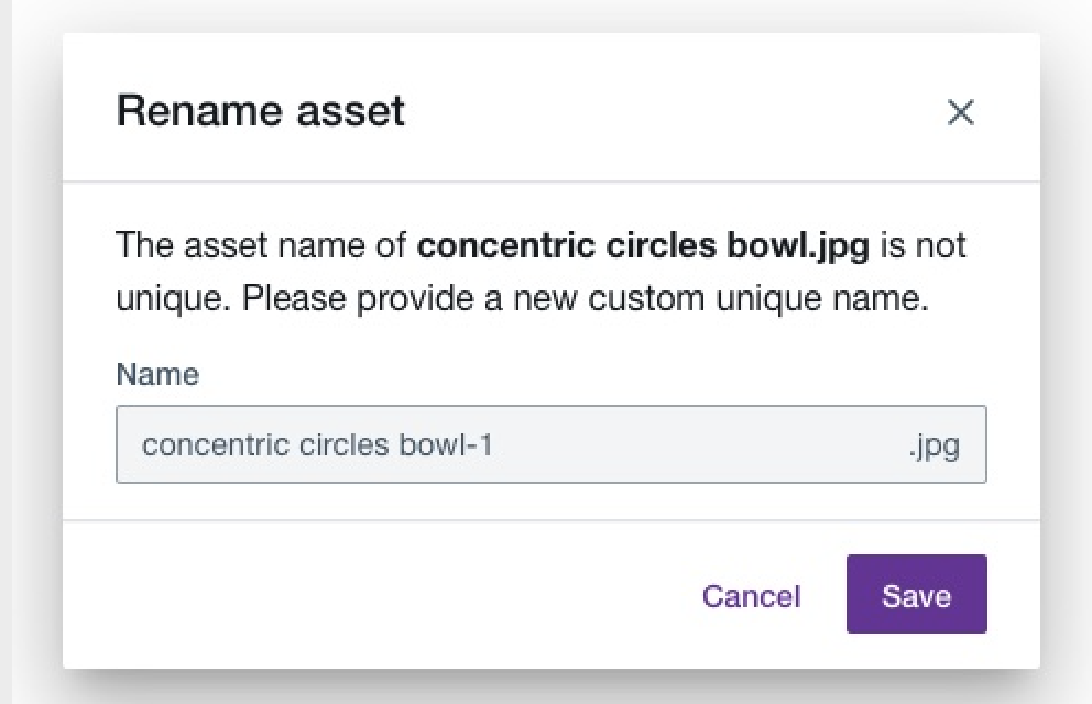

If an asset happens to have the same name with another asset in a collection, a notification is displayed in the Information panel.
You can click Rename from the notification and provide a unique name.

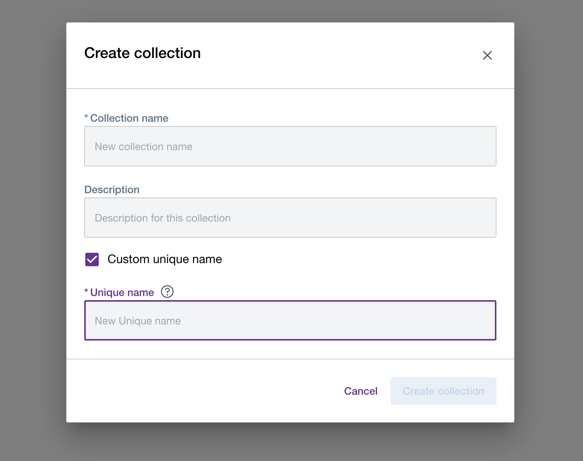

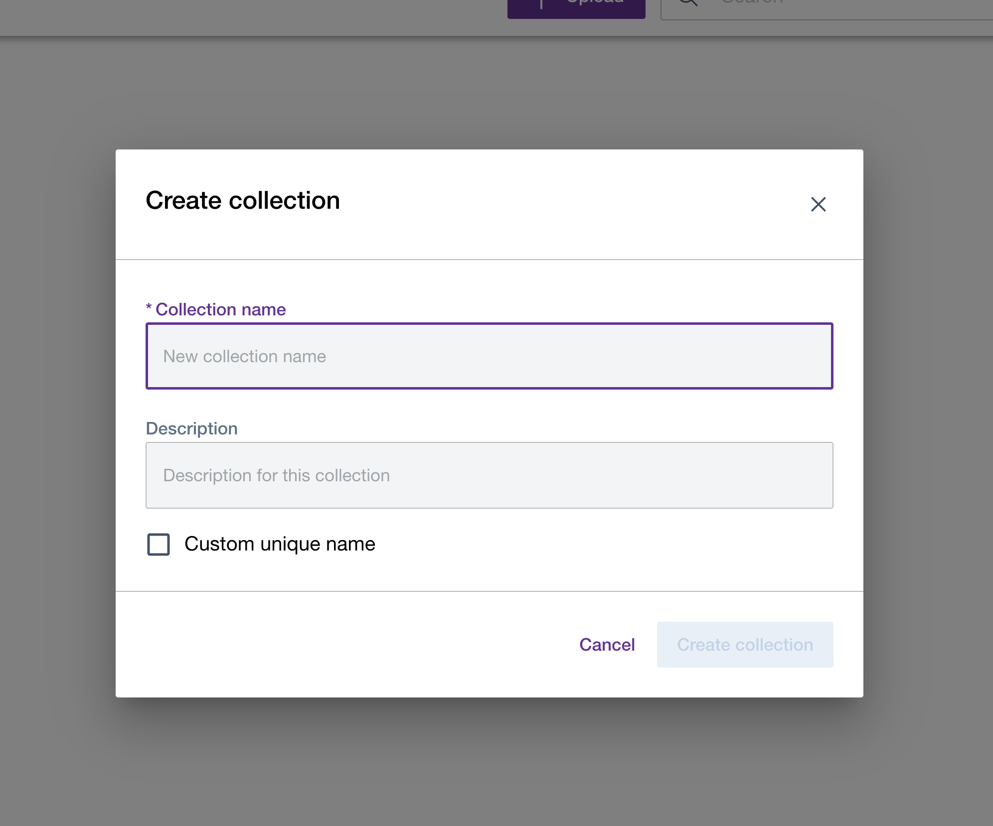

What is collection unique-name?

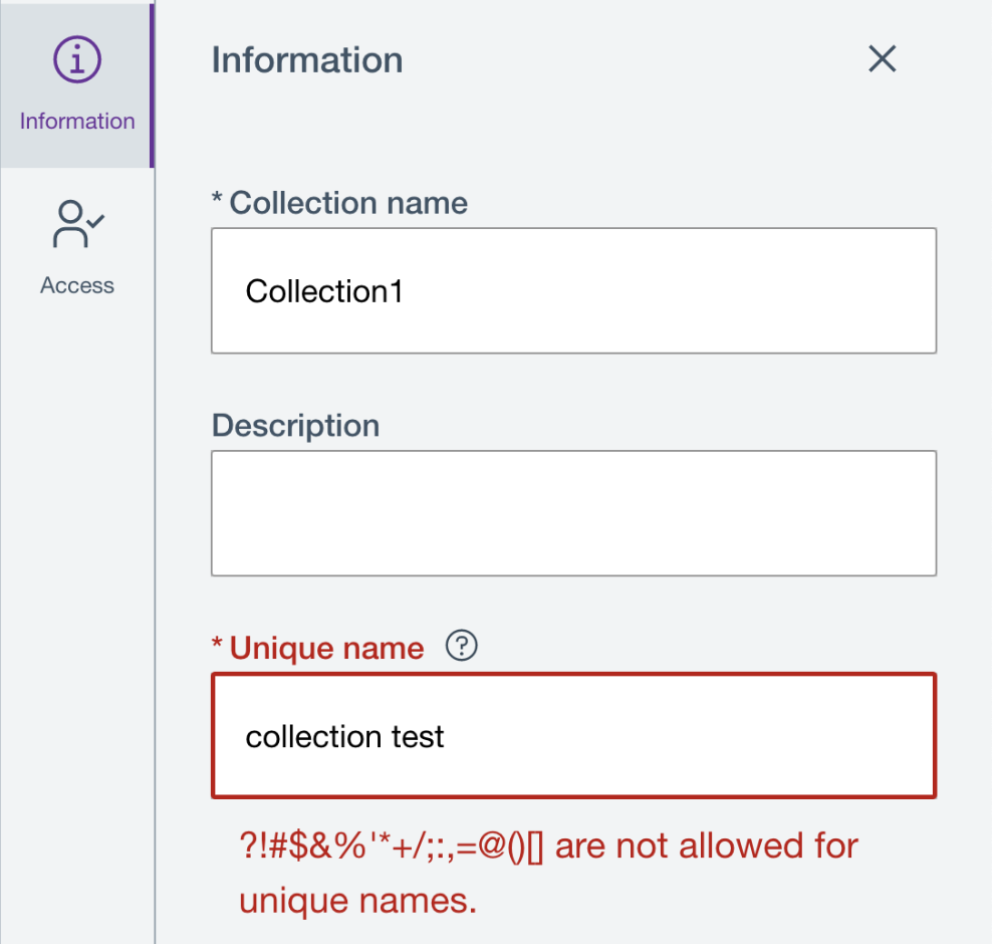

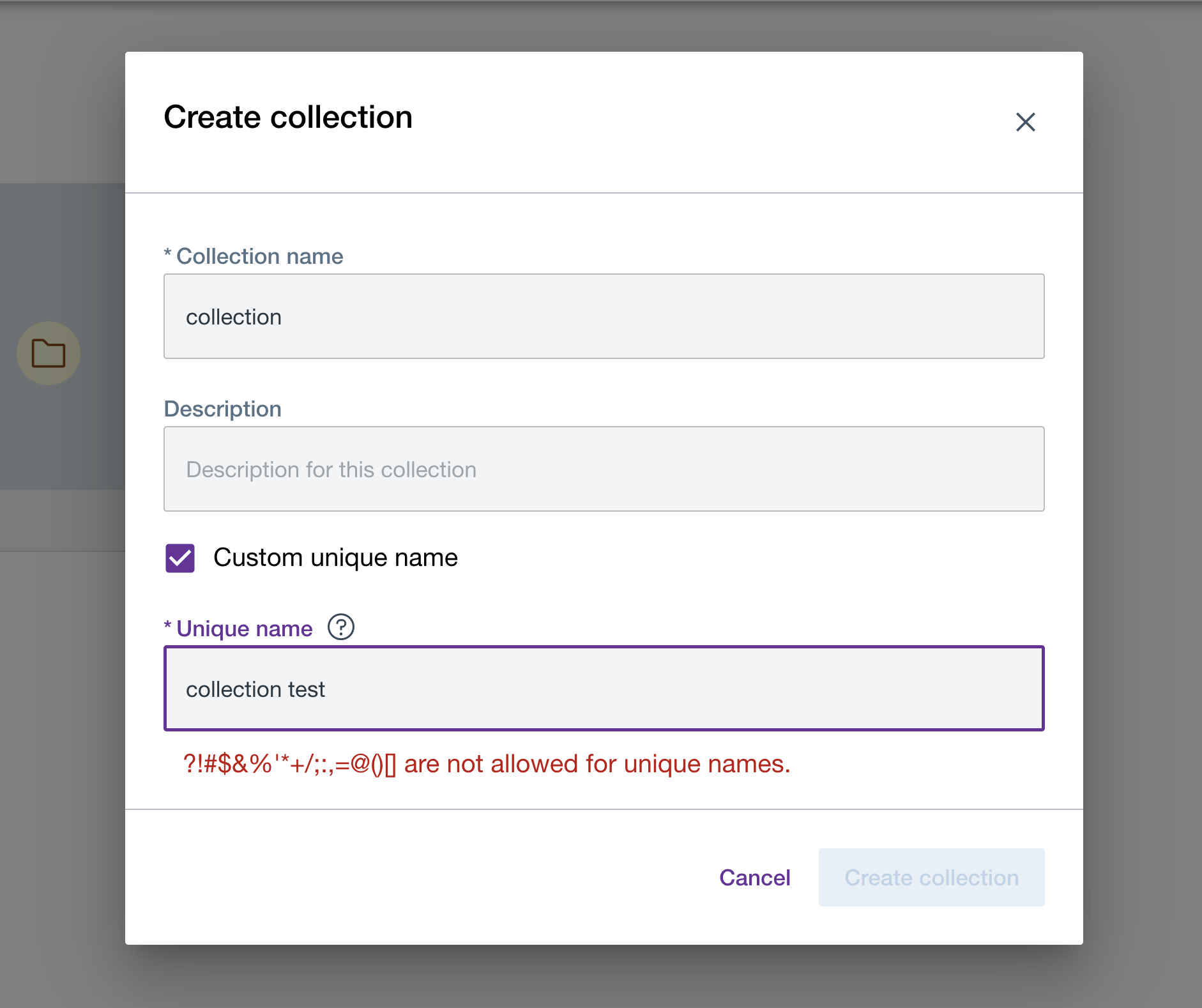

Collection unique-names are the unique identifier for each collection which can be used in friendly url instead of collection UUID to access DAM assets. Collection unique-names supports all languages as per existing system. Collection unique-name does not support any URL reserved characters(e.g. "?!#$&%'*+/;:,=@()[]").
How collection unique-names are generated?
- While creating a collection, the user has a provision to enter a custom collection unique-name.
- Collection unique-name is an optional field. If it is not provided by the user, the system will generate a collection unique-name based on the collection name replacing all the URL reserved characters (e.g. "?!#$&%'*+/;:,=@()[]") with underscores.
- Collection unique-names will follow simple format of adding “_Number” for collections having same collection-names.
- For existing collections, the system will generate a collection unique-name based on the collection name by using the migration script.

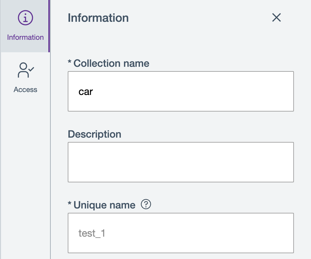

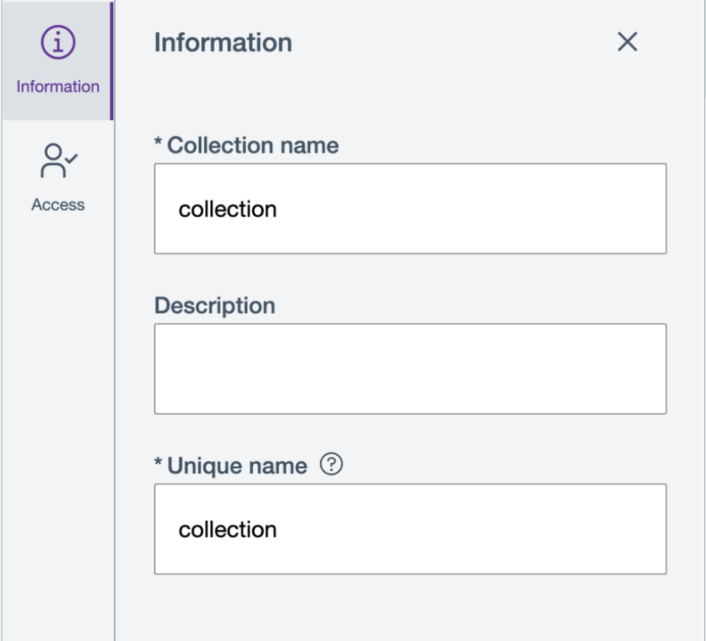

How can the user change the collection unique-names?
Once the collection unique-name is generated, user will be able to view/edit the collection unique-name in the collection information panel.

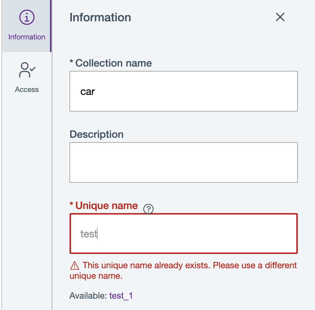

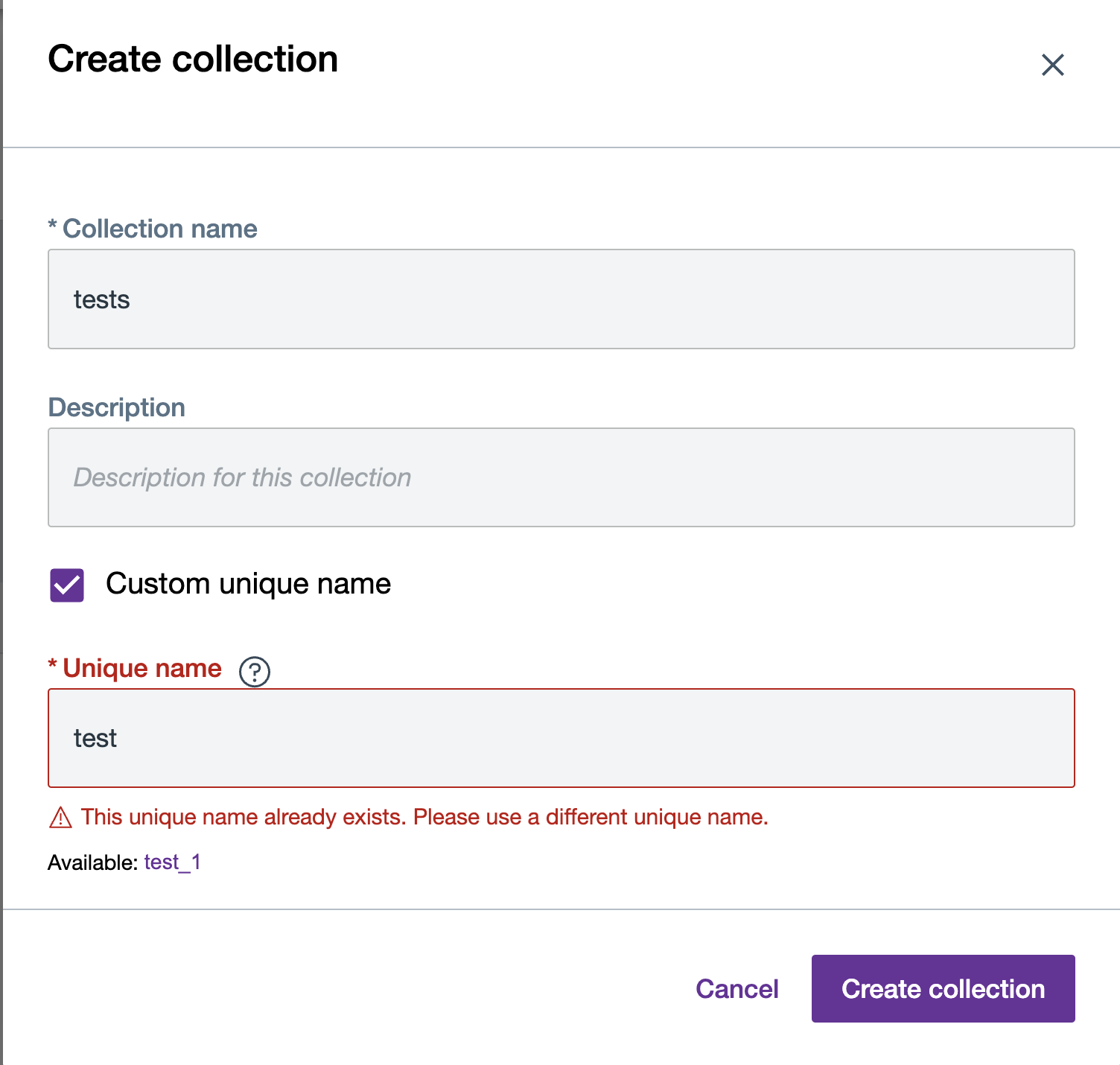

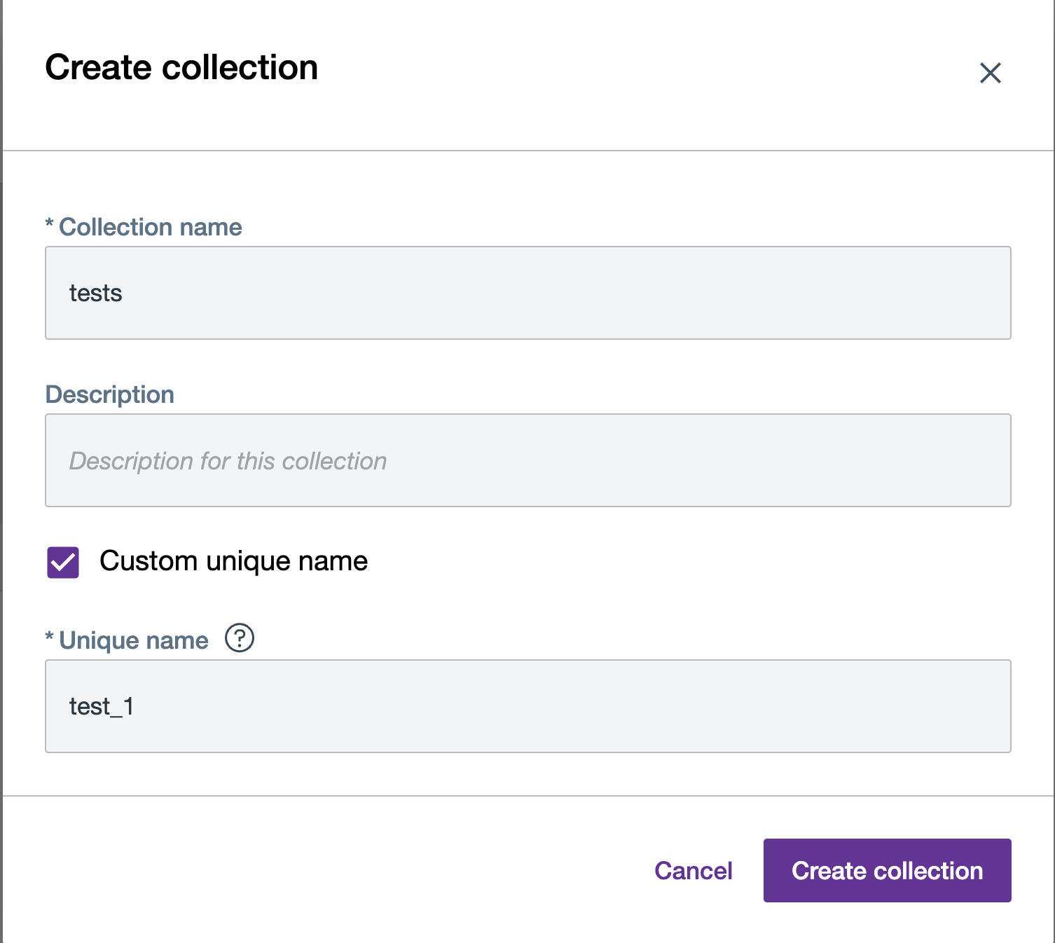

What happens if collection unique-name already exists while creating or editing a collection?
While creating or editing a collection, DAM checks for any duplication of the unique-name and prompt with an error message and also suggests available unique-name if a duplicate is found in any other collection.
- when the user clicks on the suggested name, unique-name input field get prefilled with the suggested unique-name.

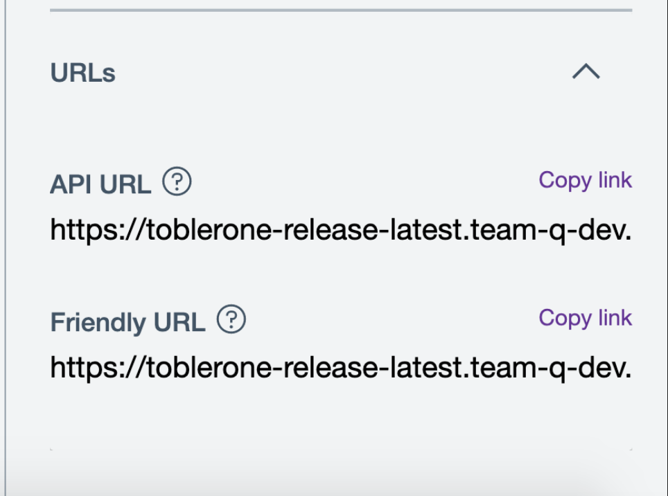

Copying friendly URLs for assets
Users can copy the friendly URL and API URL of an asset from the URLs section of the asset's inspector panel
