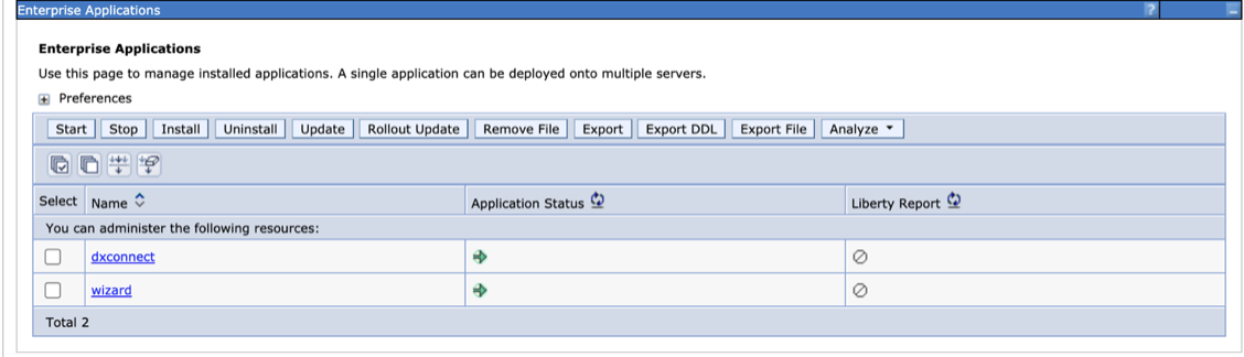

To verify if DXConnect is installed on a given HCL DX Server 9.5 with CF19 or later, navigate to the Configuration Wizard Admin console and then under Enterprise Applications. The dxconnect application appears on the console as shown in the example below. For more information on accessing and working with the Configuration Wizard, refer to Accessing the Configuration Wizard topics.
DXConnect installation
