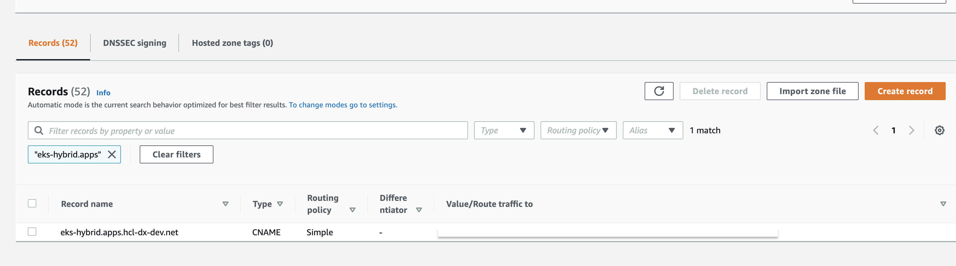

After a successful Helm deployment in a hybrid deployment, you can add a load balancer or an external IP to the DNS registry.
  • Run the following command to get a load balancer external IP:
    kubectl get services -n <your-namespace>
  • For Amazon EKS, you must add the external IP to route53.
    Sample configuration for Amazon EKS

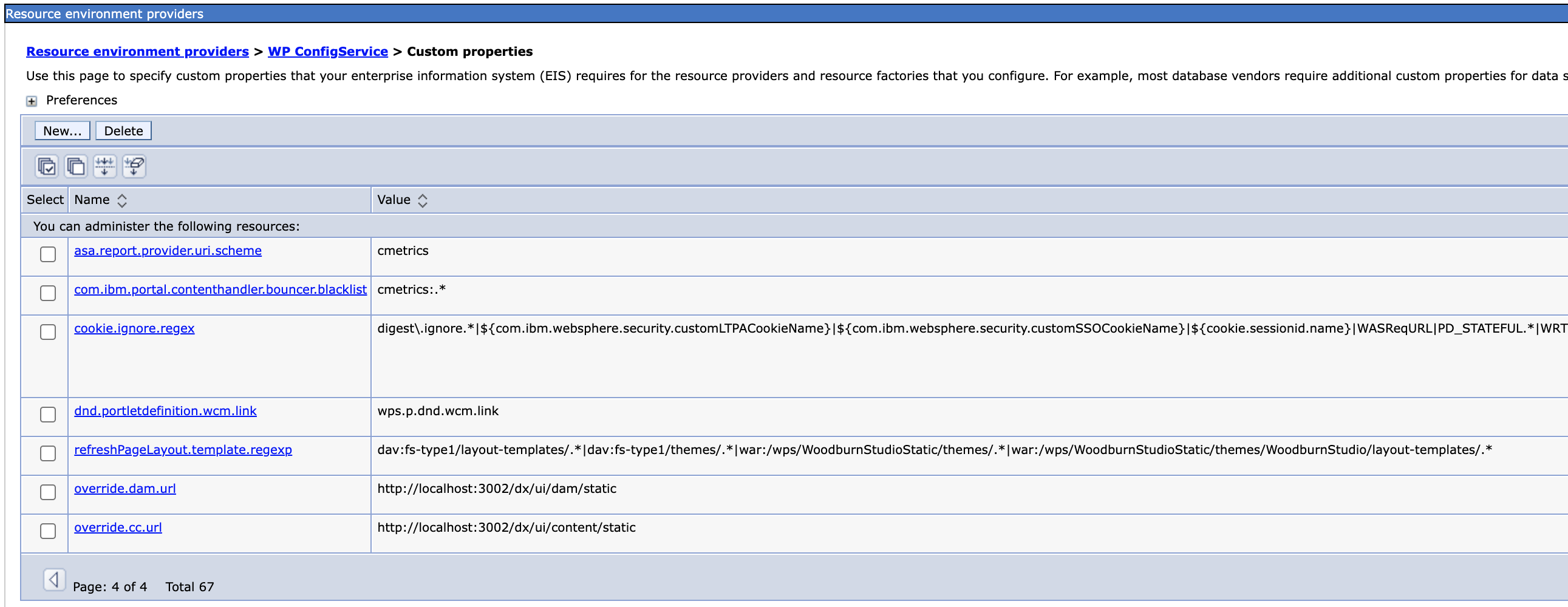

To override the static user interface URL being set in React Integration Portlet, do it in the DX WebSphere Application Server user interface. In the WAS Server, go to Resources and select Resources Environment Providers. In Resources Environment Providers, select WP_ConfigService and go to Custom properties to add new variables as provided below:
  • For Content Composer:
override.cc.url
  • For DAM:
override.dam.url
Sample values below WAS override variables
