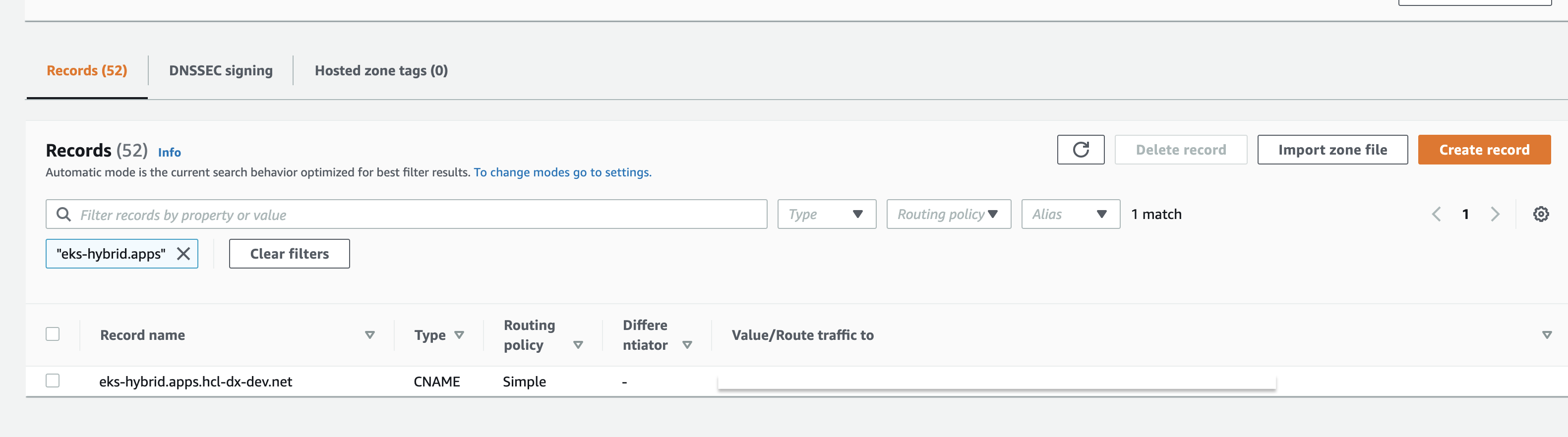

  • For Amazon EKS, you must add the external IP to route53.
    Sample configuration for Amazon EKS
