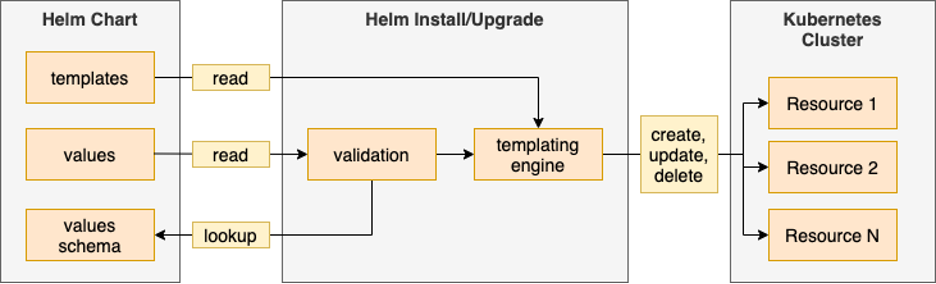

Helm deployment flow
As outlined in the flow chart, when performing an install (or upgrade), the Helm Chart reads the values.yaml (and any overridden values, either provided through Helm CLI parameters or additional values files) and perform a schema validation check. After the schema check is successfully performed, Helm runs the templating engine to create the Kubernetes resource definitions out of the templates inside the Helm Charts.
As a last step, Helm accesses the Kubernetes or OpenShift Cluster and create the resulting Kubernetes resources in the desired namespace.

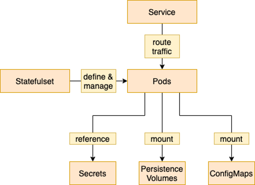

Stateful applications - Definition
DX 9.5 container applications are managed by a StatefulSet, which controls the creation and life cycle of all pods it is responsible for. These Pods use Persistent Volumes for storing their application data, ConfigMaps to adjust application configuration, and Secrets to obtain access credentials.
In front of all Pods is a Service which manages routing the traffic to the Pods. This Service is also called by HAProxy to fulfill incoming requests from outside the Kubernetes or OpenShift cluster.

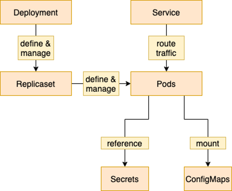

Stateless applications - Services Management
HAProxy and routing
For accessing applications from the outside, we deploy a reverse proxy in the form of an HAProxy. This reverse proxy routes the incoming requests to all application Services, which then distributes the requests to the corresponding Pods hosting the applications.
HAProxy uses its configuration to decide which request needs to be mapped to which application in the DX 9.5 deployment (back-end). When requests are initiated from outside the Kubernetes or OpenShift cluster, HAProxy tries to fulfill those requests by using the configured routing. If it finds a matching endpoint, it forwards the request to the corresponding service, which then forwards the same requests to a Pod that is ready to fulfill the request.
