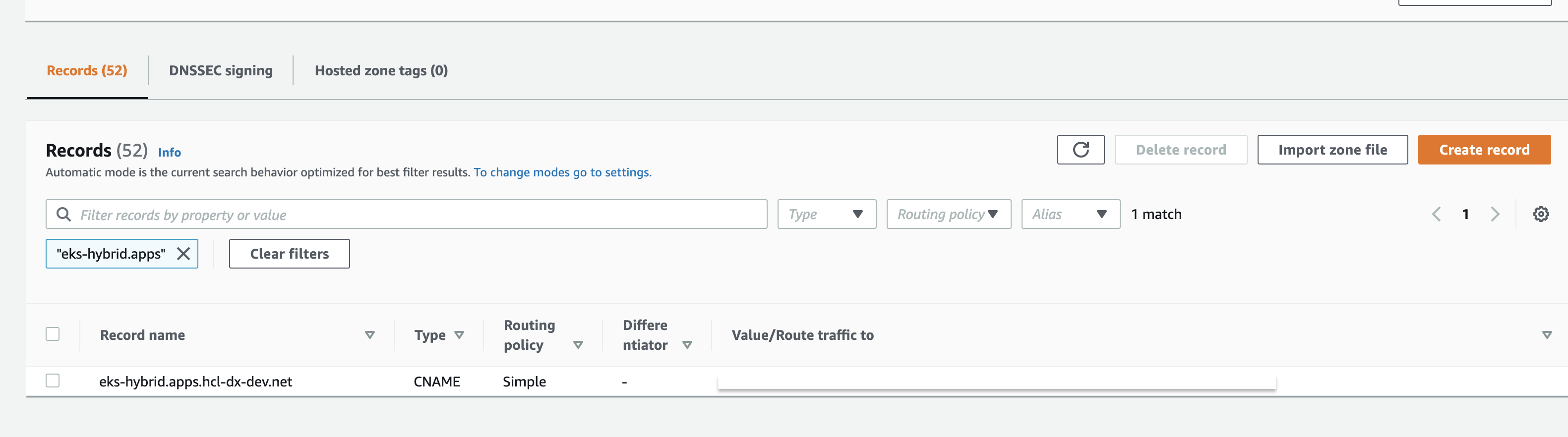

(Optional) External DNS configuration
After a successful Helm deployment in a hybrid deployment, you can add a load balancer or an external IP to the DNS registry.
  • Run the following command to get a load balancer external IP:
    kubectl get services -n <your-namespace>
  • For Amazon EKS, you must add the external IP to route53.
    Sample configuration for Amazon EKS
