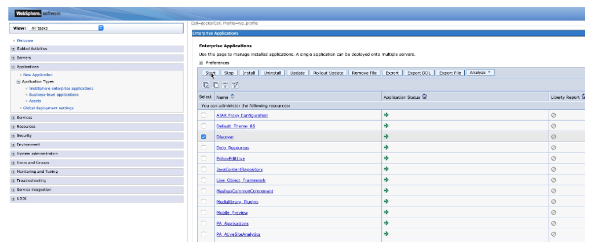

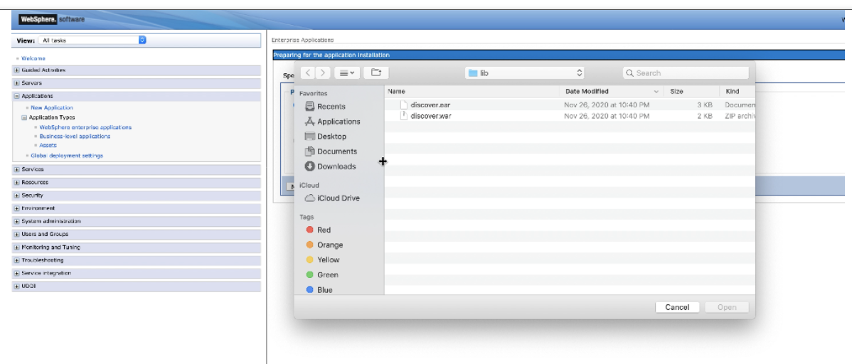

  1. From an HCL Digital Experience 9.5 Container Update CF192 and later, get the Discover.ear file from the PortalServer/doc/discover folder and install it using the HCL Digital Experience WebSphere Application Server console. The Unica Discover.ear file contains the application that installs the DiscoverUIPost.JSP file required by Unica Discover for the proxy architecture.
  2. After getting the Discover.ear file, upload the file and install it using the WebSphere Application Server console:
    1. Navigate to the WebSphere Application Server console.
    2. Navigate to Applications > Application Types > WebSphere Enterprise Applications.
    3. Click install, and select and open the Discover.ear file. Follow the prompts to complete the installation.
      Select and start the Discover module from the administration panel
  3. When completed, select the Discover module and start it from the WebSphere Application Server console.
    Upload the HCL DX Discover.ear file and install using WebSphere Enterprise Applications

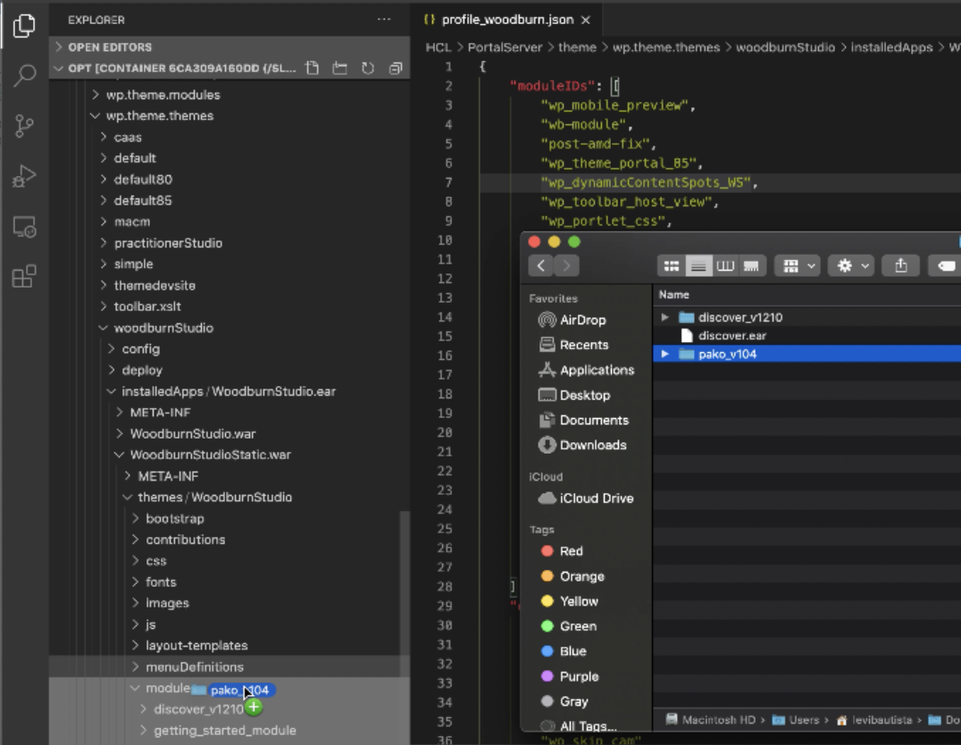

  1. Copy the discover and pako simple modules from PortalServer_root/doc/Discover folder to the theme modules.
    For WebDAV-based themes:
    Mycontenthandler/dav/fs-type1/theme/{custom-theme]/modules
    Example:
    Copy the Discover integration modules to the DX theme modules
    For WAR-based themes:
    Include it in the WAR file. Restart the server after installation.

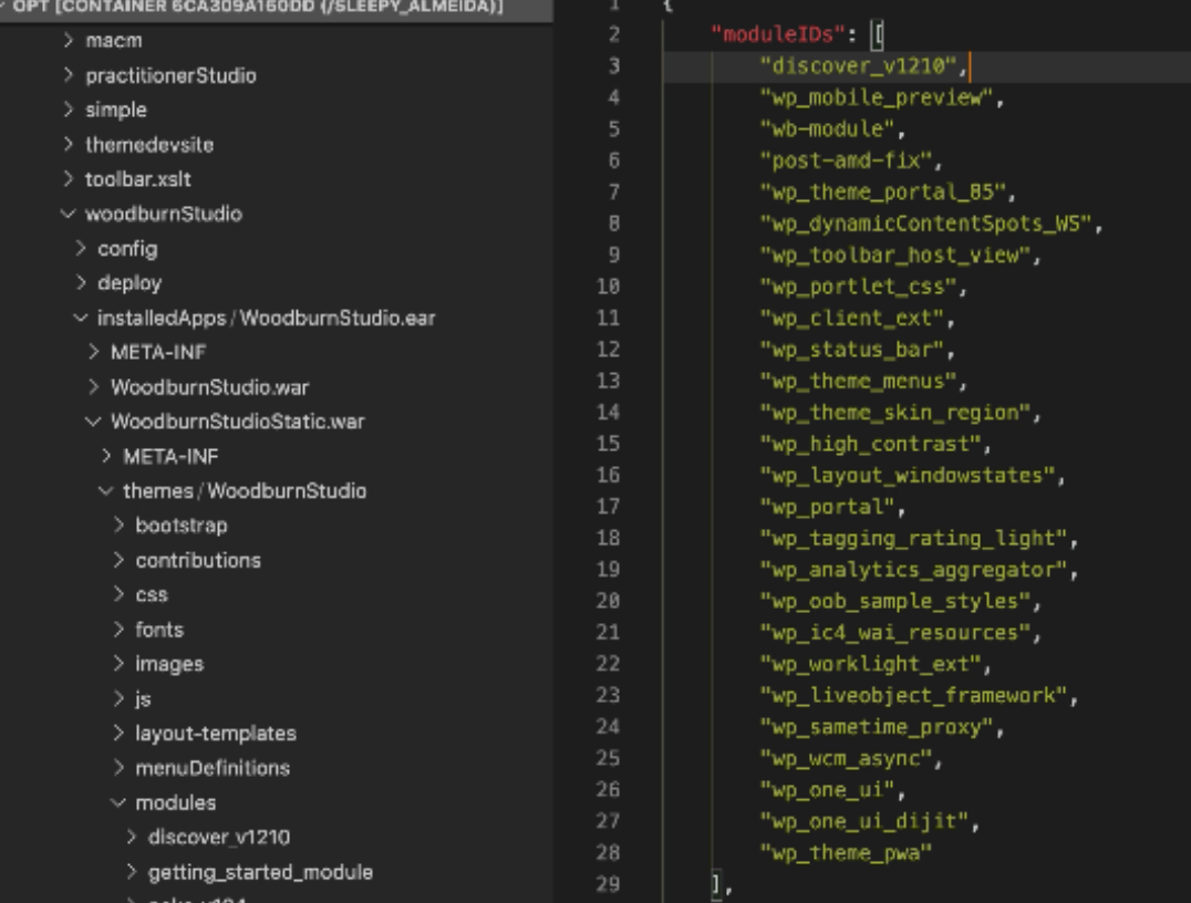

  2. After copying the folder with the JS files, update the Theme profile JSON file as follows:
    Add the Unica Discover_[versionnumber] in modulesIDs. It should be the first item. You can find the Unica Discover release version number by finding the Discover_v.xx module in the PortalServer/doc/Discover folder.
    • Tip: Open the Discover.js file and search for “getLibraryVersion”.
    Add the Unica Discover version number to the DX Theme profile

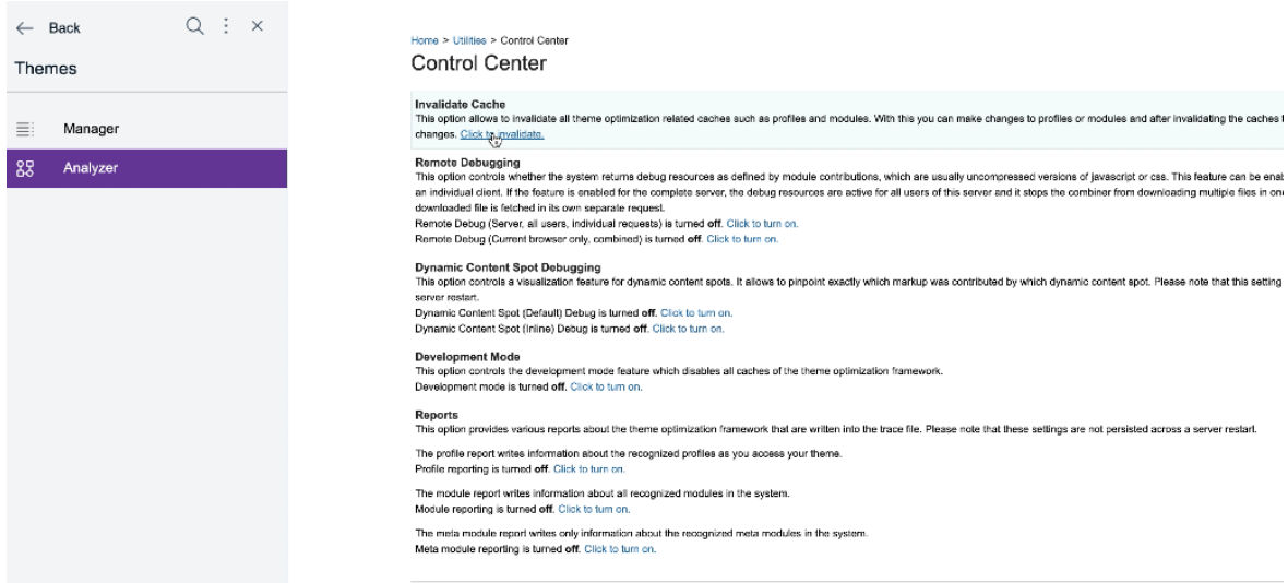

  3. After adding the HCL Unica Discover version number ID to the profile JSON file, proceed to invalidate the theme cache.
    Go to the Practitioner Studio menu and navigate to Theme > Analyzer > Utilities > Control Center page in Practitioner Studio as shown below. Select the Click to invalidate link under Invalidate Cache.
    Invalidate the Theme Cache using Practitioner Studio

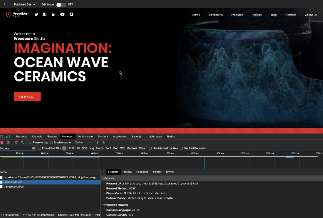

Verify the integration between the HCL Unica Discover and HCL Digital Experience Theme by using the Network Tab Tools from your browser.
  1. After you execute the Invalidate Cache step outlined in the previous section, proceed to turn on Remote Debugging. Refer to the previous figure example for the Remote Debugging command interface.
  2. Go to the HCL Digital Experience Theme and open a Google Chrome browser Network tab.
    Example:
    Open a browser Network tab to view activity
    Any event or DOM changes made sends a network request to the DiscoverUIPost.jsp (if using proxy) or the configured endpoint in the Discover.js. This means the HCL DX Discover module is installed successfully and is sending data to the configured endpoint.

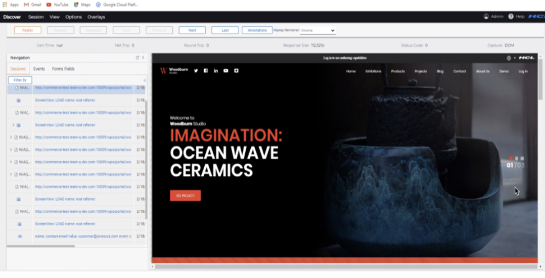

See the HCL Unica Discover Help Center for information on Unica Discover services, including session replay to assess the effectiveness of your DX site pages with end user audiences.
Example:
Review Digital Experience session replay from Unica Discover
