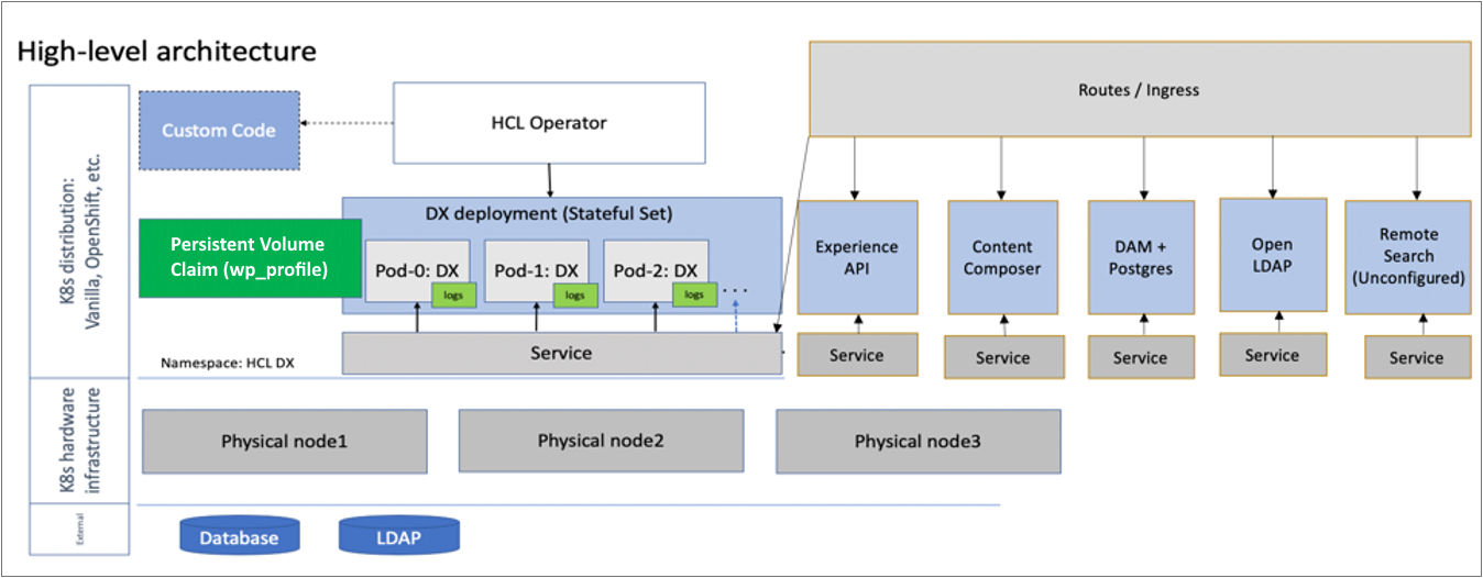

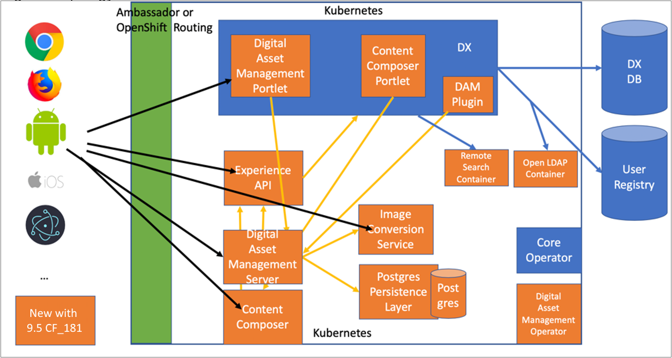

This section provides a high-level overview of the architecture and the steps to install, configure, and update the HCL Digital Experience 9.5 components: Experience API, Content Composer, and Digital Asset Management.
High-level architecture and topology
