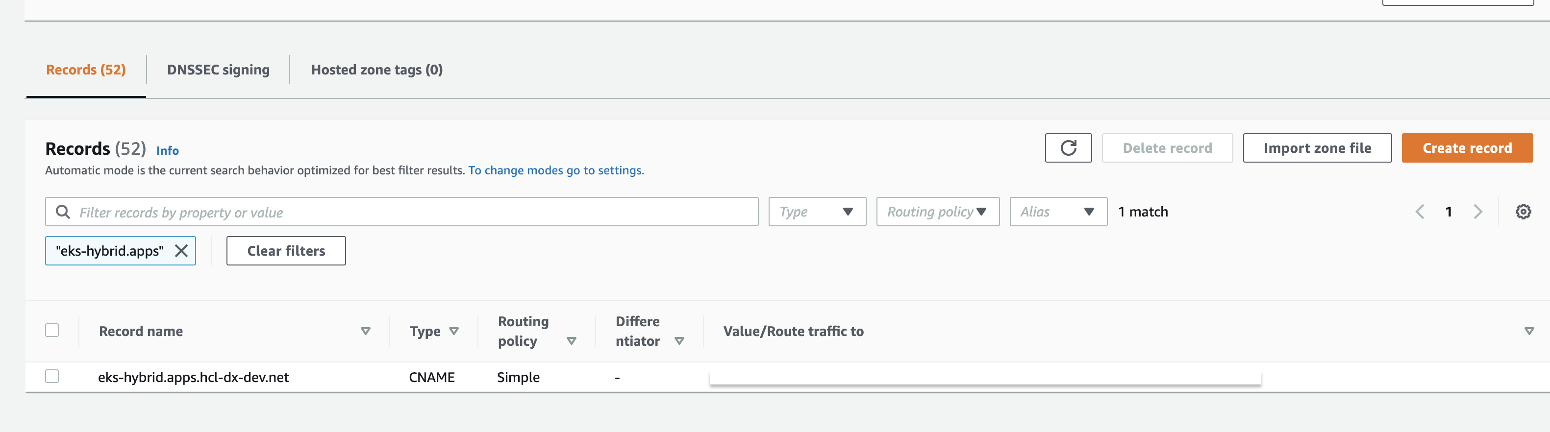

(Optional) External DNS configuration
After a successful Helm deployment in a hybrid deployment, you can add a load balancer or an external IP to the DNS registry.
Run the following command to get a load balancer external IP:
kubectl get services -n <your-namespace> -
For Amazon EKS, you must add the external IP to route53.
