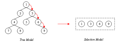

A list model representing a selection in a tree. This model describes all elements
of a tree model that are elements of the selection path. The selection path consists
of elements from the tree model where there is exactly one element of the tree model
for each level in that tree between the start and the end of the selection path. "Level"
is the number of elements needed to reach an element of that level counted from the root.
The selected node, if any exists, is always the last element of the selection path. The
following figure depicts the relationship between a selection model and the associated
tree model:
Only elements obtained from the selection model or its associated model are valid input parameters to the model methods.
