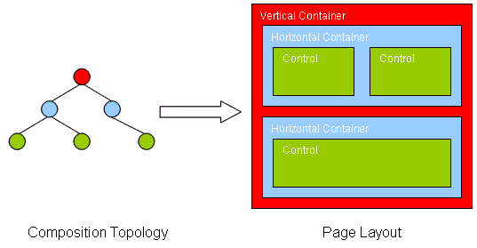

Here is an example of how page layout information and page content is represented. The following figure depicts a page with three portlets. The surrounding vertical and horizontal containers define the layout while the controls hold the portlets that provide the actual content presented to the user:
On the right-hand side of the figure the resulting topology is shown that can be queried from the layout model belonging to this page. If this model would be rendered, this would be the result of the page information (navigation information, surrounding page output is left out of this figure):
