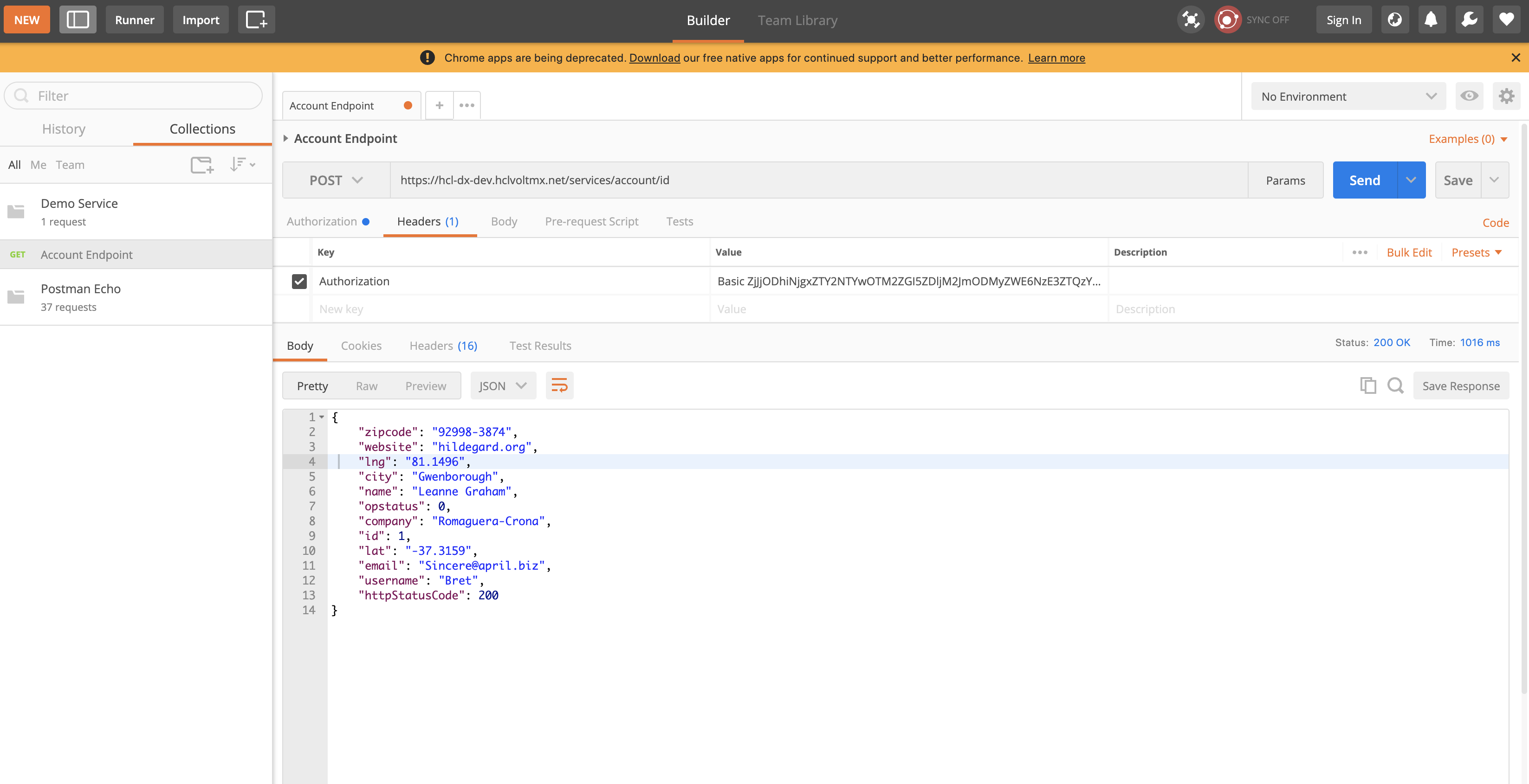

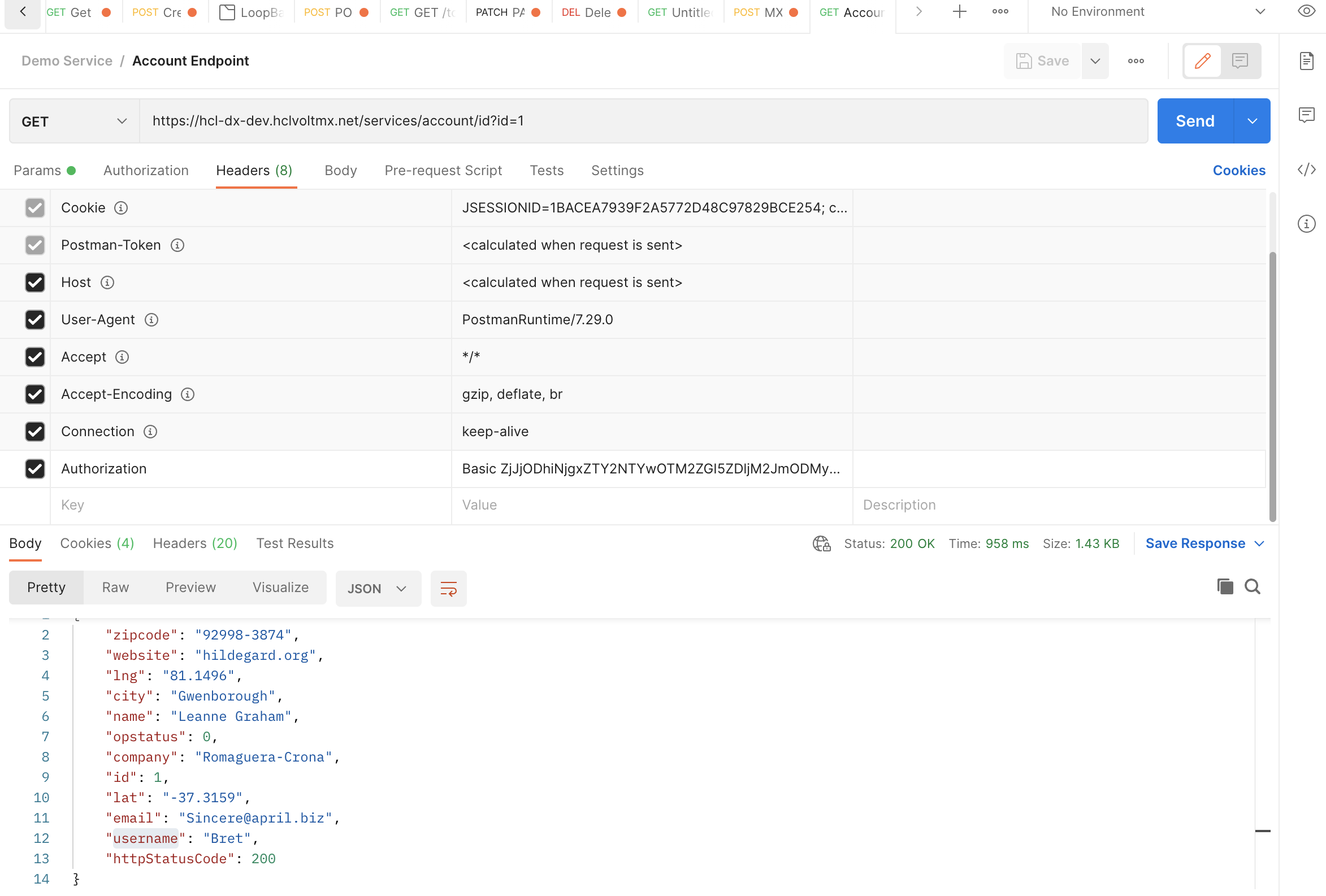

The following API end point and response are used to create this sample document:
  • Sample API end point for GET
  • Sample API end point for POST

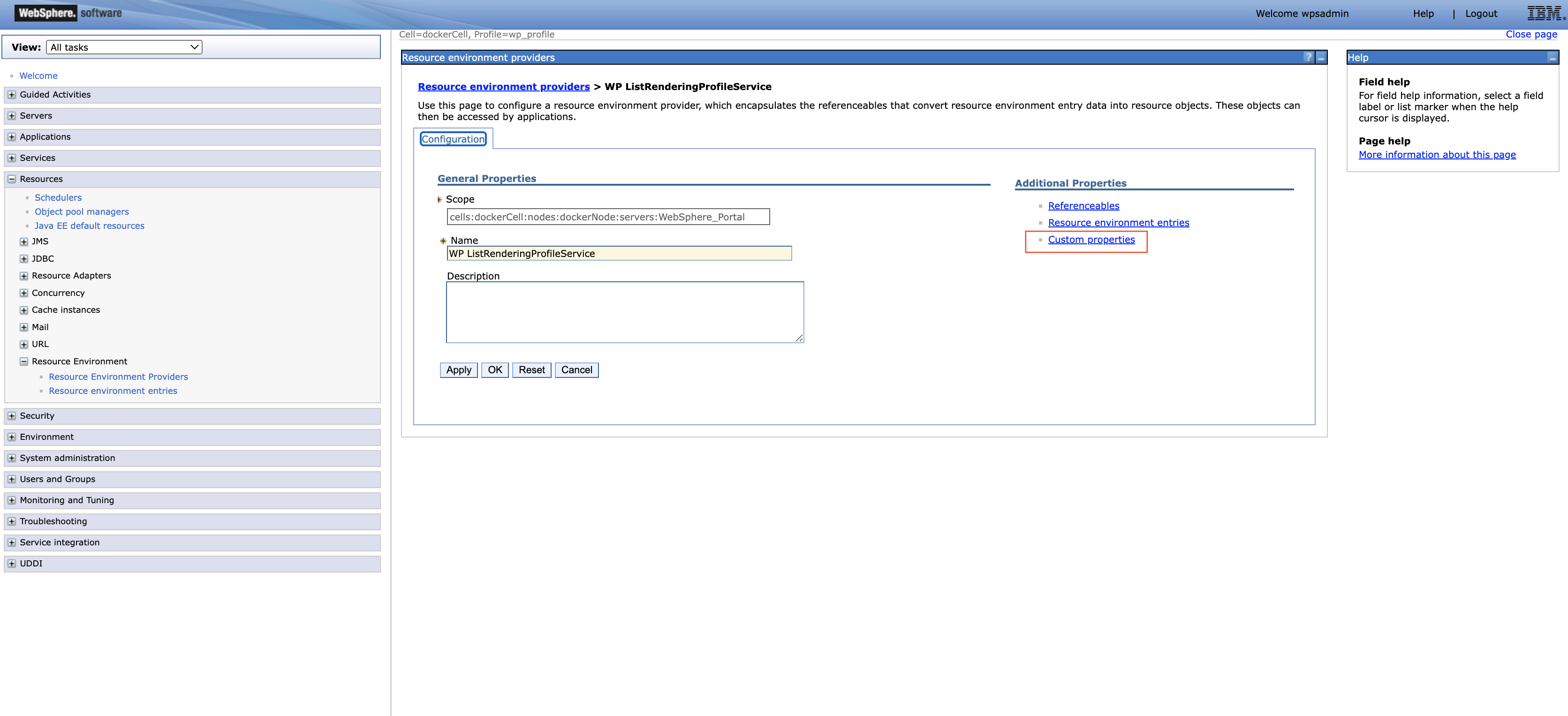

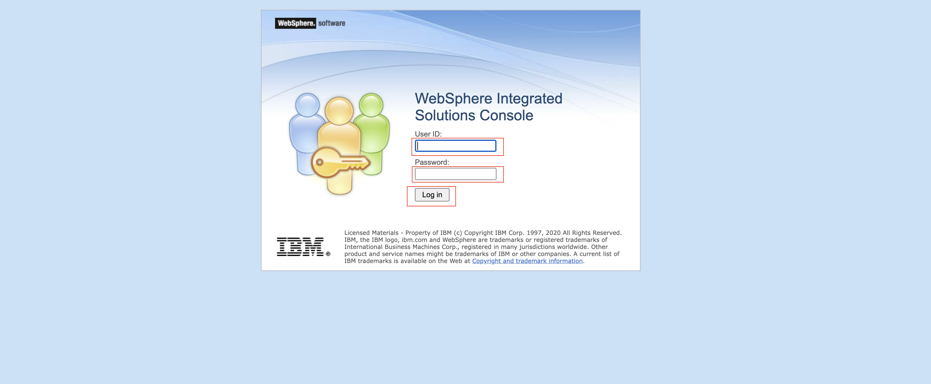

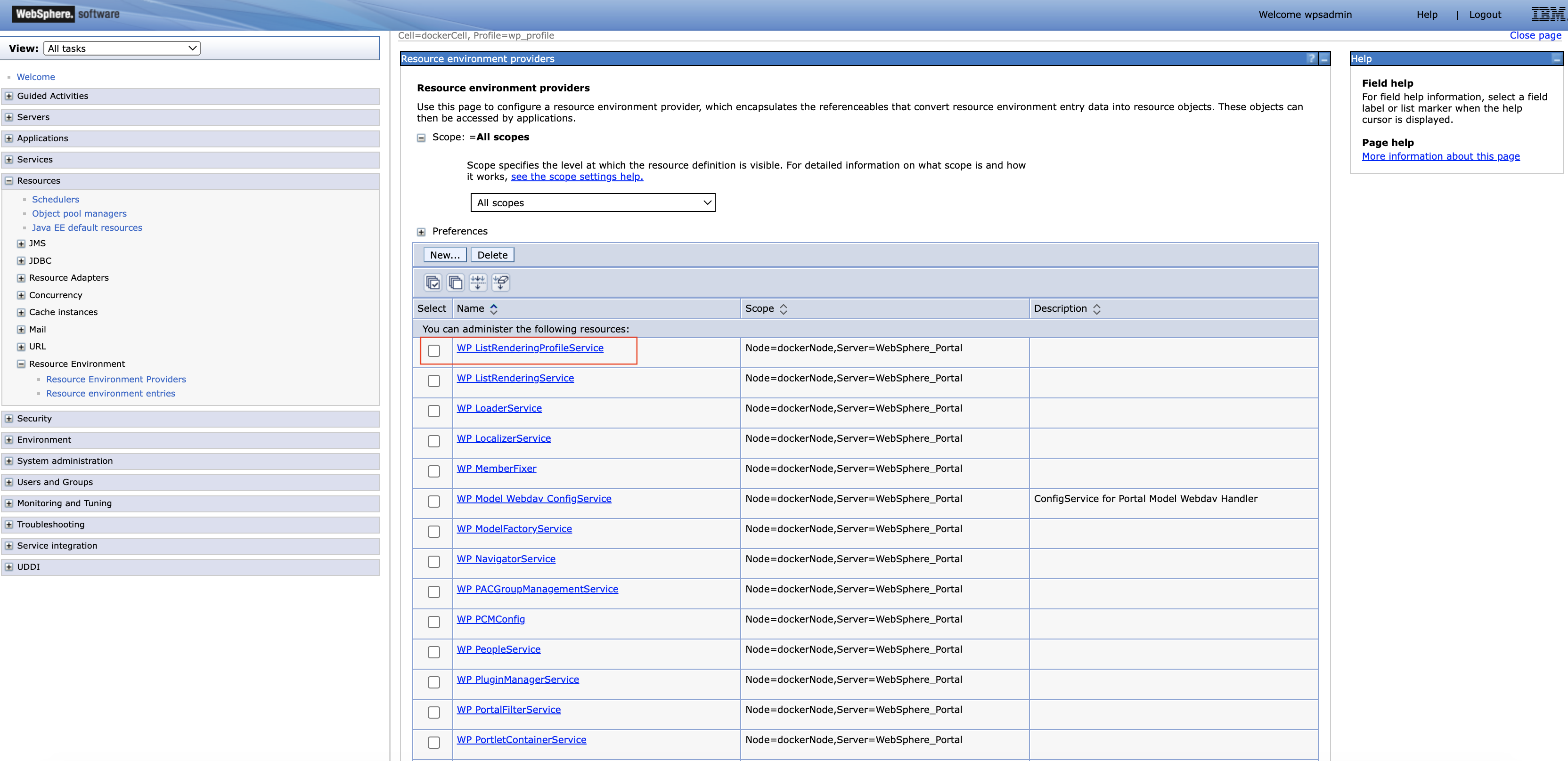

  1. Log in to the WAS console.

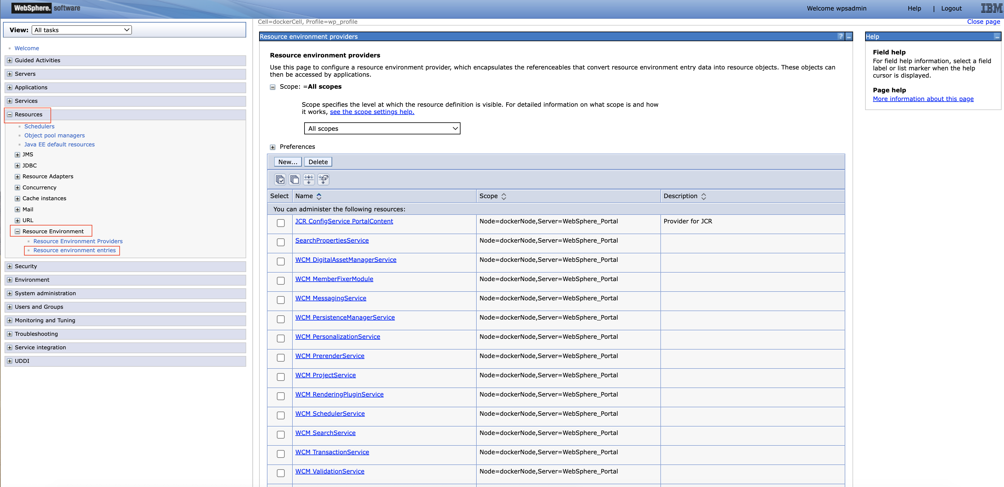

  2. Click Resources from side navigation. Then, click Resource Environment, then Resource environment providers.
  3. From the list of resources, find WP ListRenderingProfileService and click.

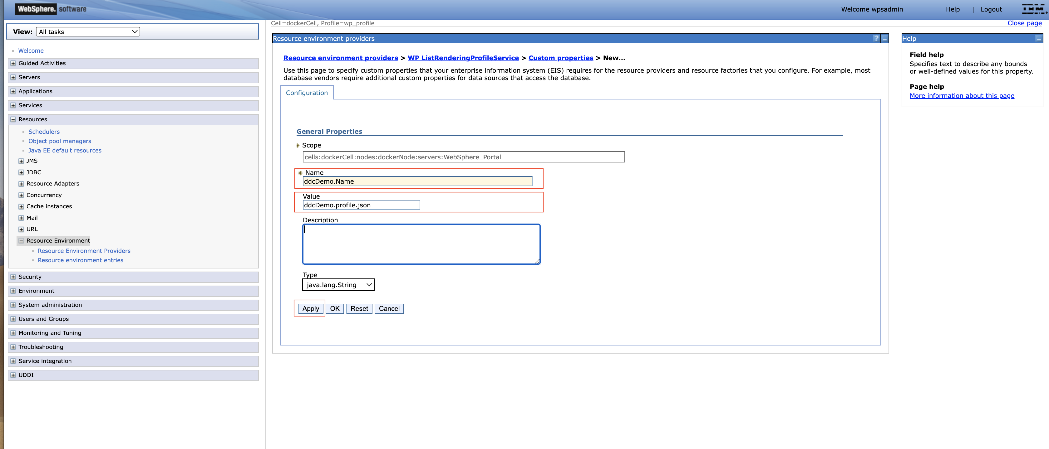

  4. Click Custom properties From the Additional Properties on right side.
  5. Click on New and add your unique profile (e.g. ddcDemo) and its properties by entering name-value pairs like in the sample below. Click Apply then OK

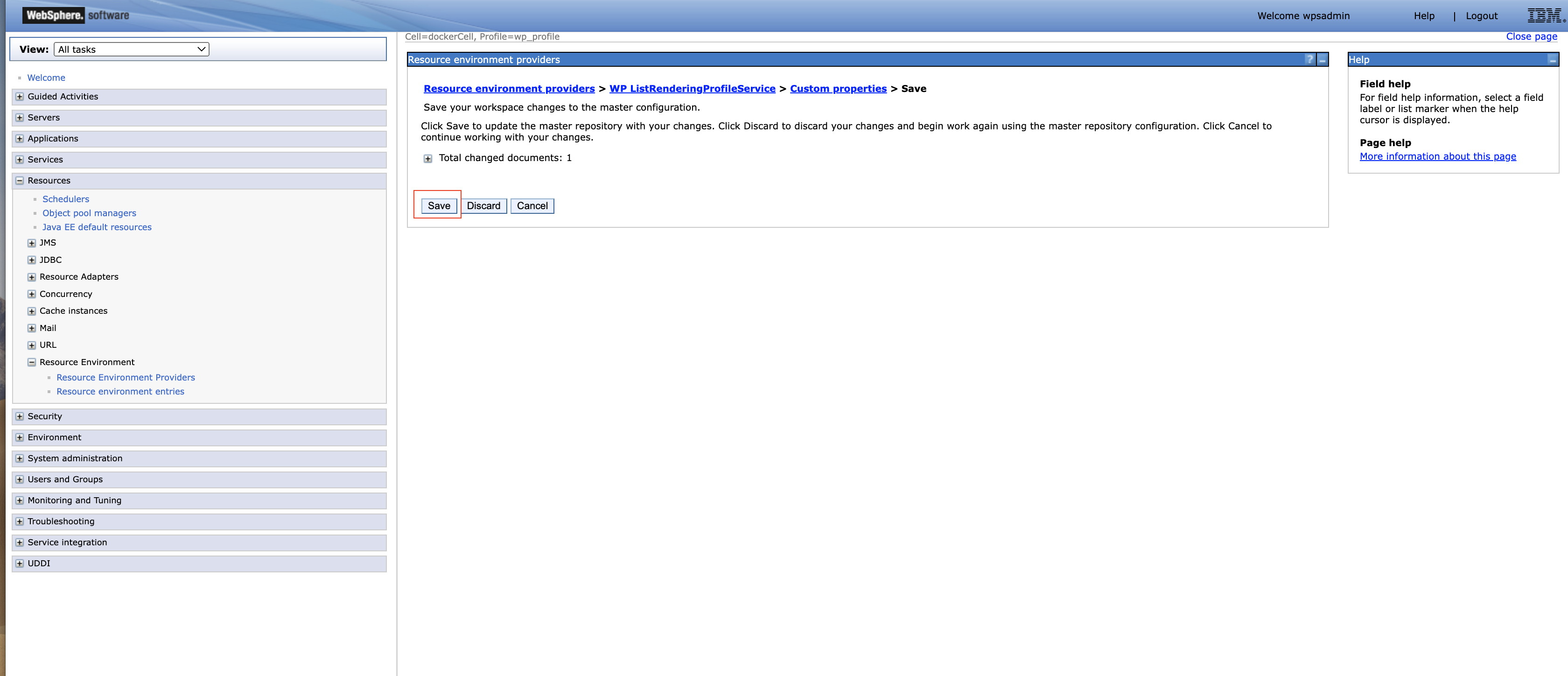

  6. Review and save the changes in the master configuration.
  7. Restart WAS server.

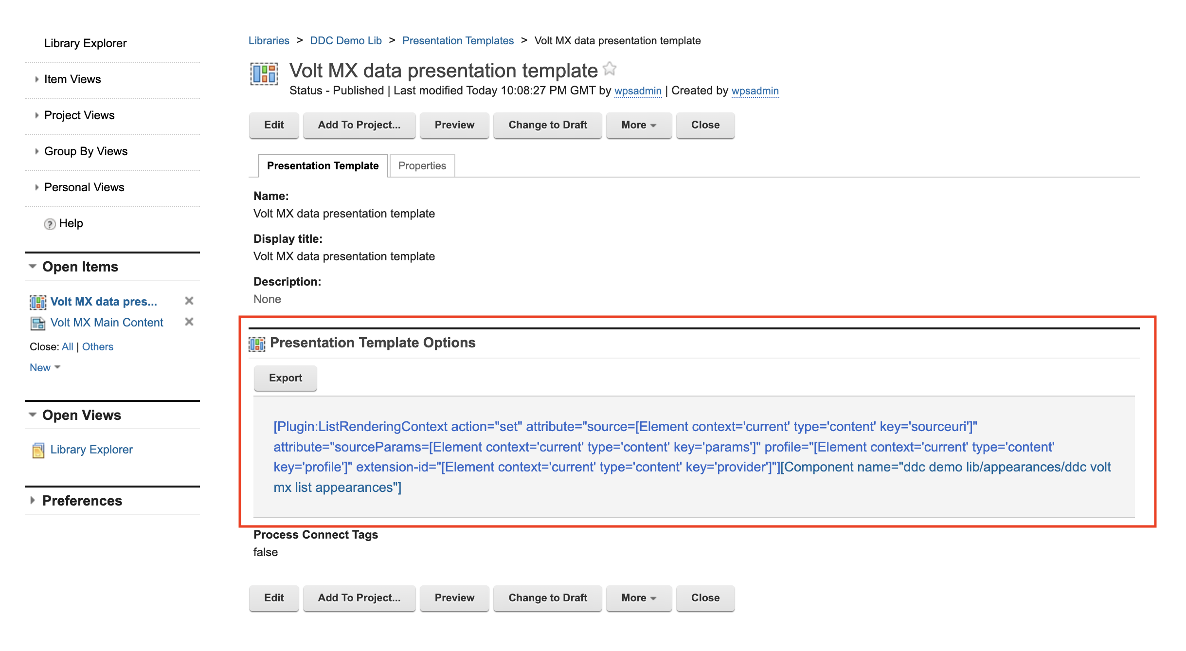

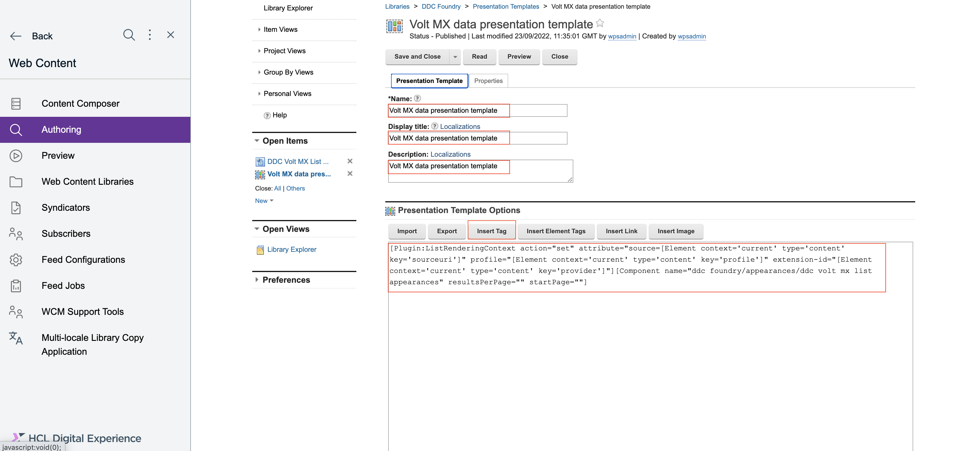

Creating a Presentation Template
Set the context of the DDC content.
Steps to create Presentation Template are as follows:

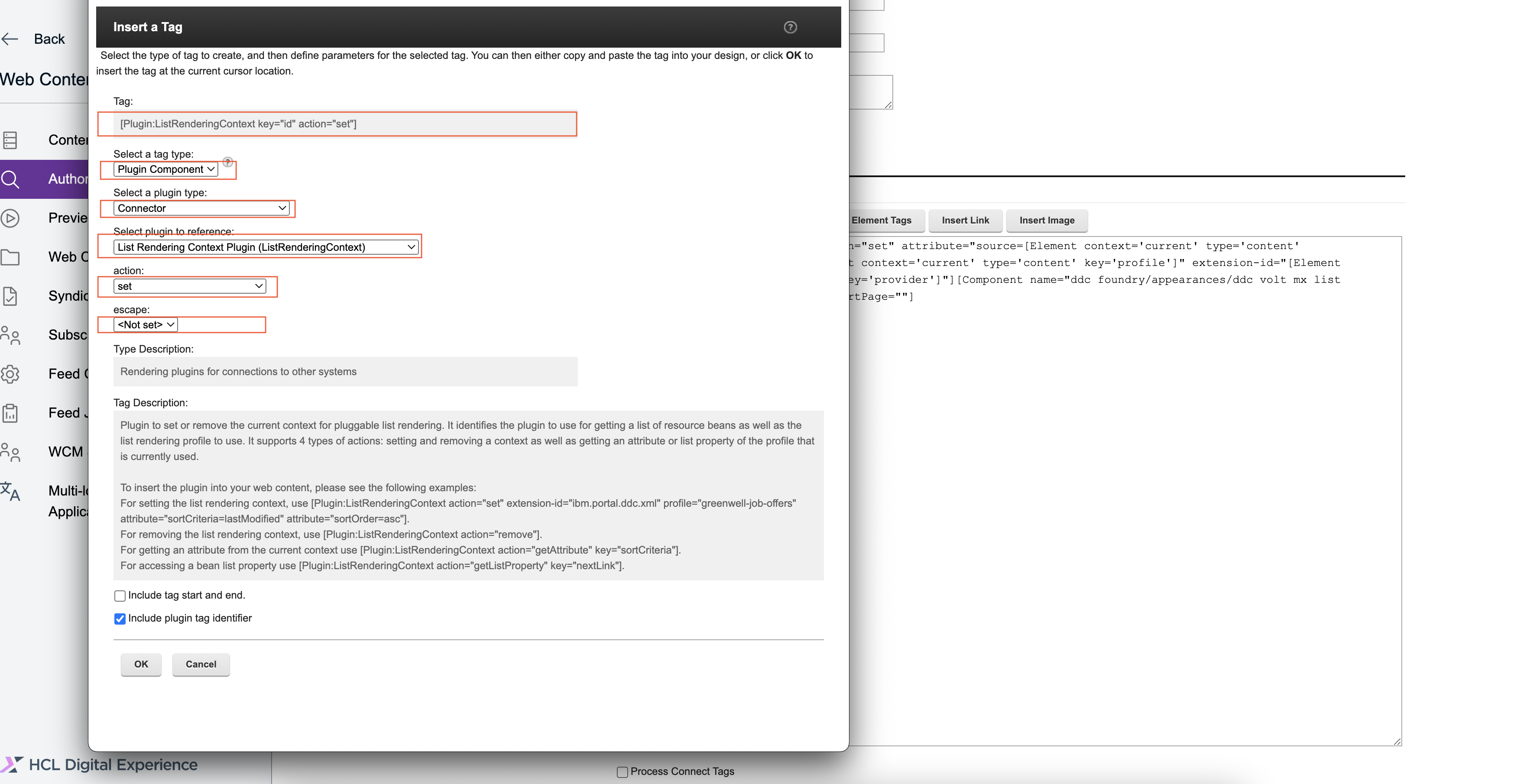

  1. Create a new presentation template with suggested name Volt MX data presentation template and under presentation template options, click on Insert Tag button:
  2. Select the type of tag to create, and then define parameters for the selected tag. You can then either copy and paste the tag into your design, or click OK to insert the tag at the current cursor location.
    Sample Presentation Template Options -
    [Plugin:ListRenderingContext action="set" attribute="source=[Element context='current' type='content' key='sourceuri']" profile="[Element context='current' type='content' key='profile']" extension-id="[Element context='current' type='content' key='provider']"][Component name="ddc foundry/appearances/ddc volt mx list appearances" resultsPerPage="" startPage=""]
    • Under attribute, define the data source endpoint. The content field set in this example is sourceuri, where you saved the endpoint in the content item.
    • profile refers to the List-Rendering Profile which was saved earlier in the WAS console. The content field that is set in this example is also profile, which is saved in the content item with the ddcDemo.profile.json value.
    • extension-id refers to the DDC plugin ID. The content field set in this example is provider, which is saved in the content item with value ibm.portal.ddc.json.

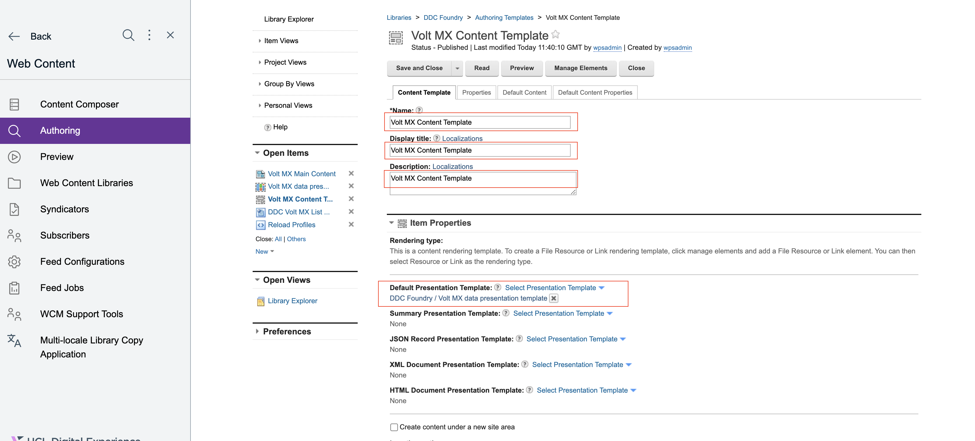

Creating a Content Template

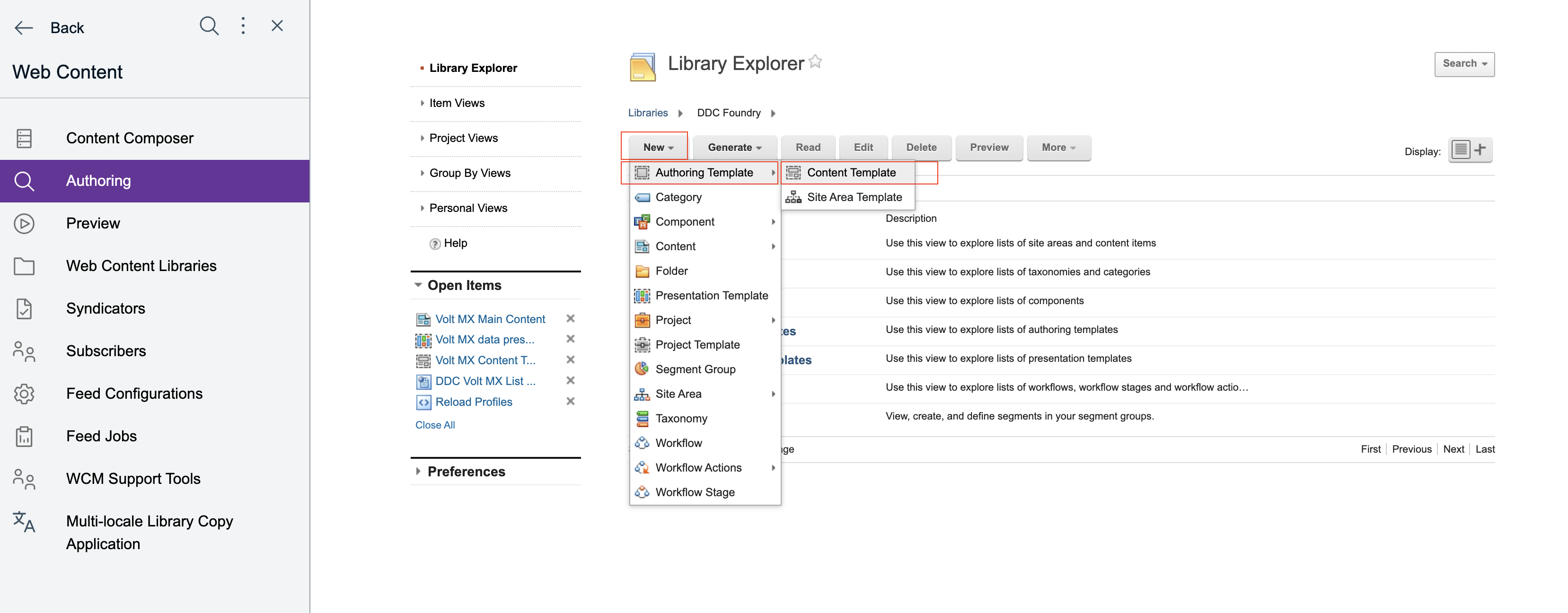

Under Authoring Templates, create a Content Template.
  1. Click on New button. Then, click Authoring Template, then Content Template component
  2. Add Name, Display title and Description with suggested name Volt MX Content Template. Once you have created your presentation template, you have to set this as the default presentation template Volt MX data presentation template.

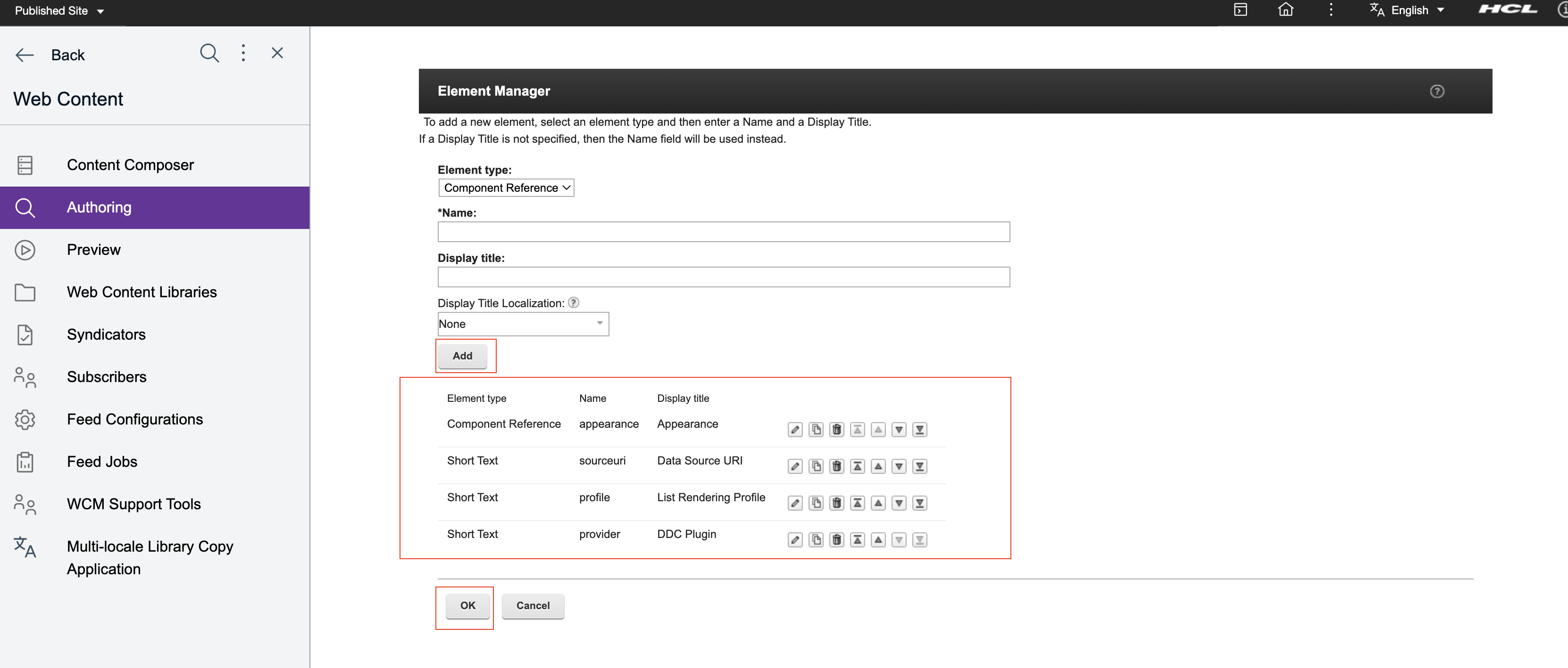

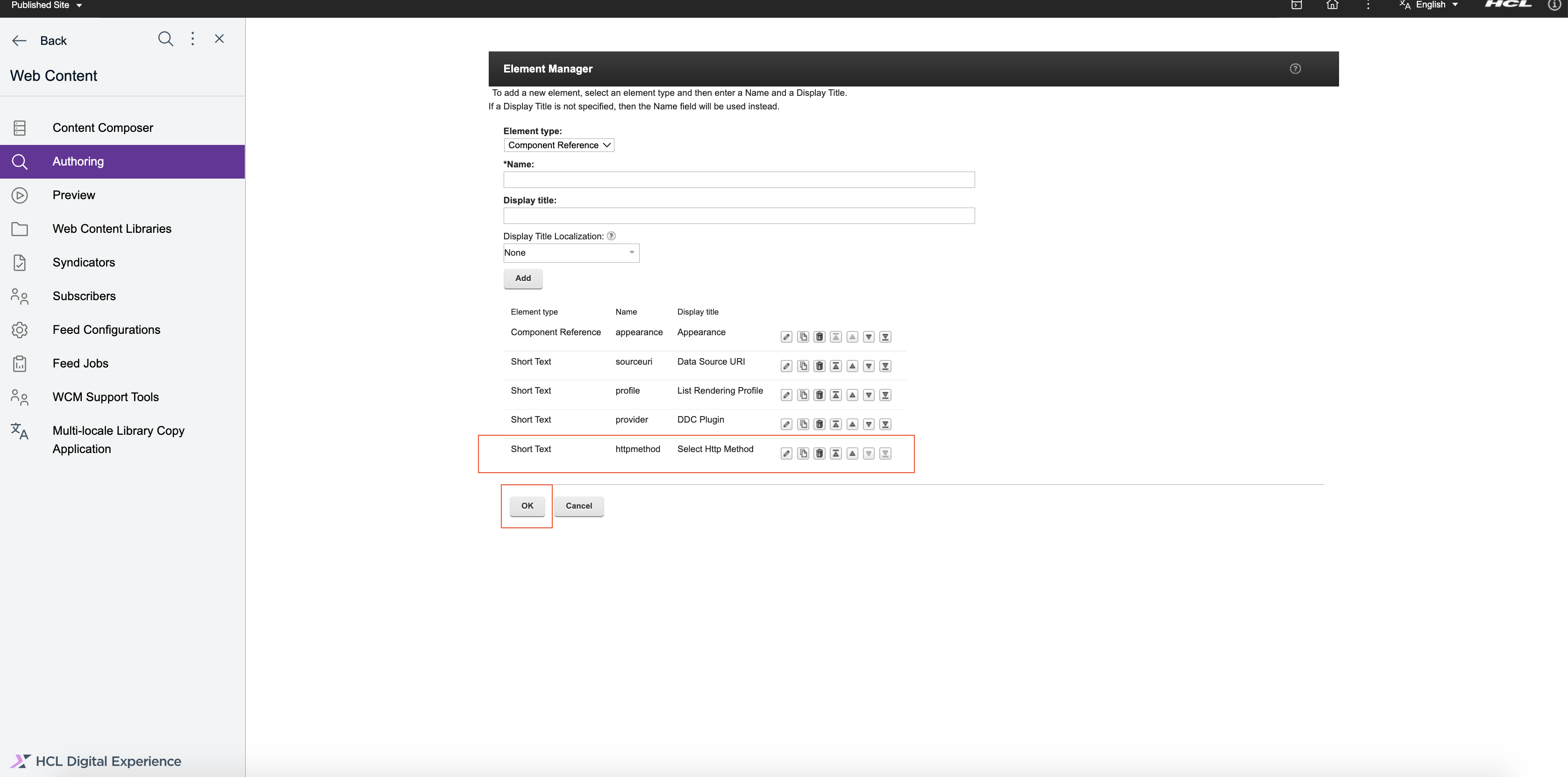

  3. Click on Manage Element and add the following elements to the content template as follows.
    Element type Name Display title
    Component Reference appearance Appearance
    Short Text sourceuri Data Source URI
    Short Text profile List Rendering Profile
    Short Text provider DDC Plugin
    Note
    In case of GET resource method, adding httpmethod element is not necessary, by default, the connection is initially set to GET. But if you selected any other Resource Method (for example - POST from Advanced > Front End API > Resource Method) while creating a new integration service with Volt MX Foundry, then you need to add another element httpmethod. This element (httpmethod) can be added as Short Text, Text, or OptionSelection. A content created from this content template can then load and render data from data sources using other resource methods. Leaving the optional httpmethod field value blank or empty when creating your content, which is based on the content template, would still have the connection fallback to GET.
    Short Text httpmethod Select Http Method

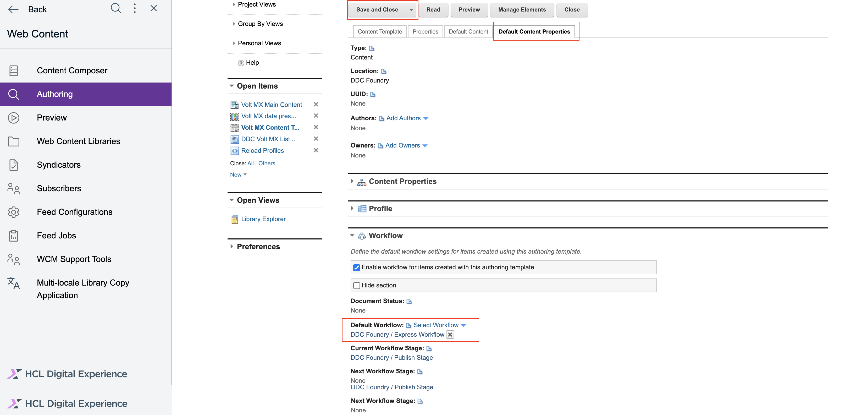

  4. Click on Default Content Properties and add Express workflow.
  5. Save and close.

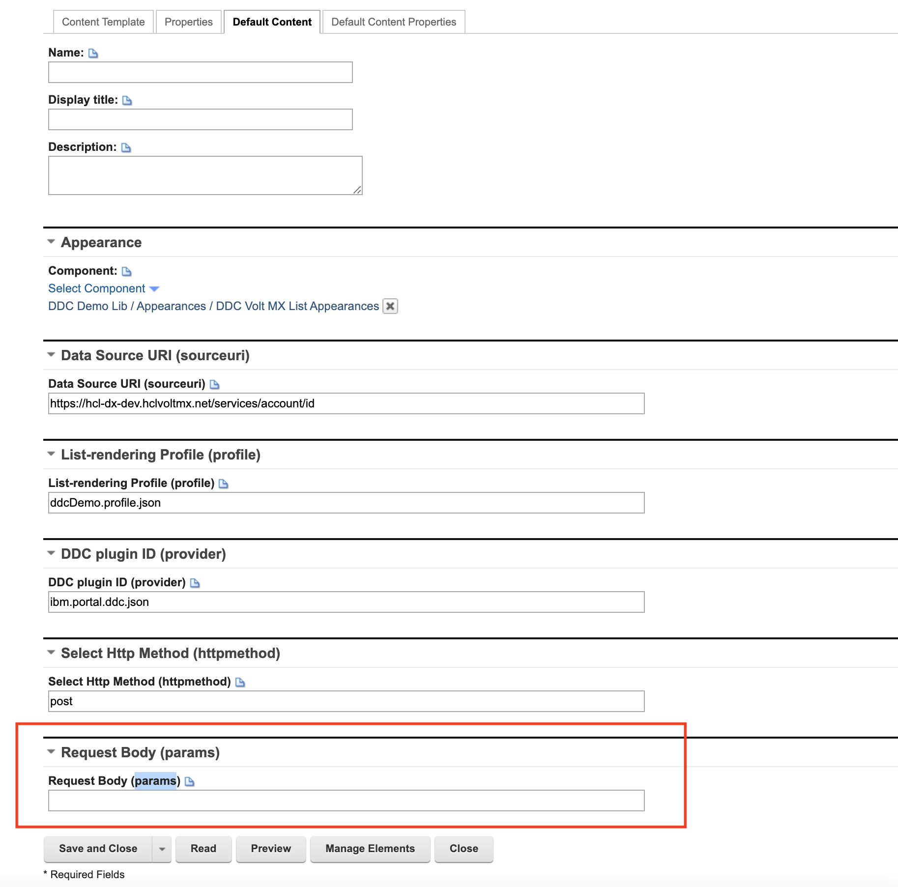

    If you selected any other Resource Method (for example, POST from Advanced > Front End API > Resource Method) while creating a new integration service with Volt MX Foundry, you might need the capability to submit data to the API which DDC will try to parse as sourceParams using the Presentation Template you created in the previous section. In that case, you must add a content field in your Content Template that will save this. It can have any name but for this example, we're using params.
    Short Text params Request Body

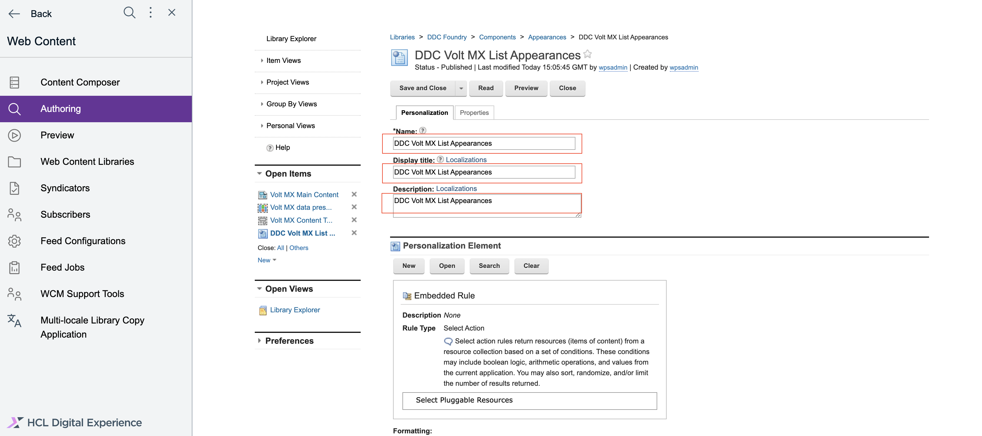

Creating a List Appearance

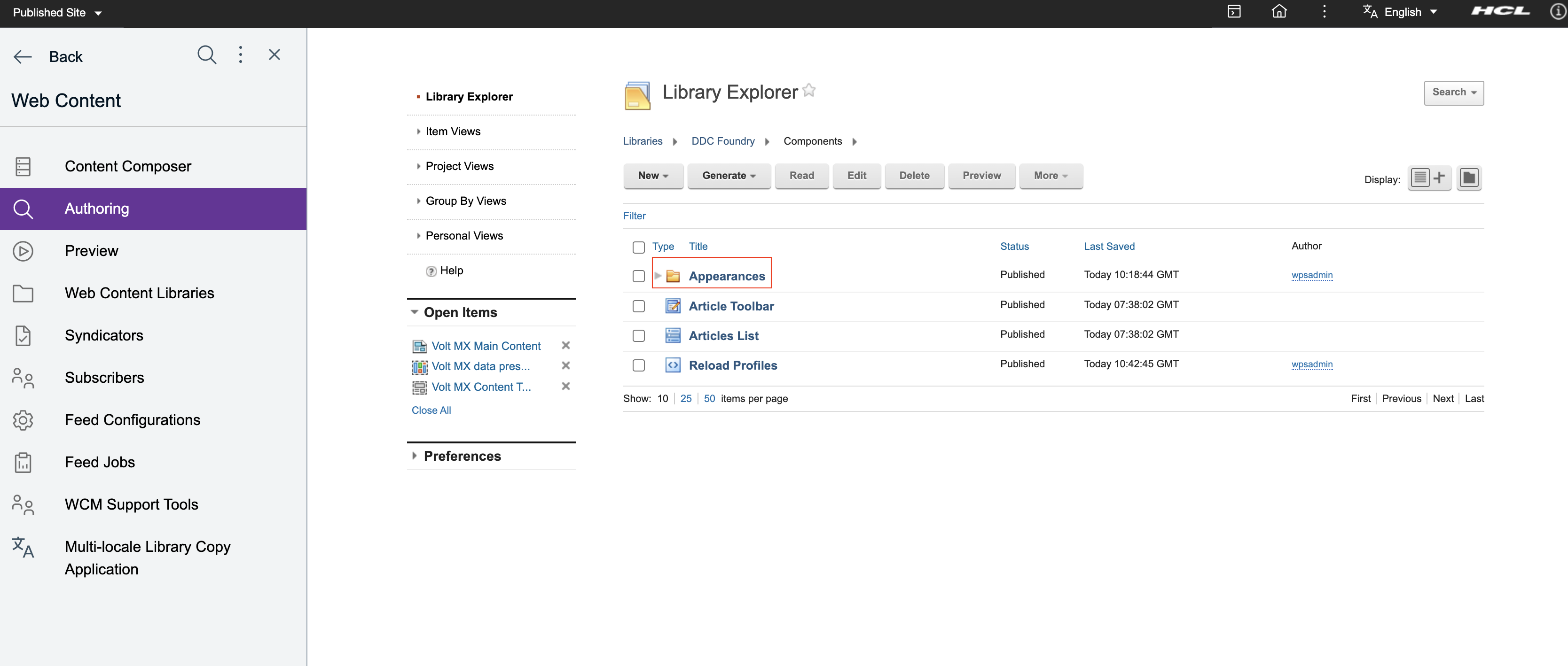

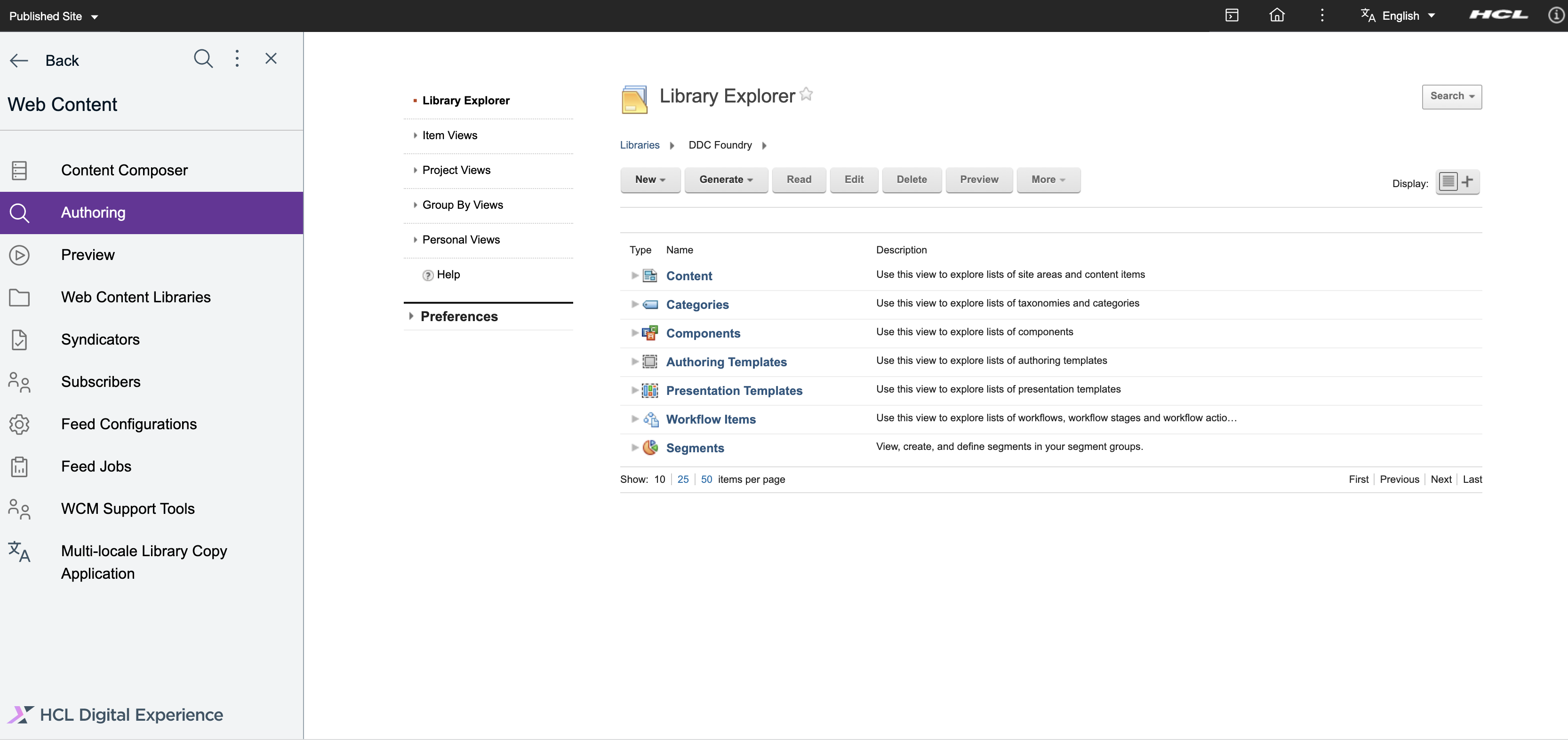

  1. Go to the Library Explorer. The following default items are available: Content, Categories, Components, Authoring Templates, Presentation Templates,Workflow Items, and Segments.
  2. Create an Appearances folder under Components. This is to ensure that your personalization components use the DDC selection rule. Select pluggable resources can be found easily in one place.

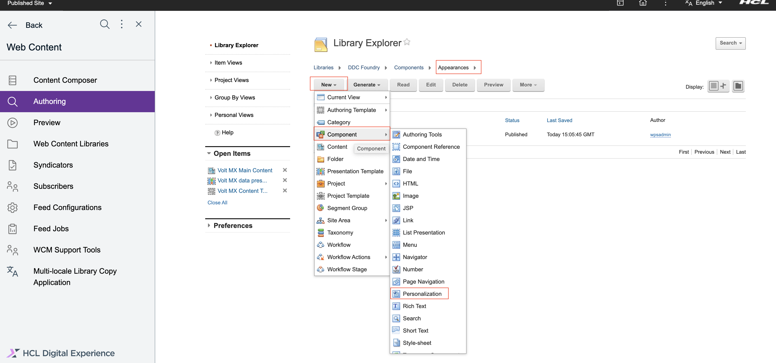

  3. Under Appearances folder, create a new Personalization component.
    1. Click New > Component > Personalization.
    2. Enter the name and title. Suggested name: DDC Volt MX List Appearances

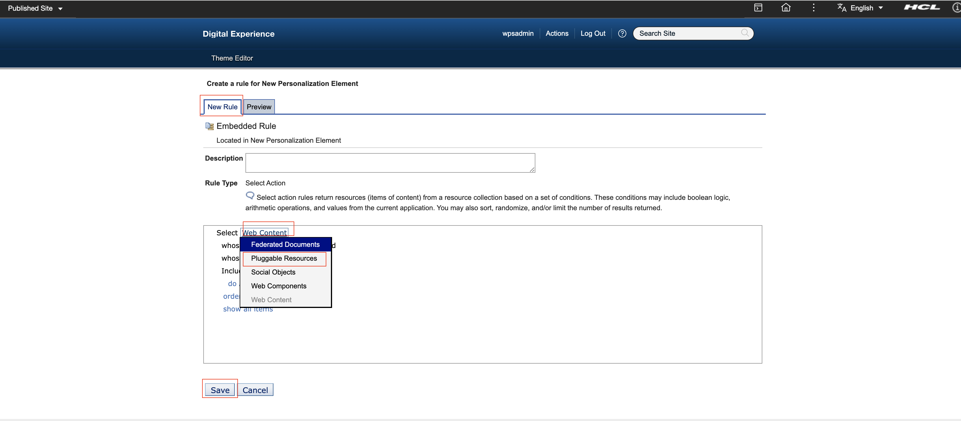

    3. Under Personalization Element, click New. As a New Rule, instead of Select Web Content, click on the Web Content phrase and select Pluggable Resources and click Save.

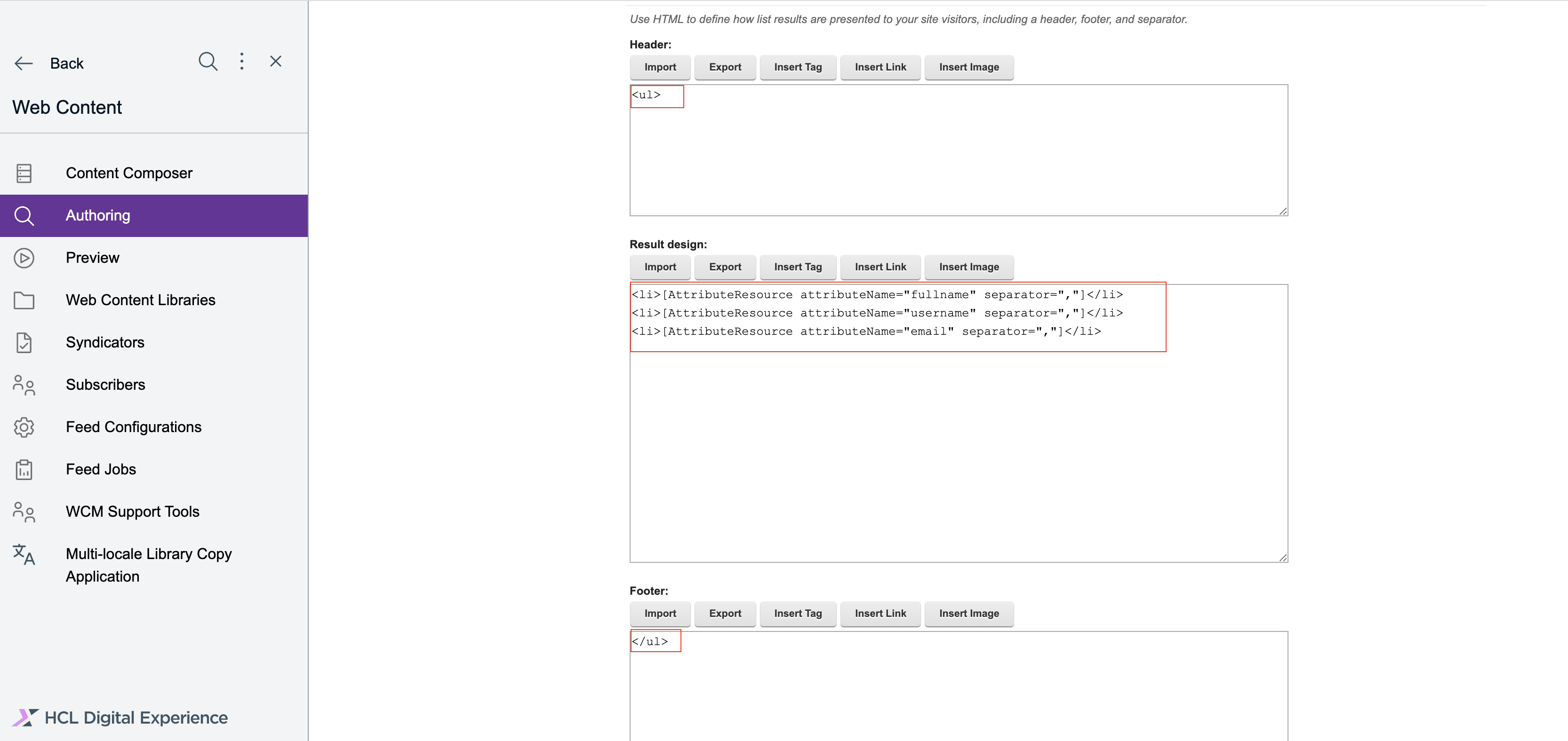

    4. In the List Presentation Markup, add the following:
      • Header: <ul>
      • Result design:
        <li>[AttributeResource attributeName="fullname" separator=","]</li>
        <li>[AttributeResource attributeName="username" separator=","]</li>
        <li>[AttributeResource attributeName="email" separator=","]</li>
      • Footer: </ul>
      Note
      The attributeName used here is the last part of the itemAttribute you have specified in your list rendering profile. For example, ddcDemo.ItemAttribute.fullname.
    5. Click Save and Close.

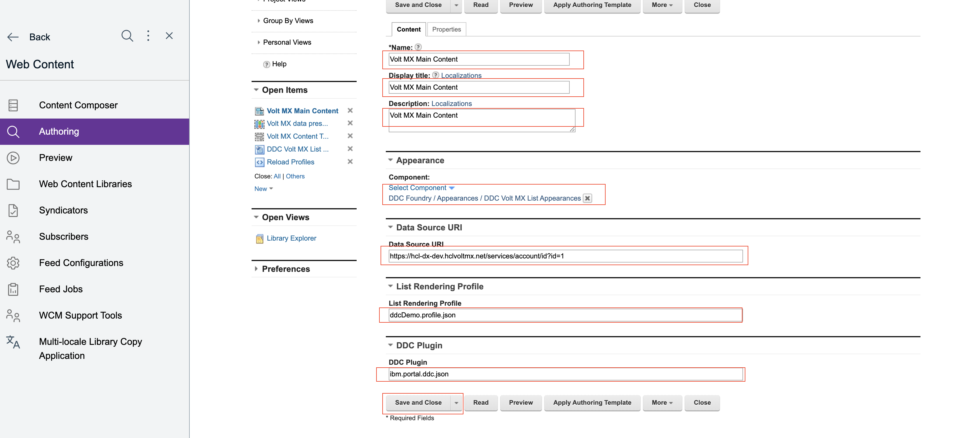

Creating a Content item

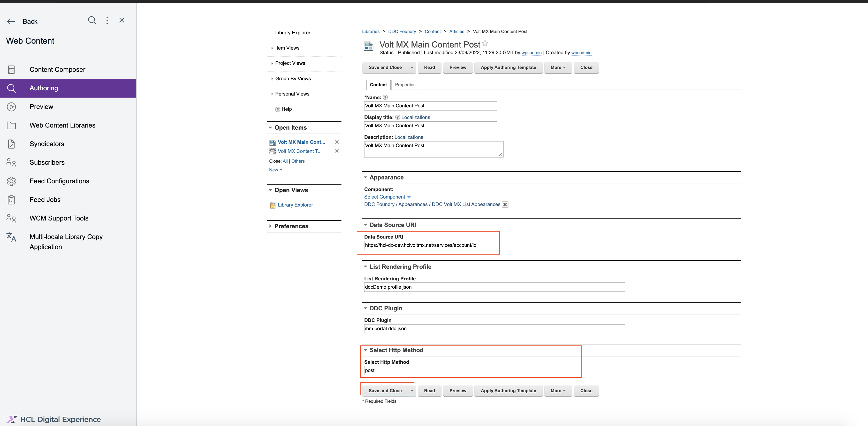

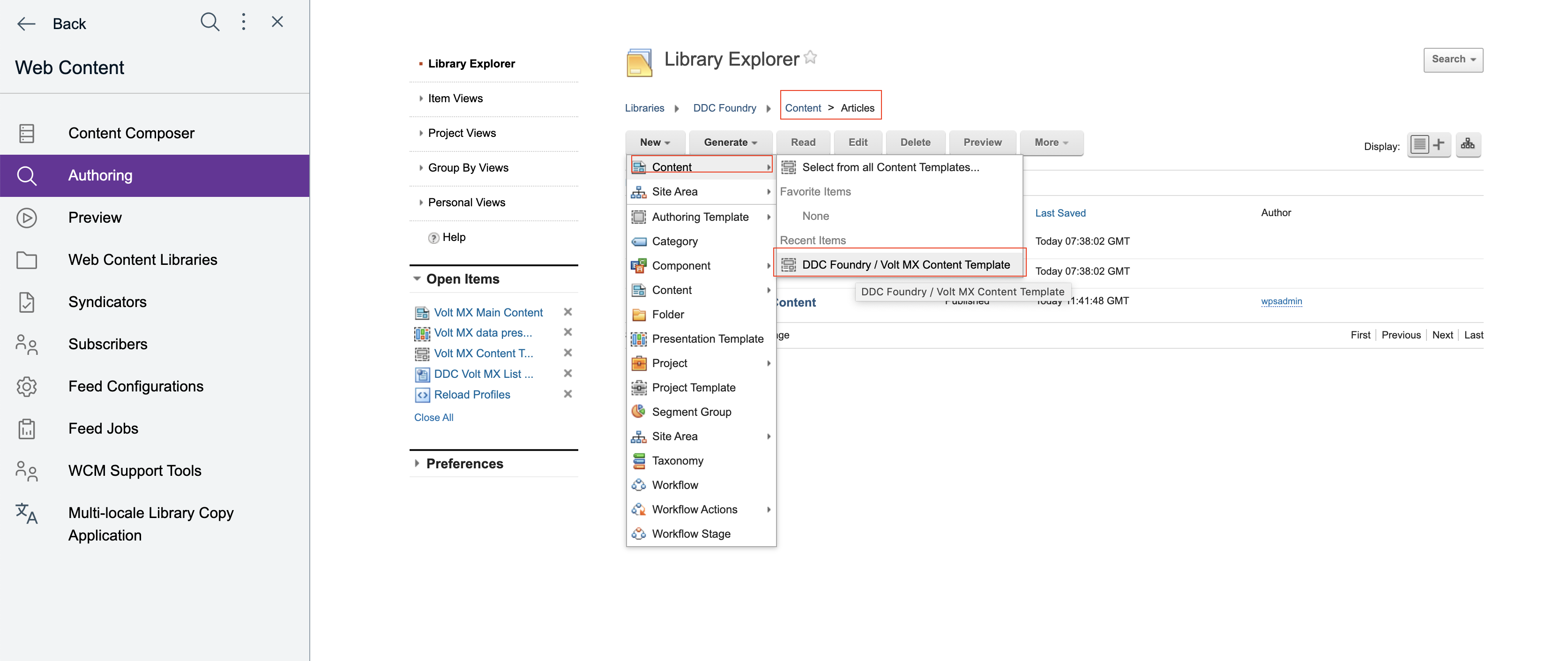

  1. Under your libraries, click Content, then click Articles, and create a new Content from the Content Template that you created earlier.
  2. Add Name, Display title, and Description with suggested name Volt MX Main Content, and in the content fields / elements, provide the following inputs:
    Content field title Value
    Appearance auto filled once you've chosen a component
    Data Source URI https://hcl-dx-dev.hclvoltmx.net/services/account/id?id=1
    List Rendering Profile ddcDemo.profile.json
    DDC Plugin ibm.portal.ddc.json

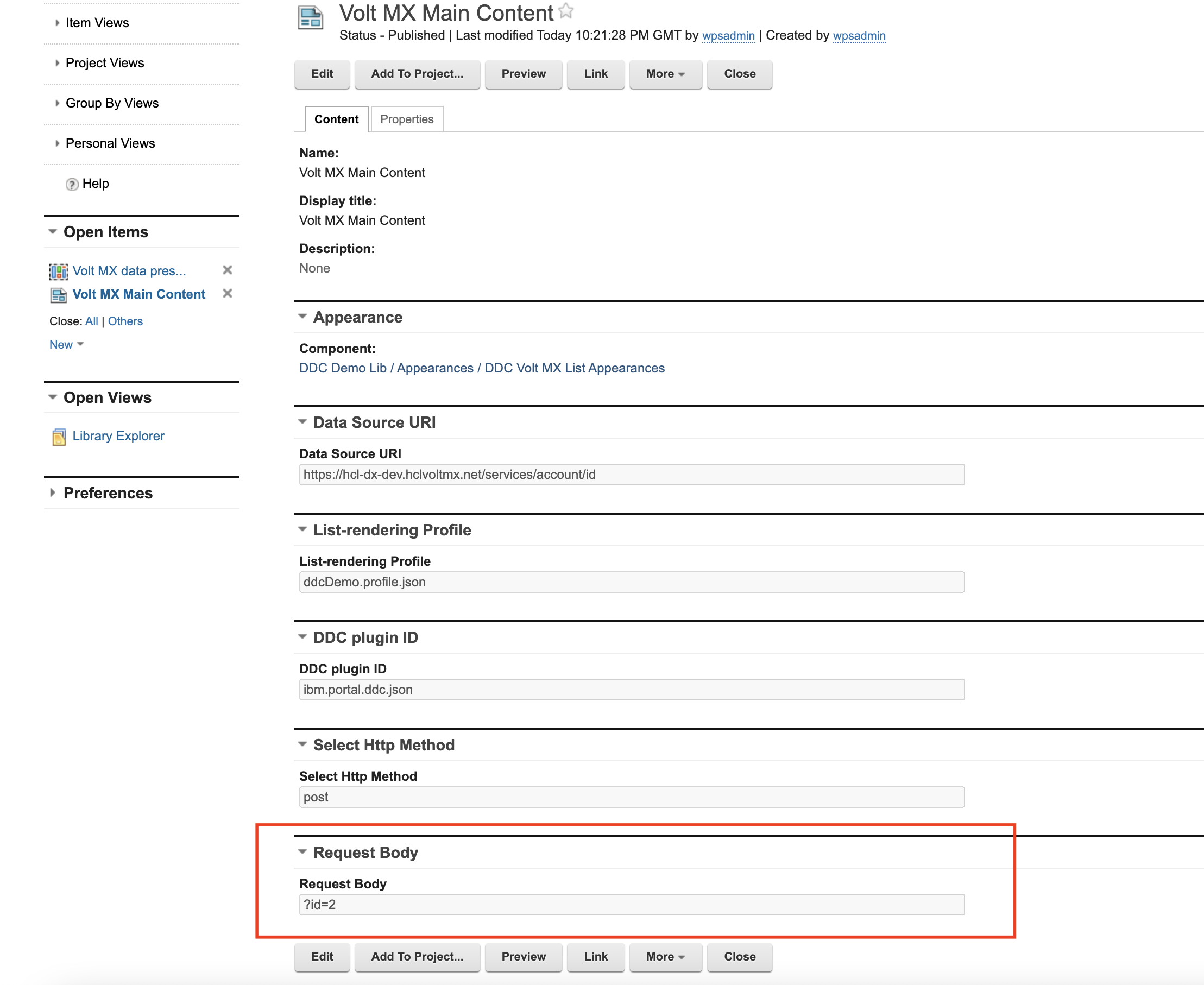

    Note
    If you selected any other Resource Method (for example - POST from Advanced > Front End API > Resource Method) while creating a new integration service with Volt MX Foundry then you need to provide value for httpmethod. Also, the value of Data Source URI would be the POST URL endpoint in this case.
    Select Http Method post
  3. Save and close.
    Note
    If you selected any other Resource Method (for example, POST from Advanced > Front End API > Resource Method) while creating a new integration service with Volt MX Foundry, you might need the capability to submit data to the API which DDC will try to parse as sourceParams using the Presentation Template you created in a previous section. In that case, you must provide value for params in your Content item. You can pass many key-value pairs of data and it should have the format of a URL query string.
    Request Body ?id=2

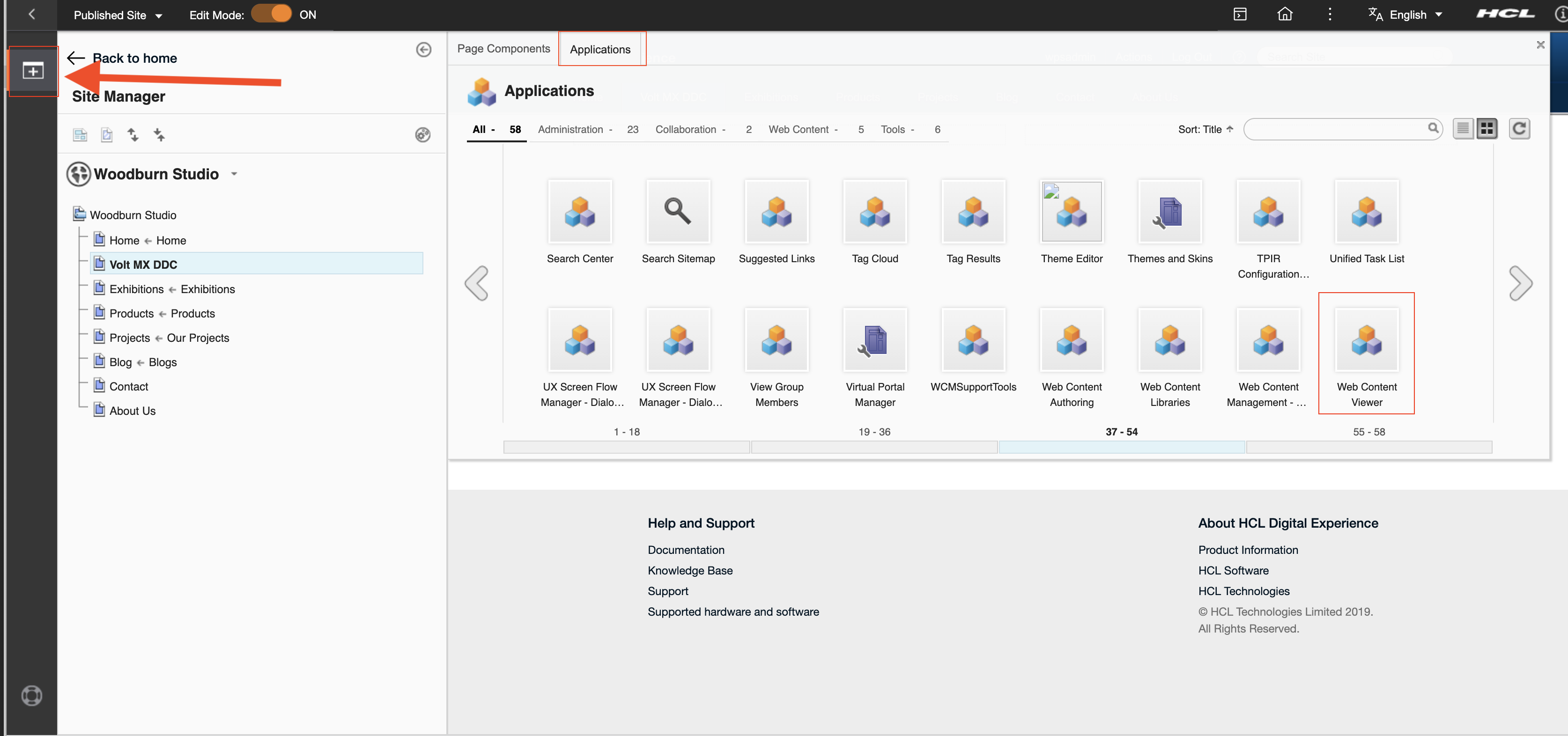

Use in Portal Page
Now you can use all the WCM artifacts that you created on a portal page.
Note
This guide is using an existing page but you can create a completely new Content Root or any child or sibling page on any site. Refer to Creating a page from the site toolbar for creating a page.

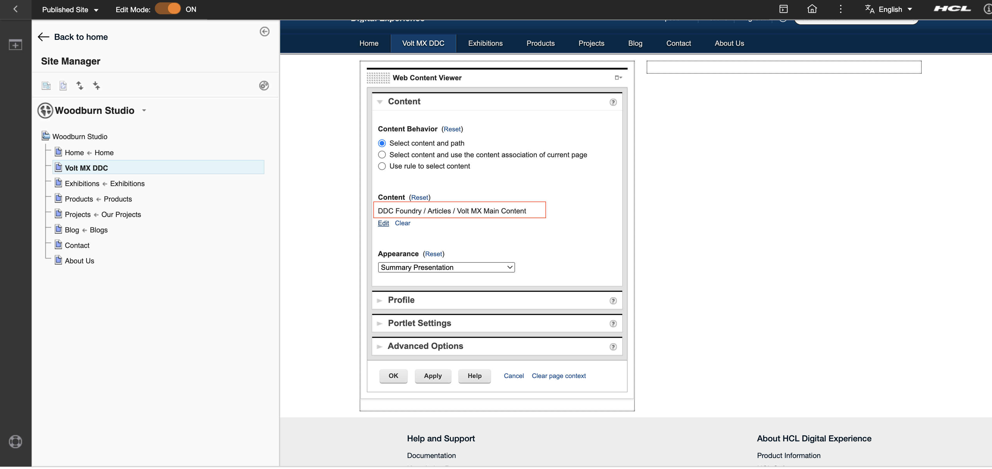

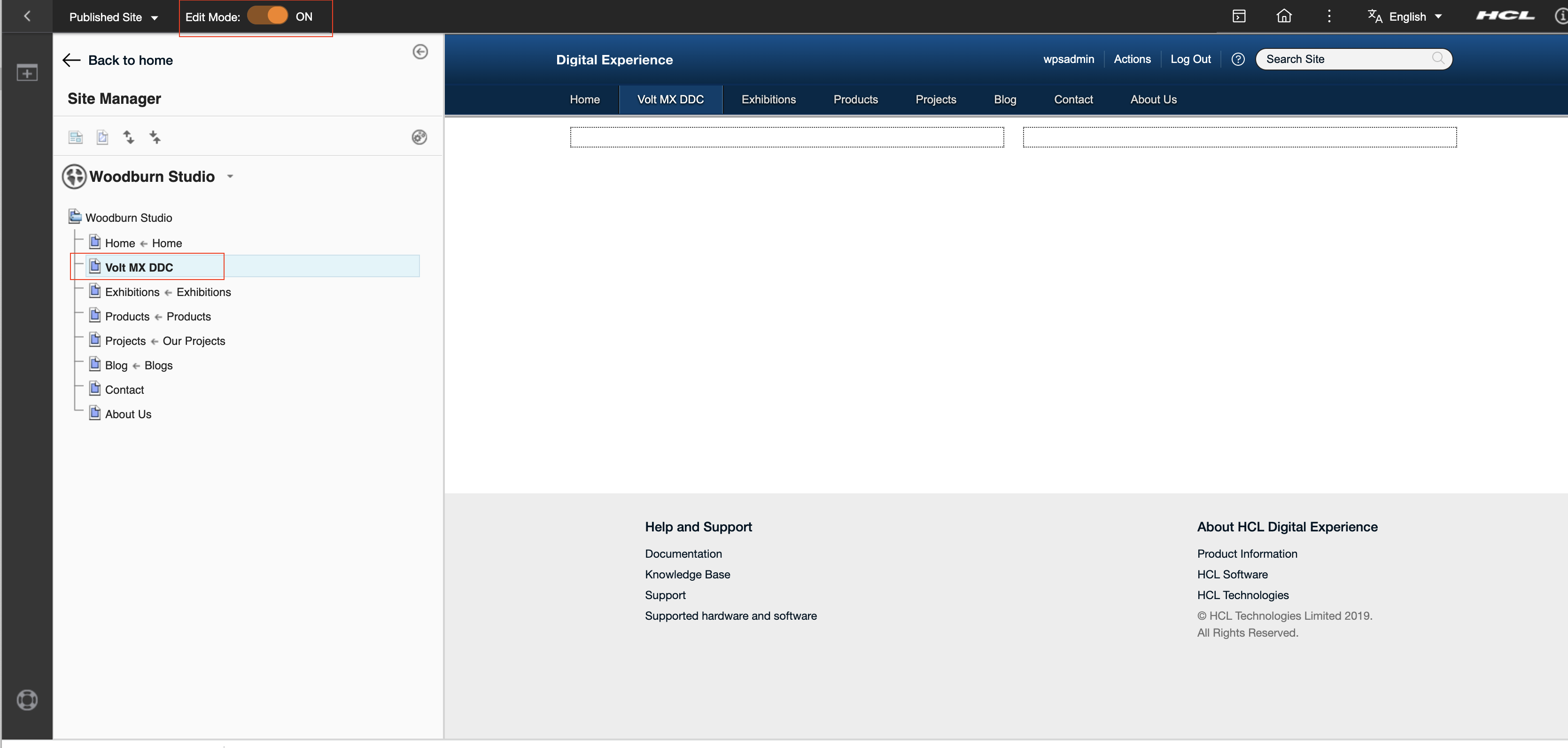

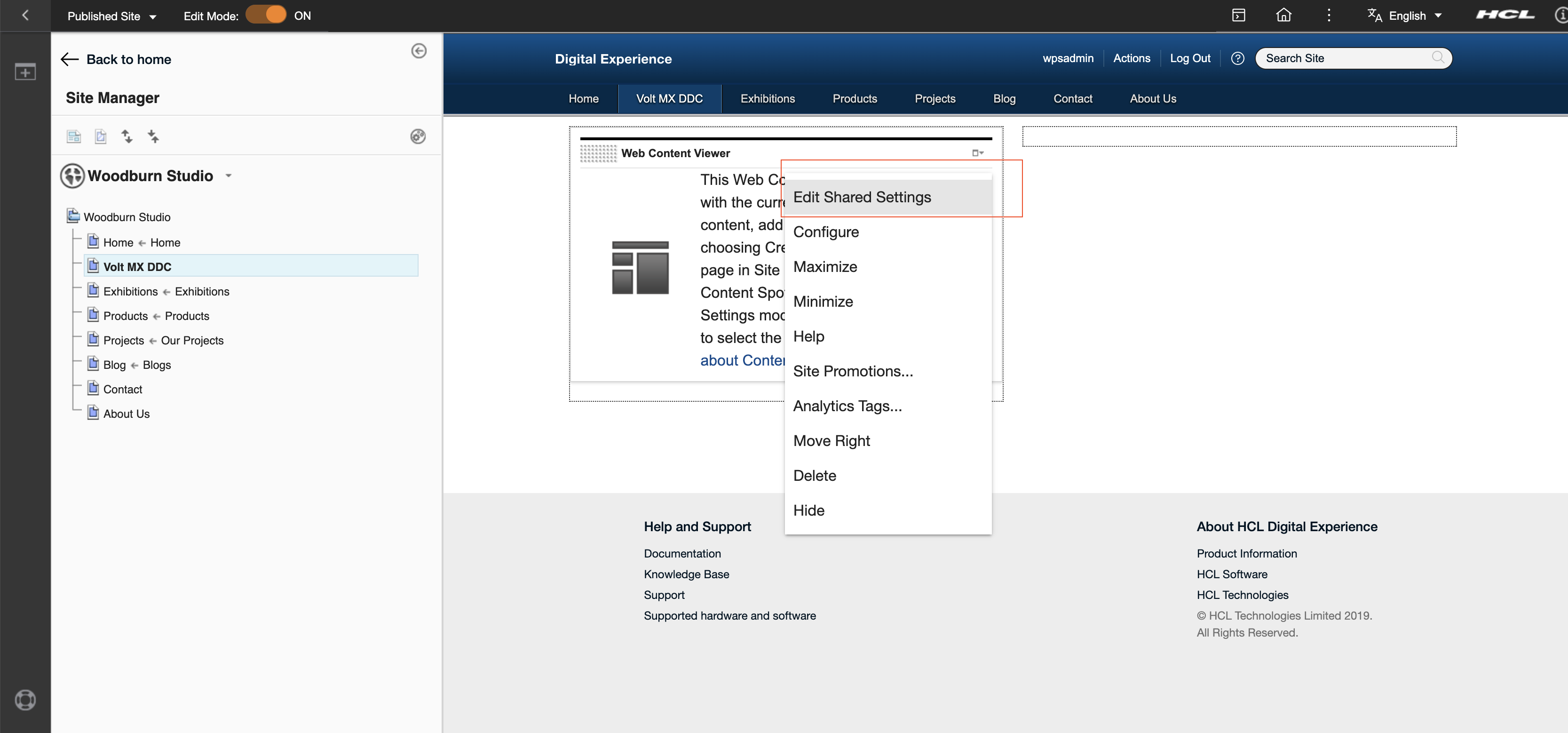

  1. Go to any page (e.g. Volt MX DDC) and enable Edit mode.

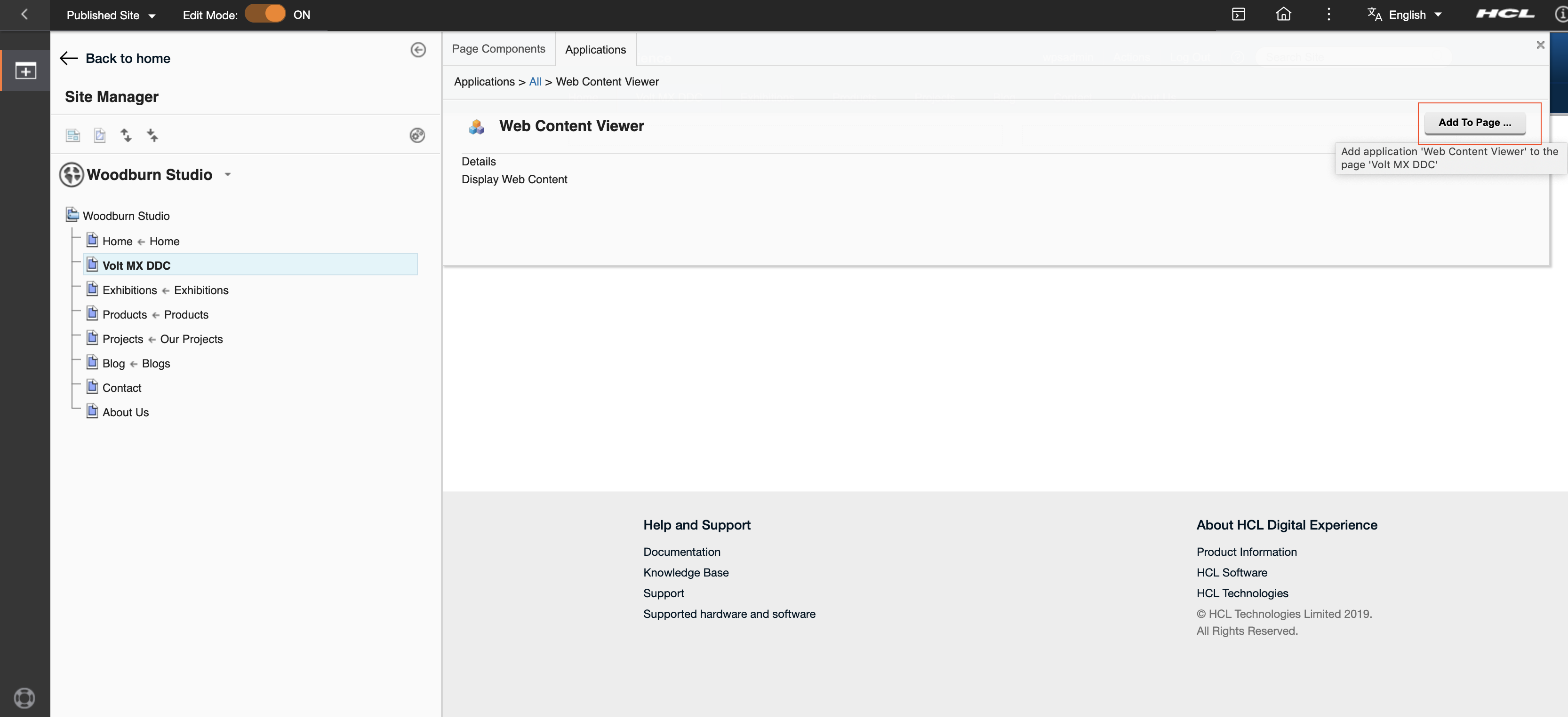

  2. Click on plus icon in left navigation panel. Then click on Applications and add a Web Content Viewer on the page.
  3. Click on Add To Page button.
  4. Inside the Web Content Viewer, click on the upper right dropdown button and select Edit Shared Settings.

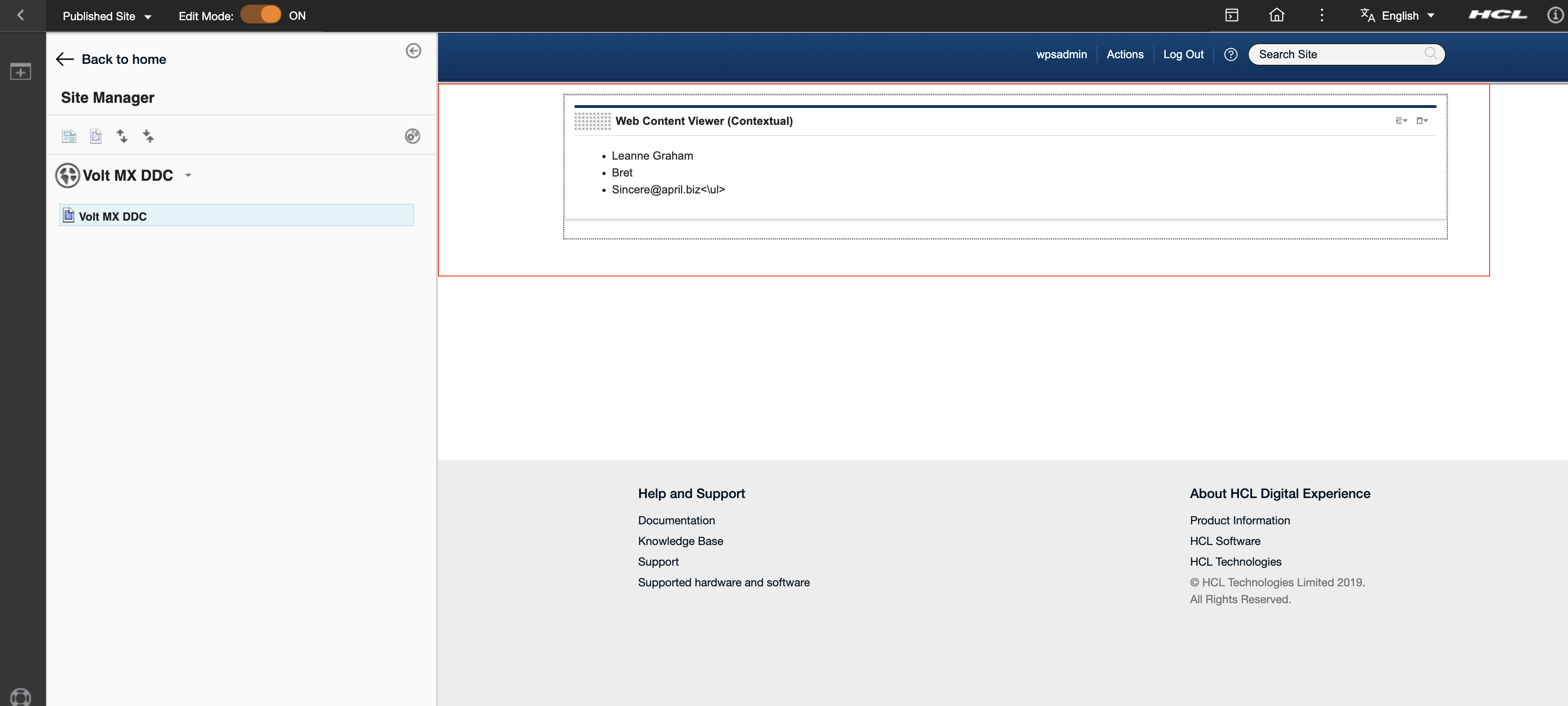

  5. Under Content, change the mapped content to the Content Item you created above.
  6. Click OK, and the following output page will be displayed.
