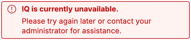

Error messages
When a backend operation fails, the IQ interface displays a generic alert banner to the user:
IQ Error Message Display
To identify the underlying cause behind this banner, review the backend response payloads within the browser developer tools or examine the container logs to classify the issue:
Error Description Solution
Communication error An error occurred while communicating with the core DX server during a backend operation. Make sure the core HCL DX server is active and reachable from the IQ integrator container.
Connection error The client-side WebSocket connection between the browser and the IQ backend failed to establish. Check local network connectivity. Make sure corporate firewalls, VPNs, or reverse proxies allow WebSocket traffic on /dx/api/iq/v1/ws.
Invalid format The core DX server responded, but the data payload was in an unexpected or invalid format. Make sure the HCL DX base platform and IQ components are running compatible versions. Check logs for API contract mismatches.
No response or timeout A backend request took too long, or the core DX server failed to return a response. Try a shorter or simpler prompt. Check backend logs for connection drops or high resource utilization on the core platform.
Unable to connect to AI service The IQ backend is active but cannot establish a connection to the external LLM provider. Wait and try the request again. Contact a system administrator to check the LLM provider credentials, API keys, and outbound network connectivity.
Unauthorized The active user session does not have the necessary roles or permissions to access IQ. Contact your HCL DX system administrator to check your user persona configuration and role assignments.
Unsupported operation The AI assistant does not have the capability required to perform the action requested by your prompt. Rephrase the prompt. If the operation is supported on your system, make sure the required backend modules or integrations are fully configured and enabled.

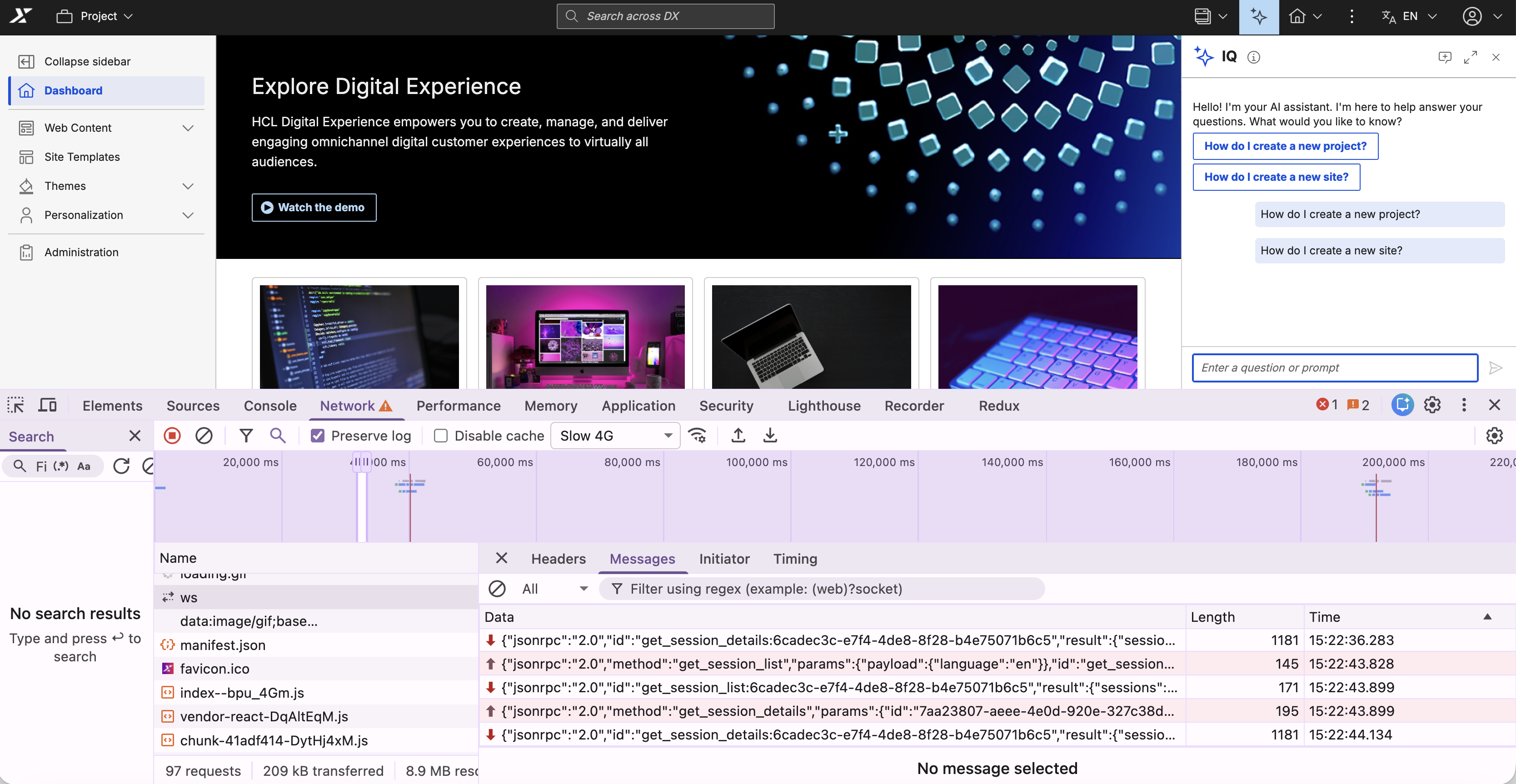

Enabling client-side tracing
Capture detailed diagnostic information using browser developer tools to investigate WebSocket and interface issues.
  1. Open browser Developer Tools by pressing F12 or right-clicking the page and selecting Inspect.
  2. Select the Console tab and check for error logs or warnings related to IQ.
  3. Select the Network tab and filter by WS to inspect the active WebSocket connection. Ensure the connection to /dx/api/iq/v1/ws shows a status code of 200. Select the connection string to view the individual JSON-RPC messages exchanged between the browser and IQ.
    IQ WebSocket Message Trace
  4. To export a full trace for HCL Support, right-click inside the Console tab and select Save as to export the log file.
