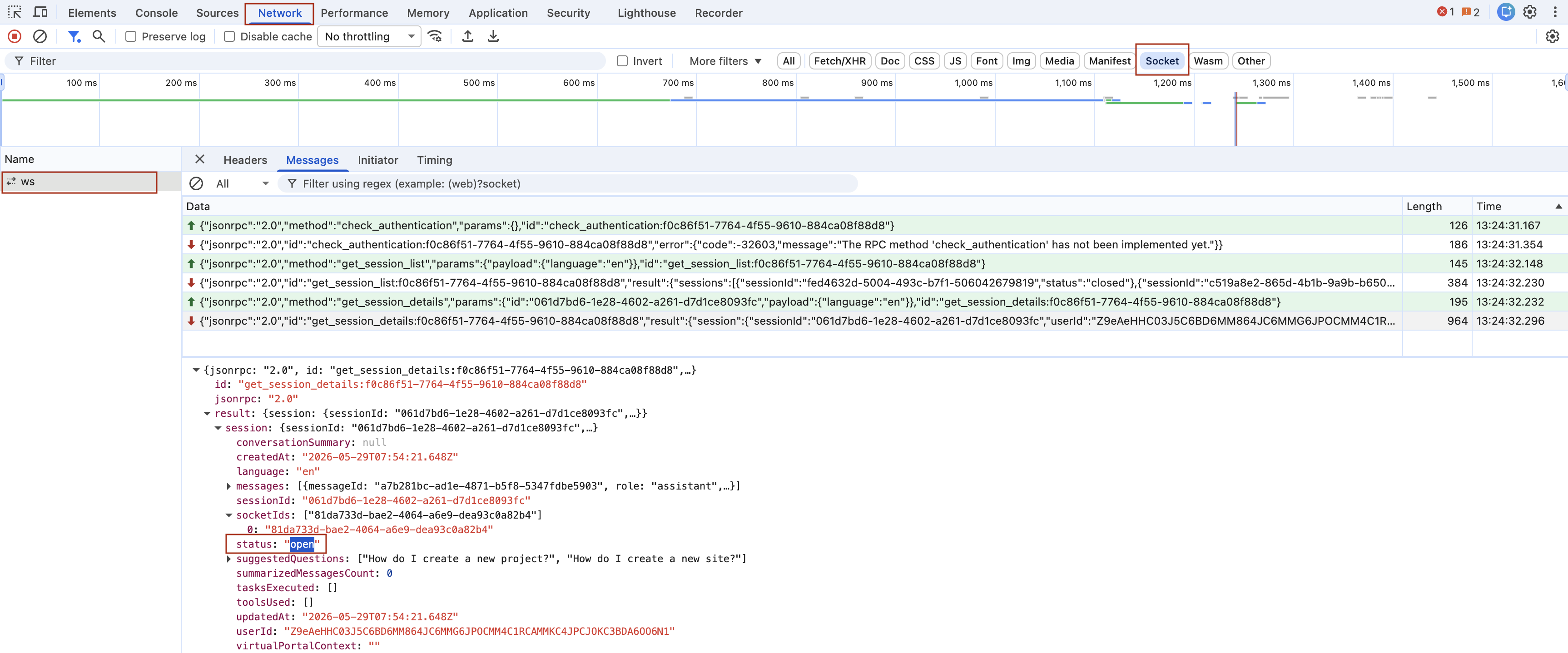

    1. The WebSocket connection is established:
      1. In your browser developer tools, open the Network tab.
      2. Select Socket (Chrome), WS (Firefox), or WebSockets (Safari).
      3. Confirm the ws connection is established (status: "open").
        HCL Doc IQ WebSocket connection established

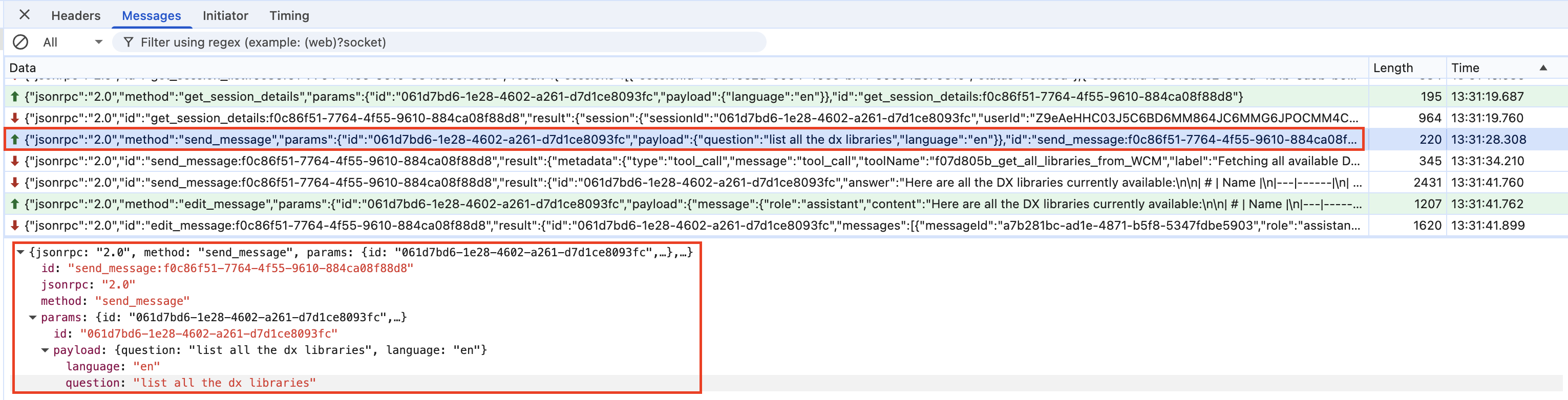

    2. The query is processed:
      1. In the same ws connection, open the Messages tab.
      2. Verify that an outbound JSON-RPC message with method: "send_message" is sent for your query.
        HCL Doc IQ send_message request in Network WebSocket messages

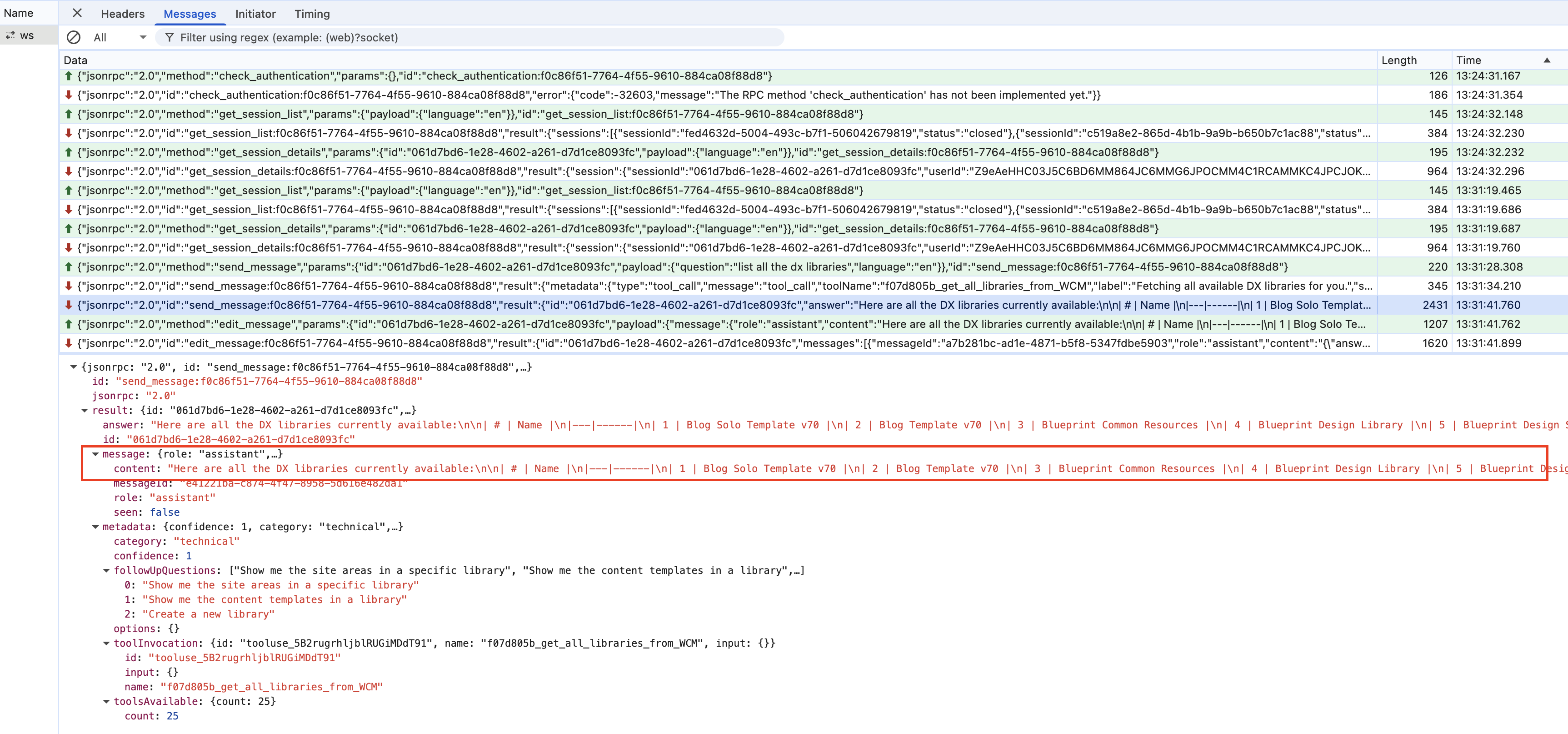

    3. A response is returned from the AI model:
      In the same Messages tab, verify an inbound JSON-RPC response is returned for your send_message request and includes the AI-generated answer payload.
      HCL Doc IQ send_message response in Network WebSocket messages
