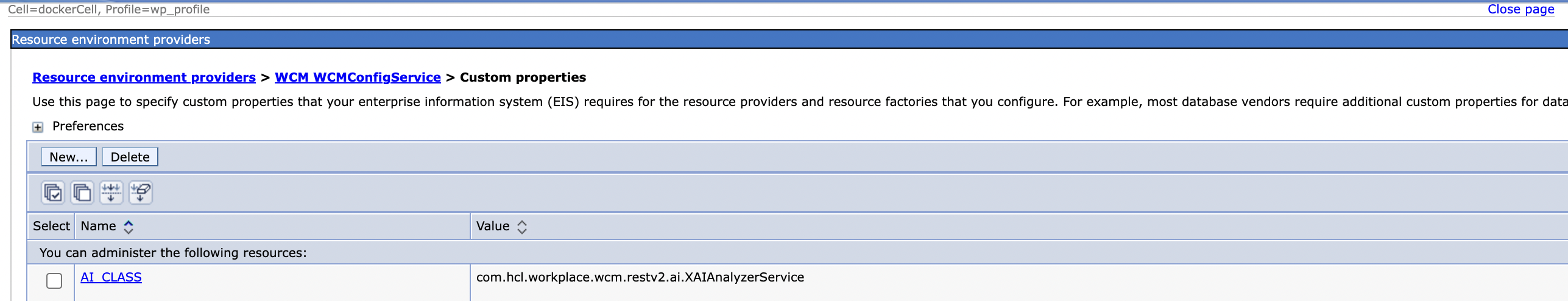

    1. Log in to the WebSphere Application Server console.
    2. Verify that the AI_CLASS configuration property is added in WCM Config Service by going to Custom Properties: click Resource > Resource Environment > Resource Environment Providers > WCM_WCMConfigService > Custom Properties. Possible values for AI_CLASS are:
      • com.hcl.workplace.wcm.restv2.ai.ChatGPTAnalyzerService (if ContentAIProvider value is set as OPEN_AI)
      • Value set in parameter CustomAIClassName (if ContentAIProvider value is set as CUSTOM)
    2. Verify that the AI_CLASS configuration property is deleted from WCM Config Service.
