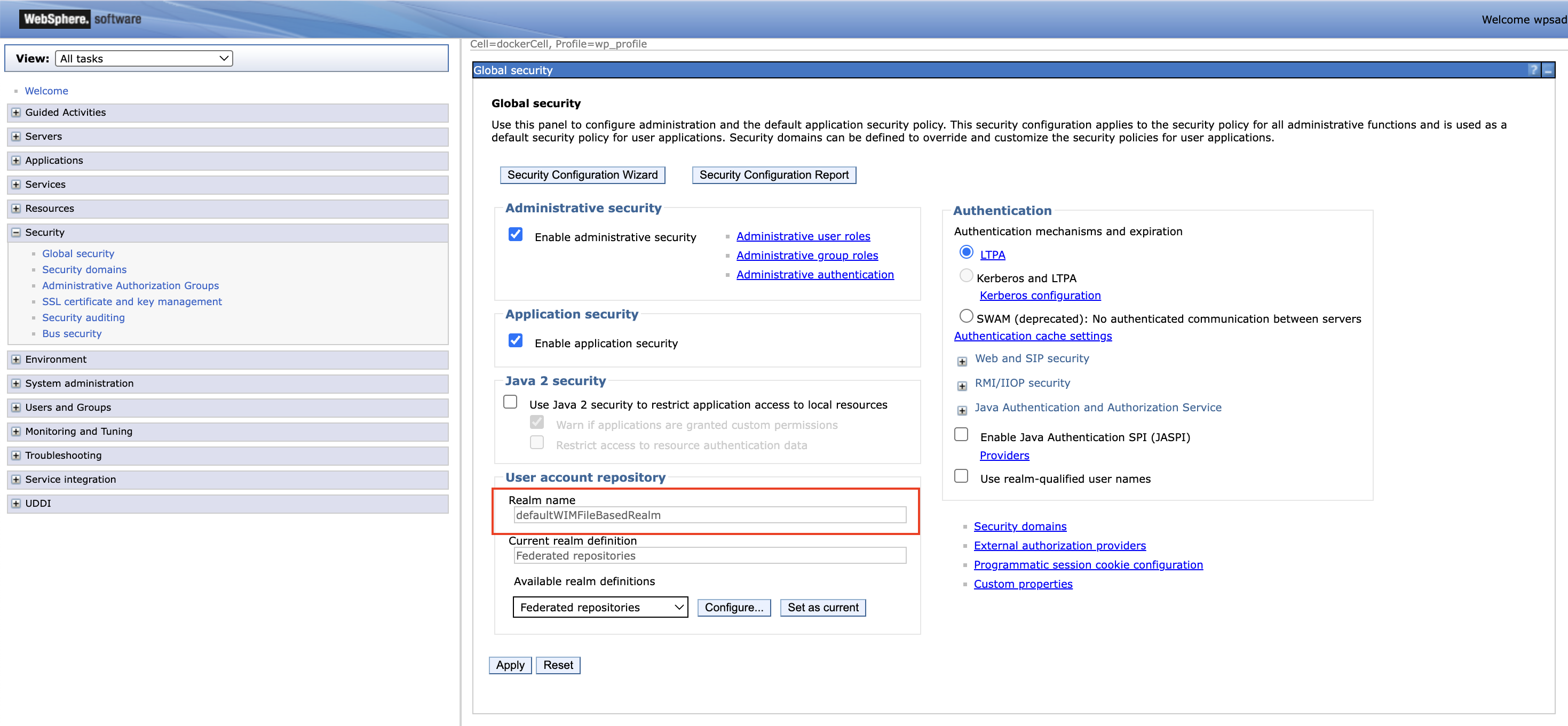

    To set the realm name for DX:
    1. Log in to the WebSphere Integrated Solutions Console (your-domain.com/ibm/console) as an administrator.
    2. Click Security > Global Security > User Account Repository > Realm Name.
    3. Under User account repository, set the Realm name (for example, defaultWIMFileBasedRealm).
    4. Click Apply.
    5. Click Save at the top of the console messages.
