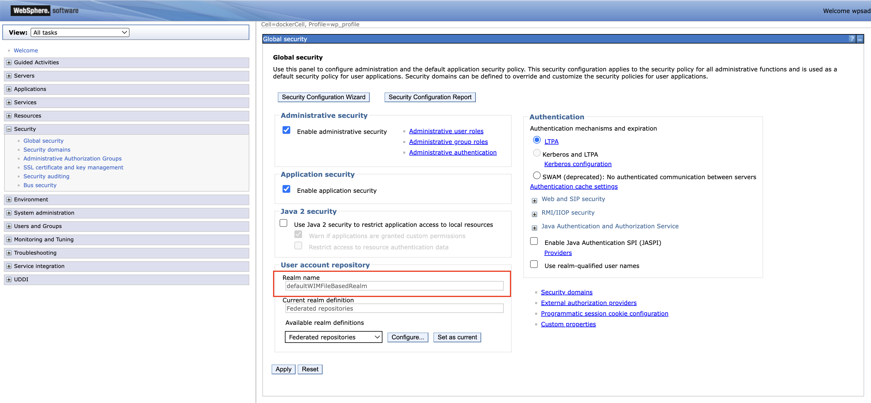

    To set the realm name for DX:
    1. Log in to the WebSphere Integrated Solutions Console (your-domain.com/ibm/console) as an administrator.
    2. Click Security > Global Security > User Account Repository > Realm Name.
    3. Under User account repository, set the Realm name (for example, defaultWIMFileBasedRealm).
    4. Click Apply.
    5. Click Save at the top of the console messages.

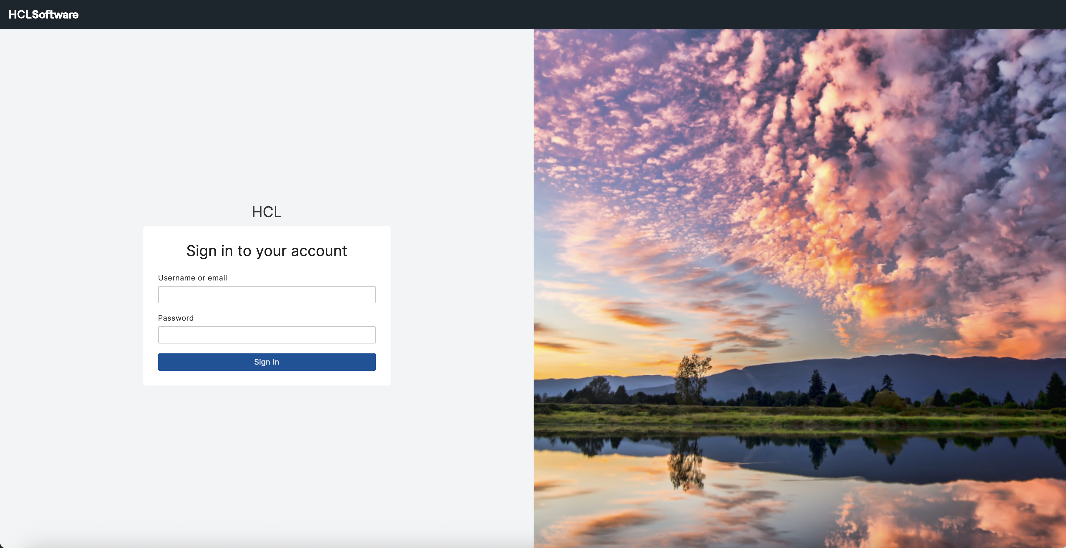

  1. Install and configure your IdP.
    1. Create a client for each product. IdPs serve as the single point of truth for credential inputs.
    2. (Optional) Customize the IdP access UI. Refer to IdP Customization and Consideration for more information.

      Since Leap was installed with a Helm chart, a new pod will be created automatically. Afterwards, accessing Leap should redirect you to authenticate using your OIDC IdP.
      For example, the following screenshot shows an authentication page accessed using Keycloak:
