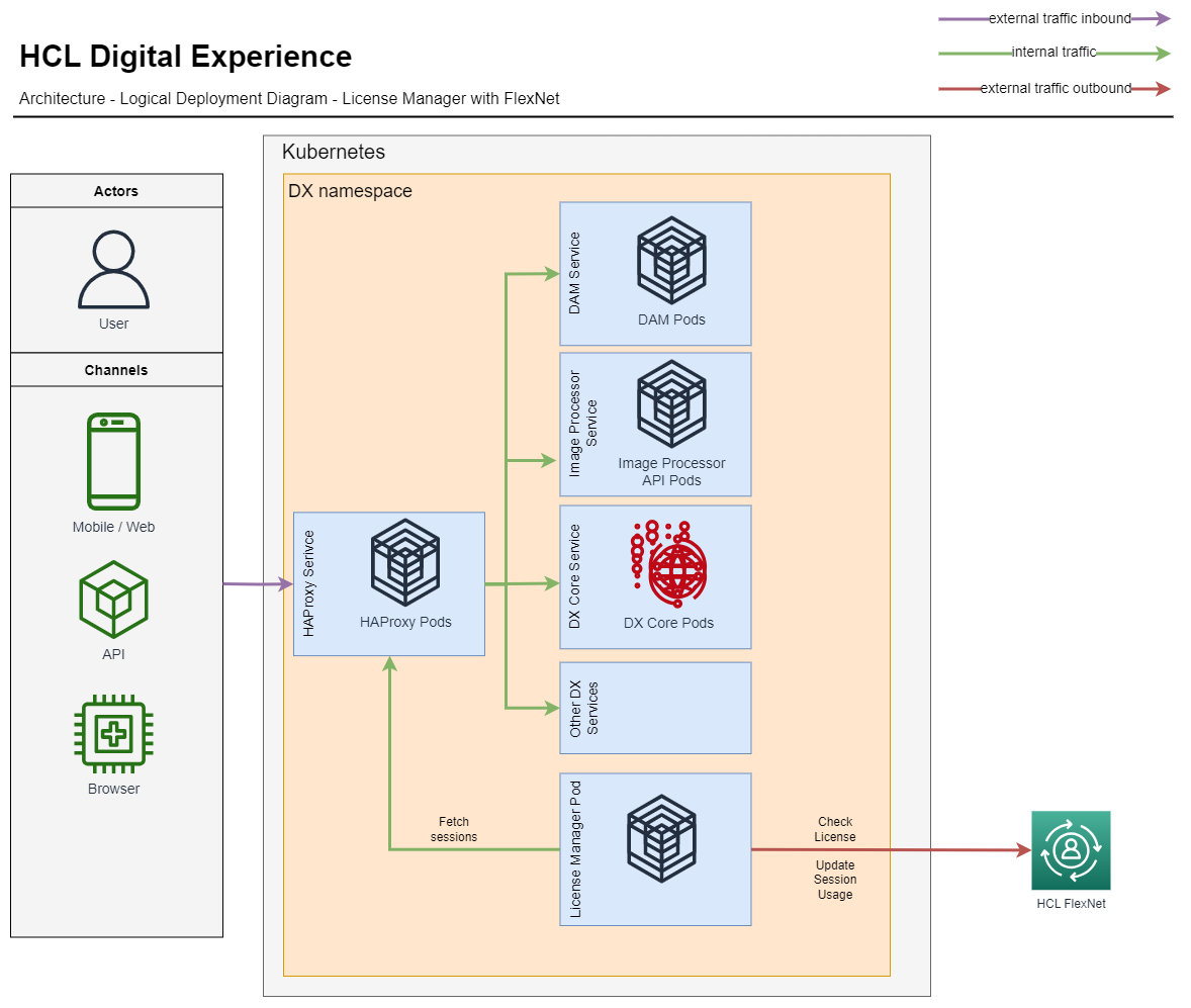

Review the architecture that presents the License Manager component of HCL DX v9.5 Container Update software, which follows in the next section.
Architecture
The License Manager component communicates with the HCL FlexNet server. This is to validate license entitlement at set periods for HCL DX Cloud Native V9.5 Tier 1 – 7 software after you configuring the DX Cloud Native 9.5 deployment through the Helm chart. The License Manager component also transmits user session consumption from your production DX Cloud Native 9.5 deployments to their specific FlexNet entitlements dashboard.

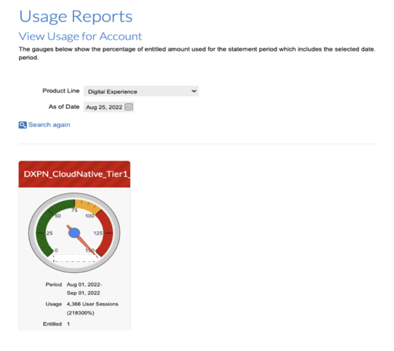

Accessing FlexNet usage reporting dashboard
Access the Reports section of the HCL Software License and Download Portal server.
  1. In the HCL Software License and Download Portal server, go to Usage > Usage Report.
  2. Select your account and then click Search.

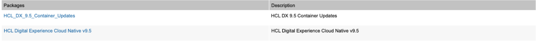

  3. Select Digital Experience Cloud Native 9.5 from the list of your account entitlements. Results are displayed and are similar to the following example.
    Note
    The results might show an overage percentage amount in parentheses which does not apply to this informational dashboard report.
The Usage report shows the following information:
  • Period: The period of the report results.
  • Usage: The number of user sessions that ran on your DX 9.5 Container Update deployment that is mapped to this entitlement and that has the ProductionEnvironment variable enabled and set to True. See the user session details in the latest HCL Digital Experience Cloud Native 9.5 license on the HCL Software License Agreements site.
    Note
    Only user-session data totals per month for the calendar year of purchase are transmitted to the customer's FlexNet/MHS dashboards for their viewing and monitoring purposes. No personal or personally identifiable information (PII) data is transmitted.
  • Entitlement: Amount will equal one, which is equivalent to your HCL Digital Experience Cloud Native 9.5 Tier 1 – 7 purchased part.
The FlexNet dashboard Usage data might show a data percentage amount in parentheses. This overage percentage amount does not apply to HCL Digital Experience Cloud Native 9.5 Tier 1 - 7 entitlement checking and informational user-session consumption reporting and can be disregarded.
