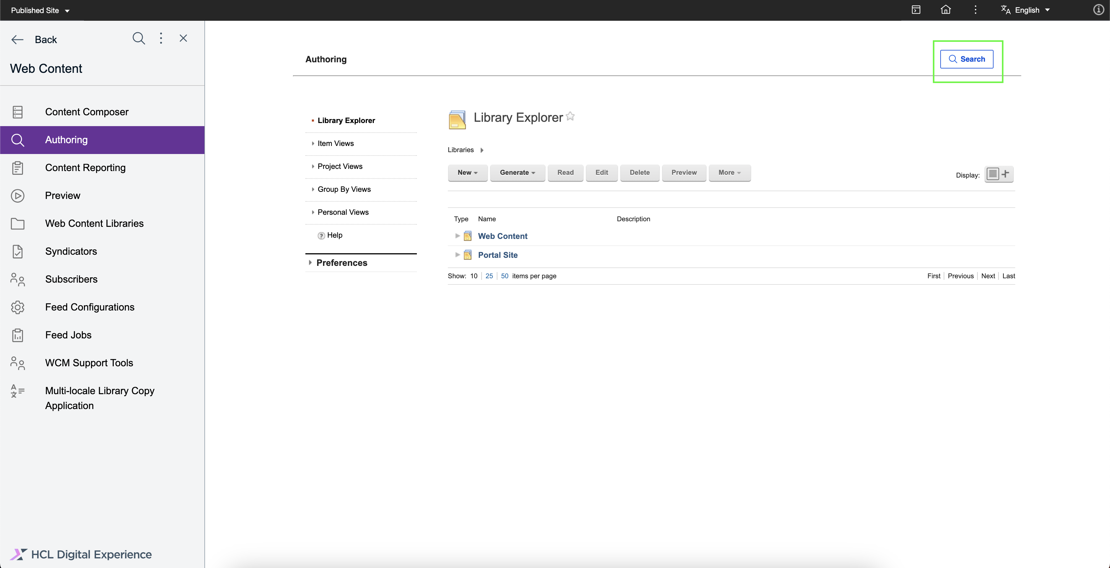

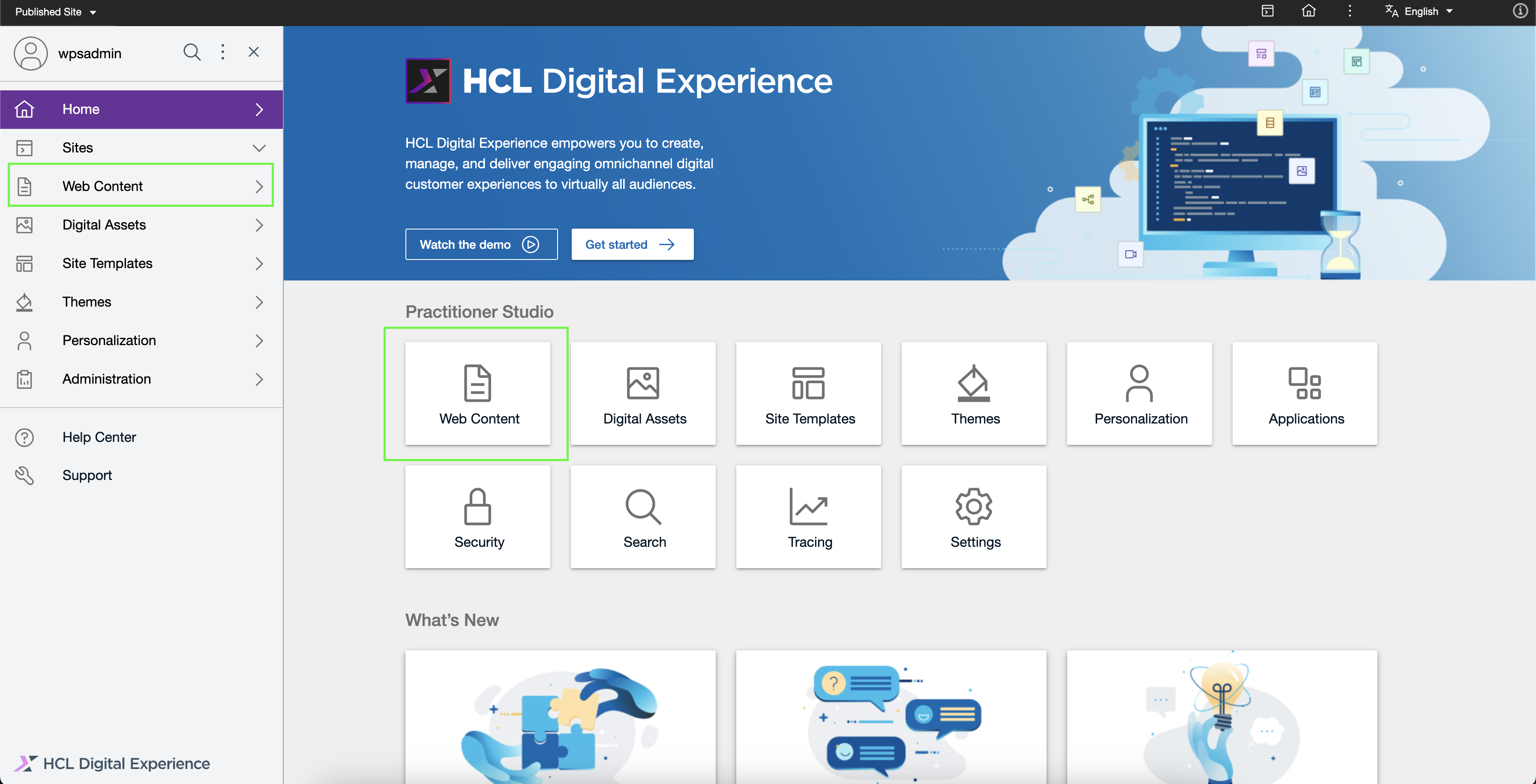

Log in to your HCL DX 9.5 platform then select Web Content from the side navigation panel. Alternatively, you can click the Web Content card from the Practitioner Studio homepage.
In the side navigation panel, select Authoring.
Click Search on the upper-right corner of the Authoring page. This will open the Search V2 Authoring dialog.

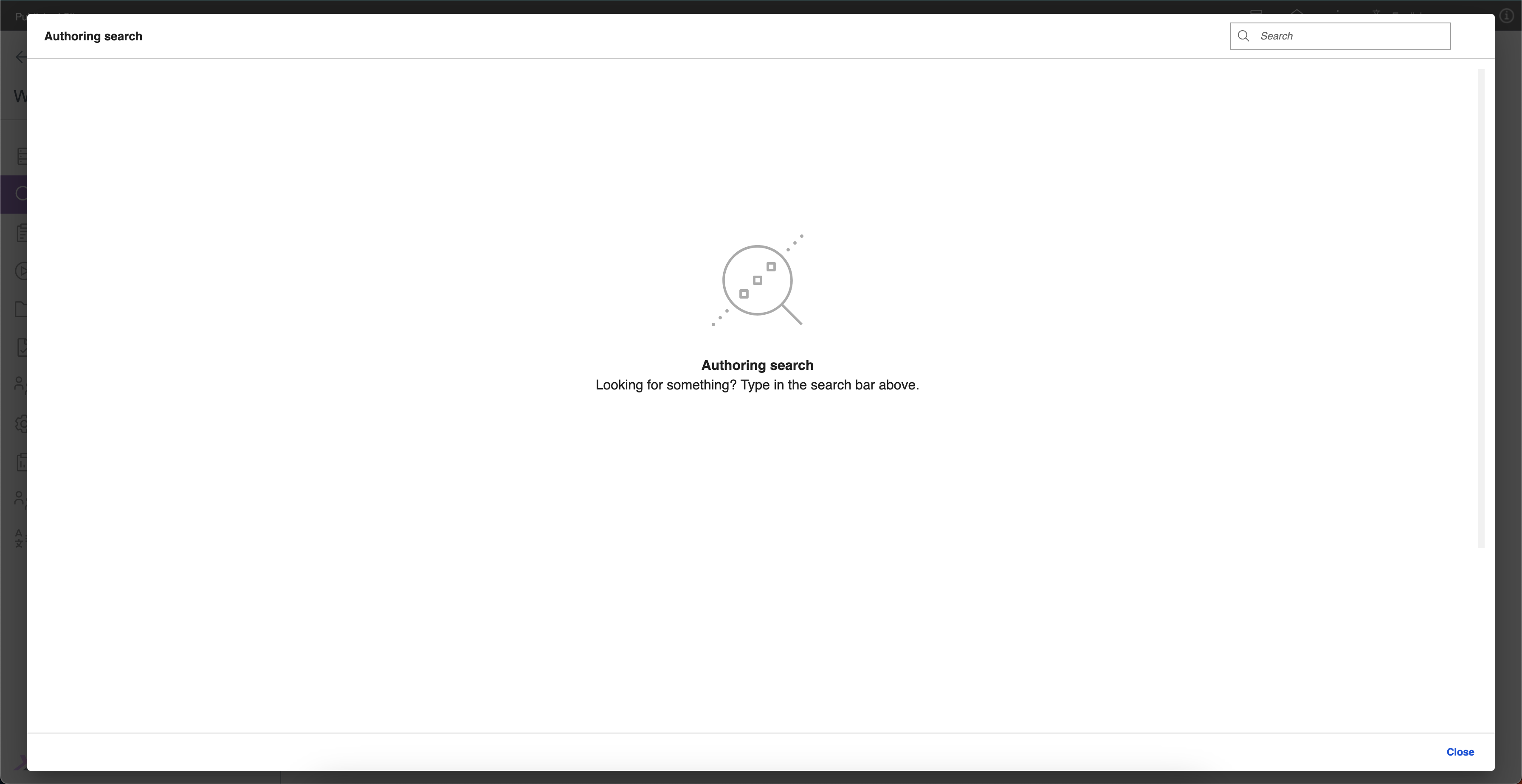

See the Search V2 Authoring interface.

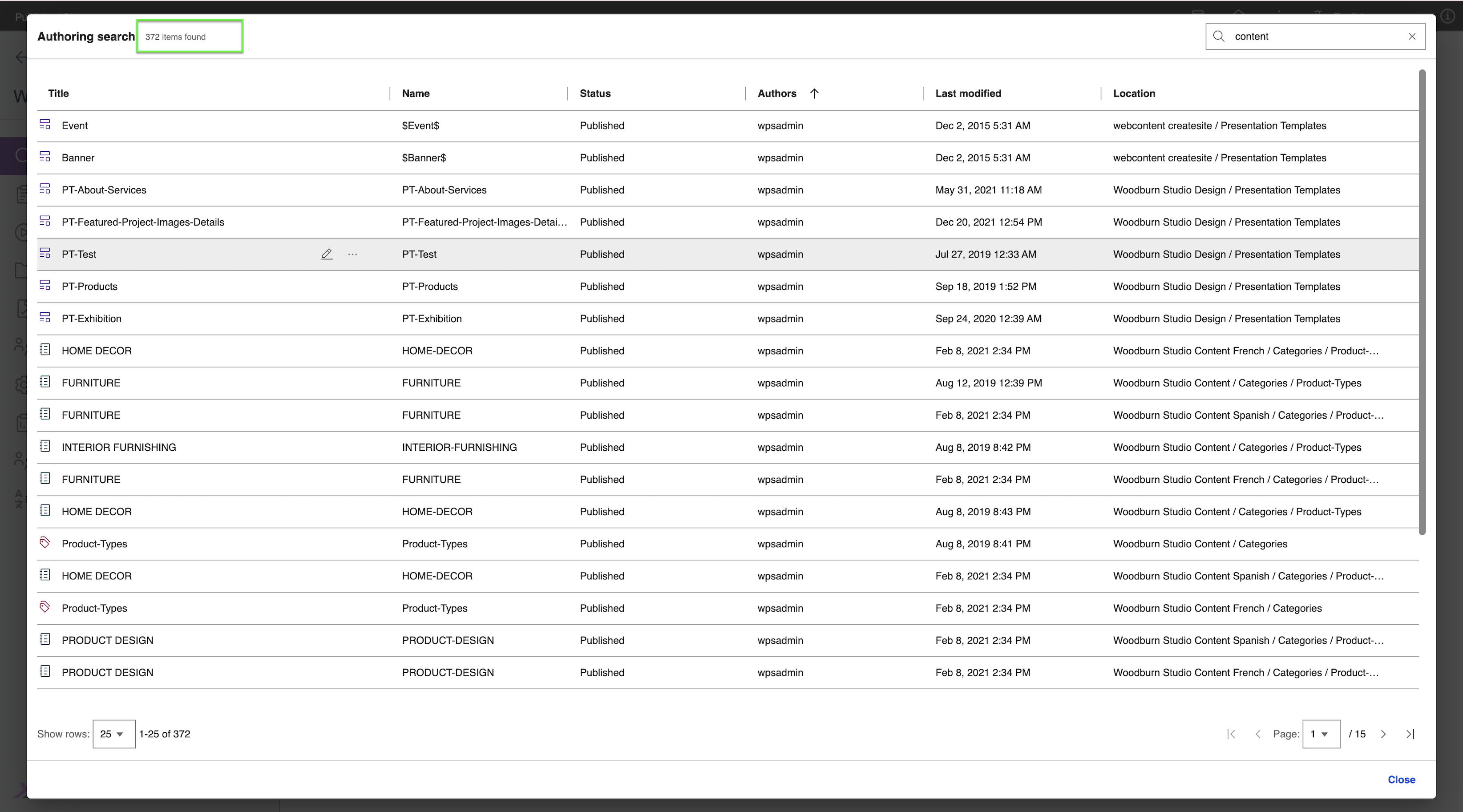

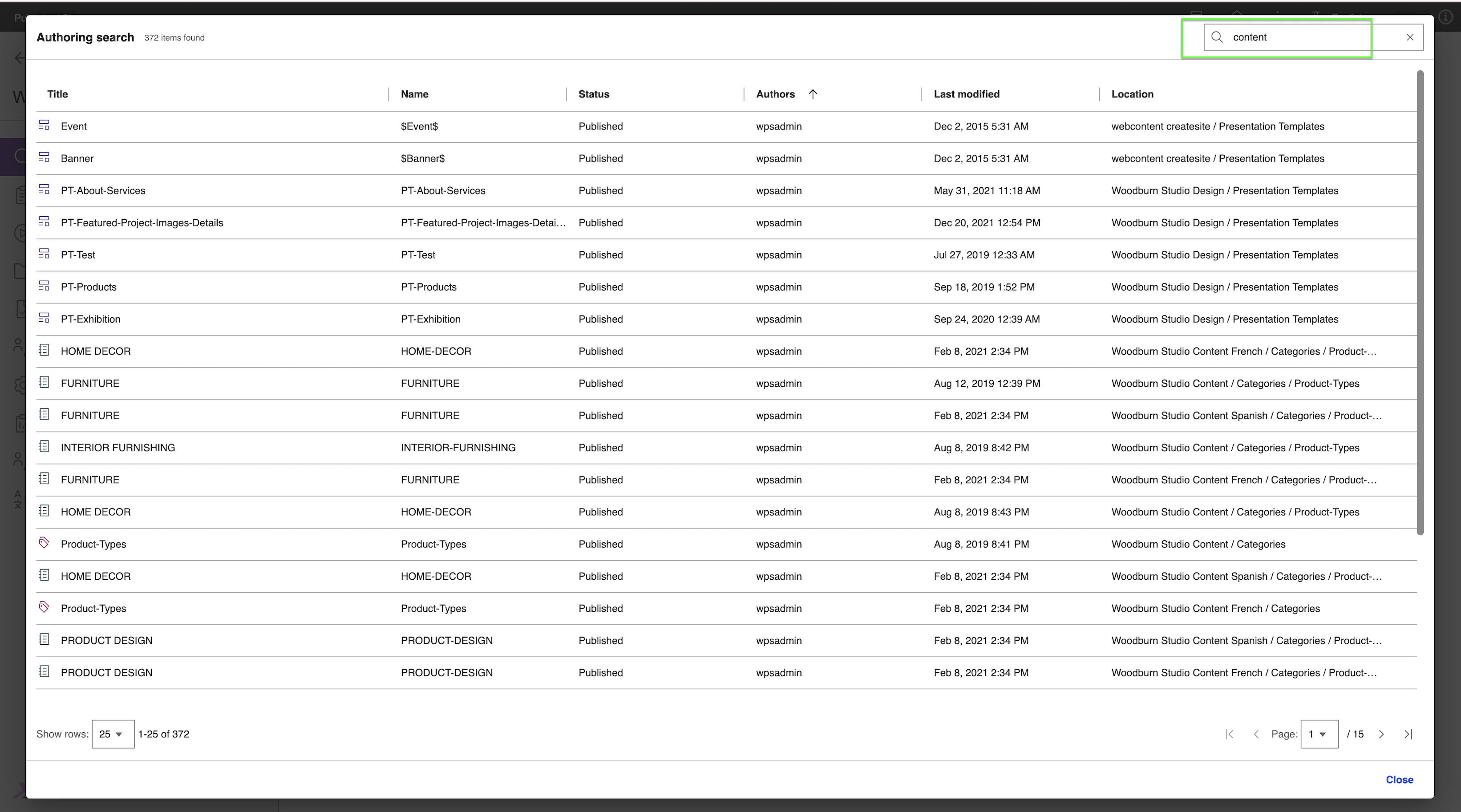

In the Search V2 Authoring user interface, enter your search terms on the Search field, then press Enter. In the following example, the term "content" is searched.
View the search results generated. You can see the total number of search results in the upper-left corner of the dialog. In the following example, the term "content" generated 372 search results. Below the table of results, you can also see more detailed pagination information.

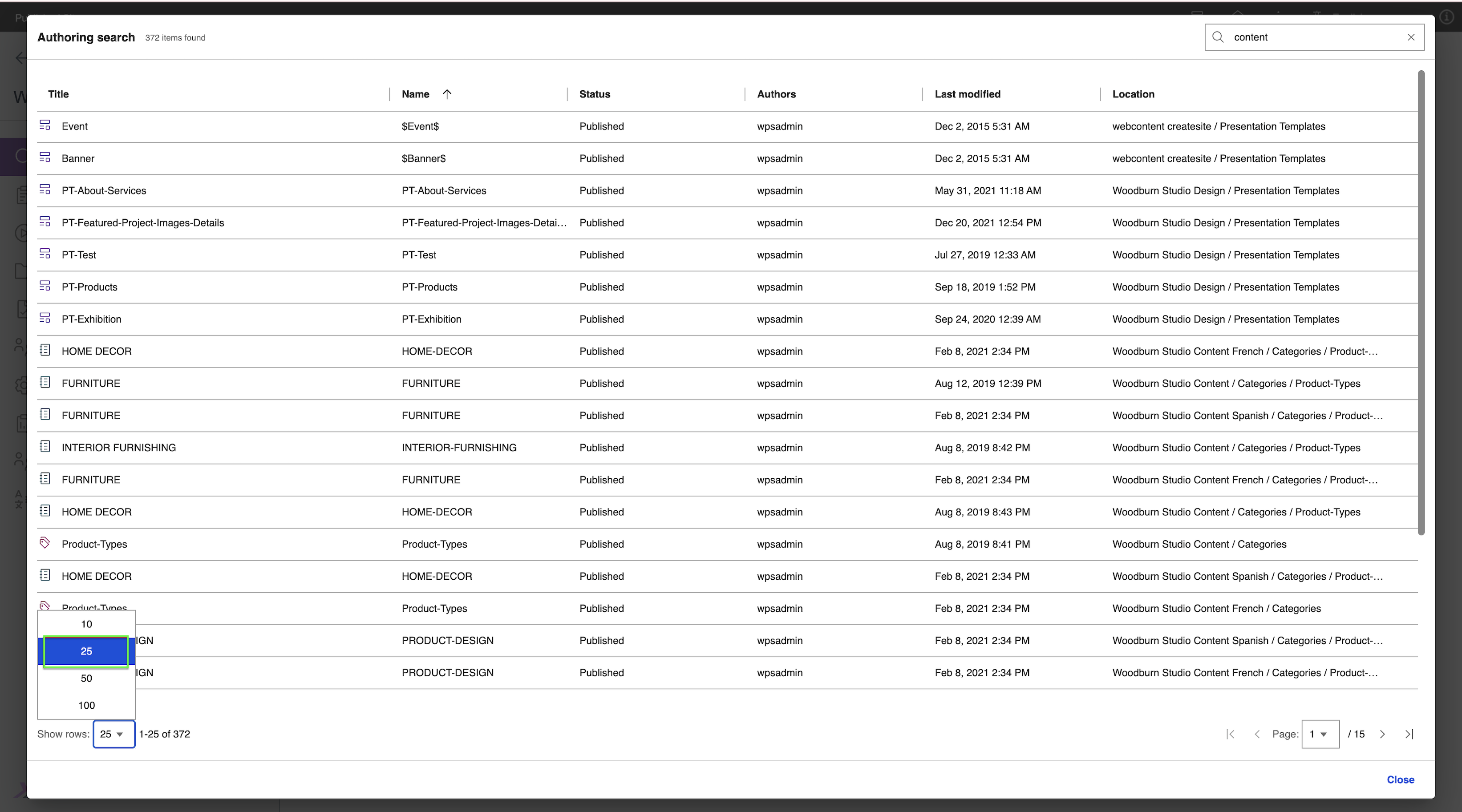

To navigate through the search results, adjust the page size and current page at the bottom of the page.

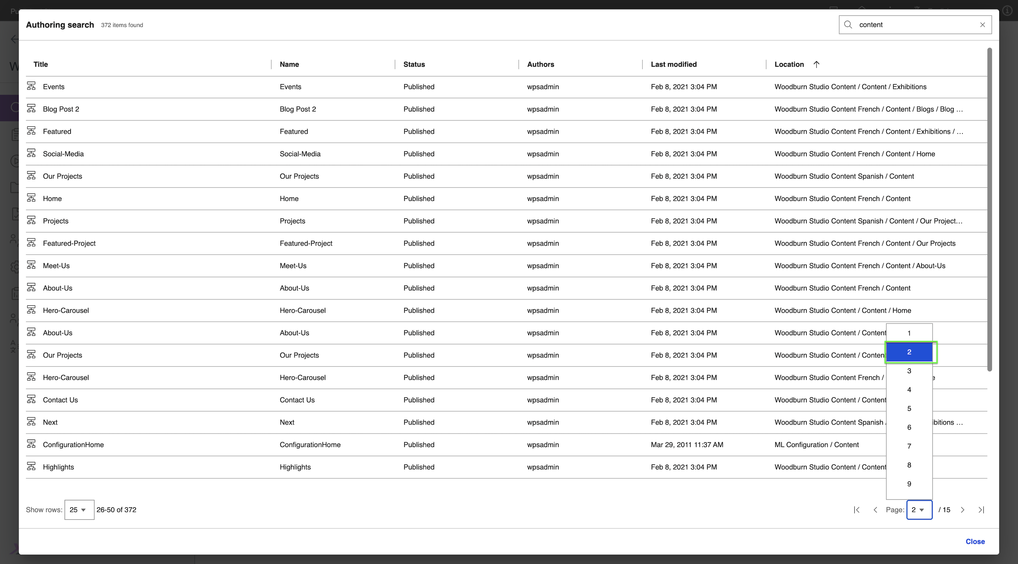

Click the Show rows: dropdown then select 25.
Click the dropdown with label Page: and select "2".

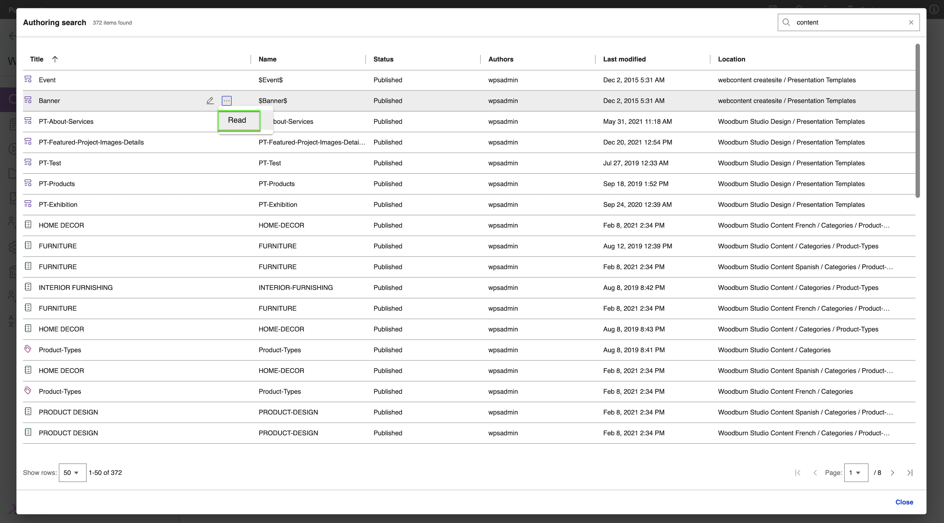

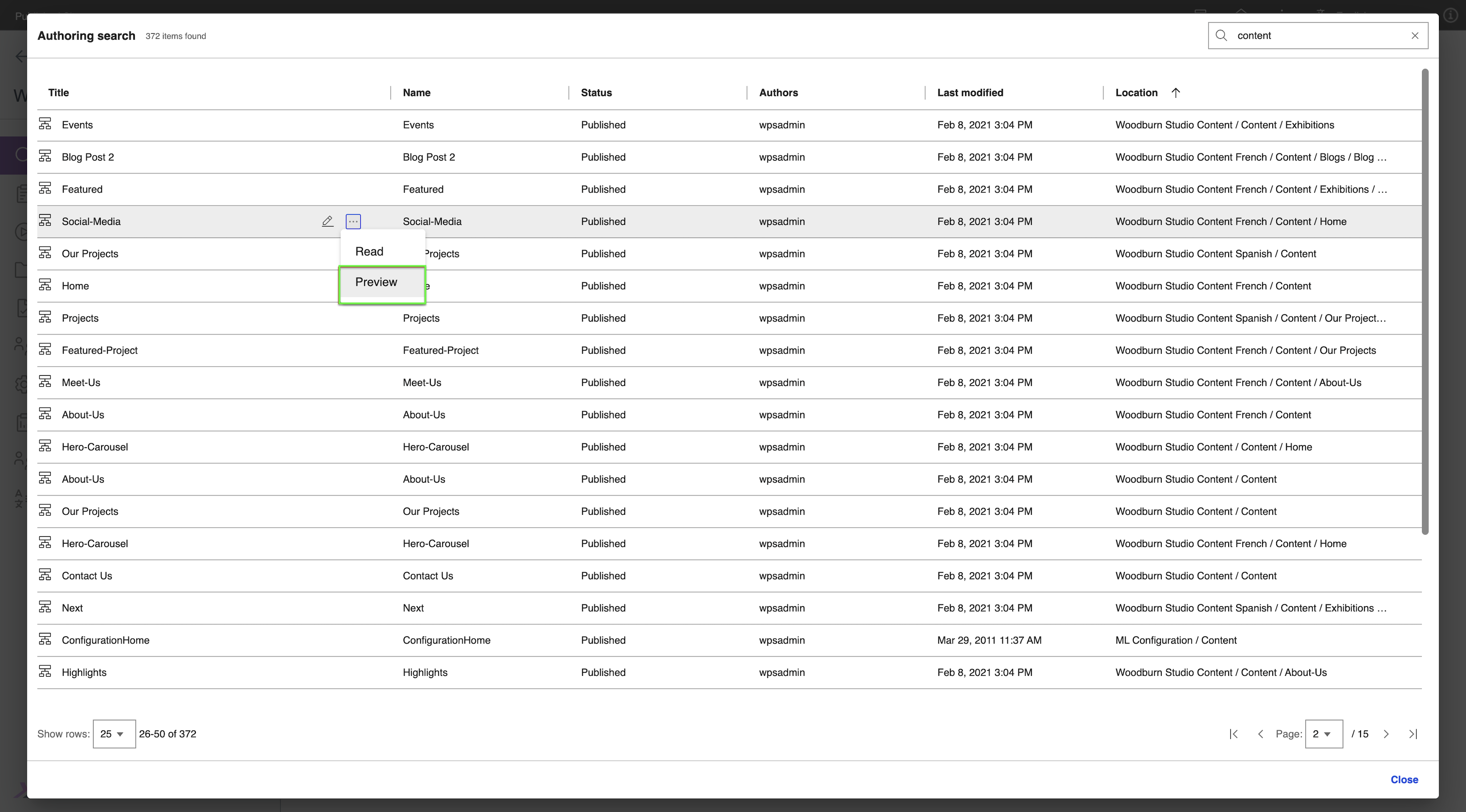

To see more actions for an item, hover over a result and click the More three-dot icon.
To open an item, hover over the result then click More > Read.
To preview an item in a new tab, hover over the result then click More > Preview.

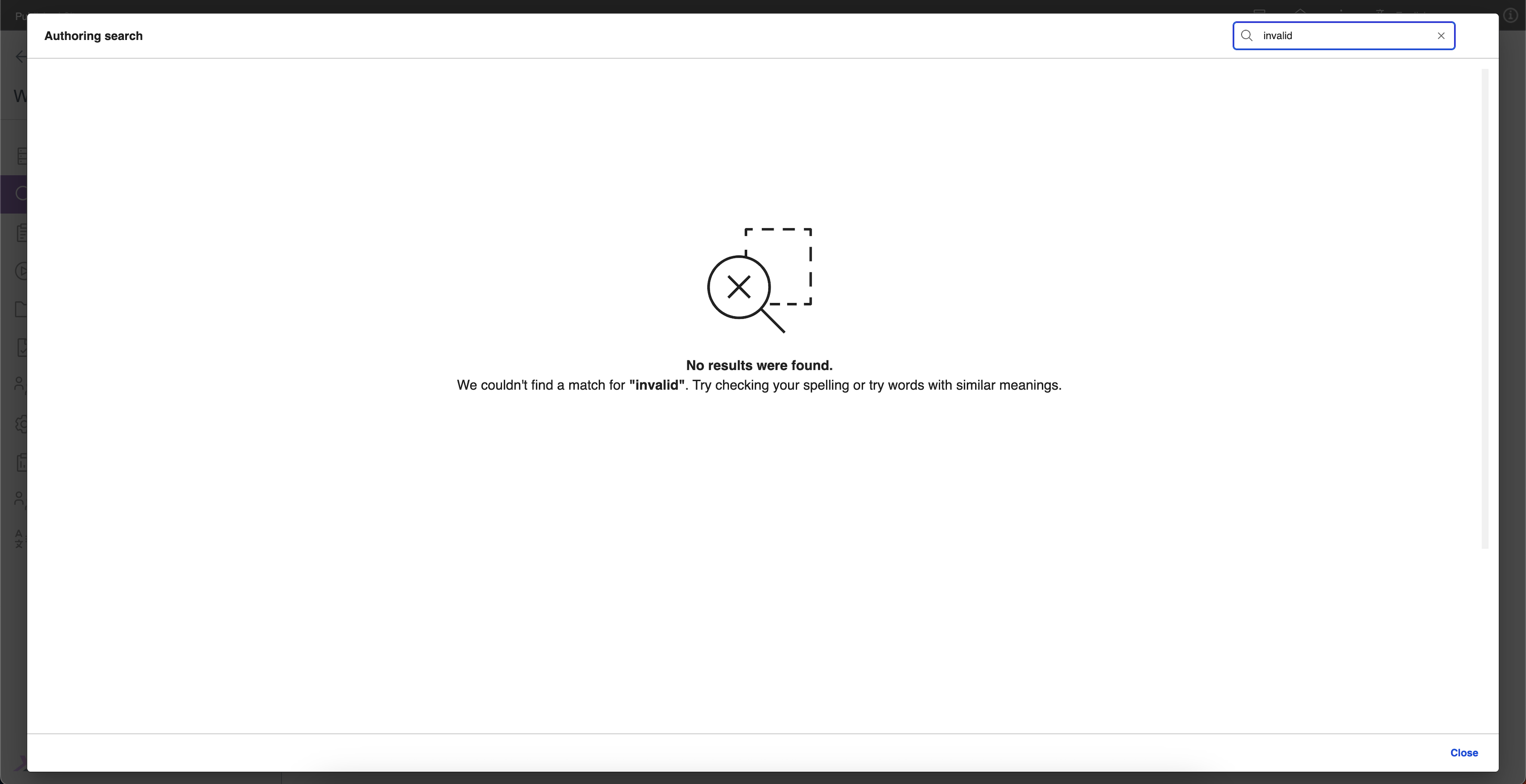

If the search term yields no results, the following message is displayed.

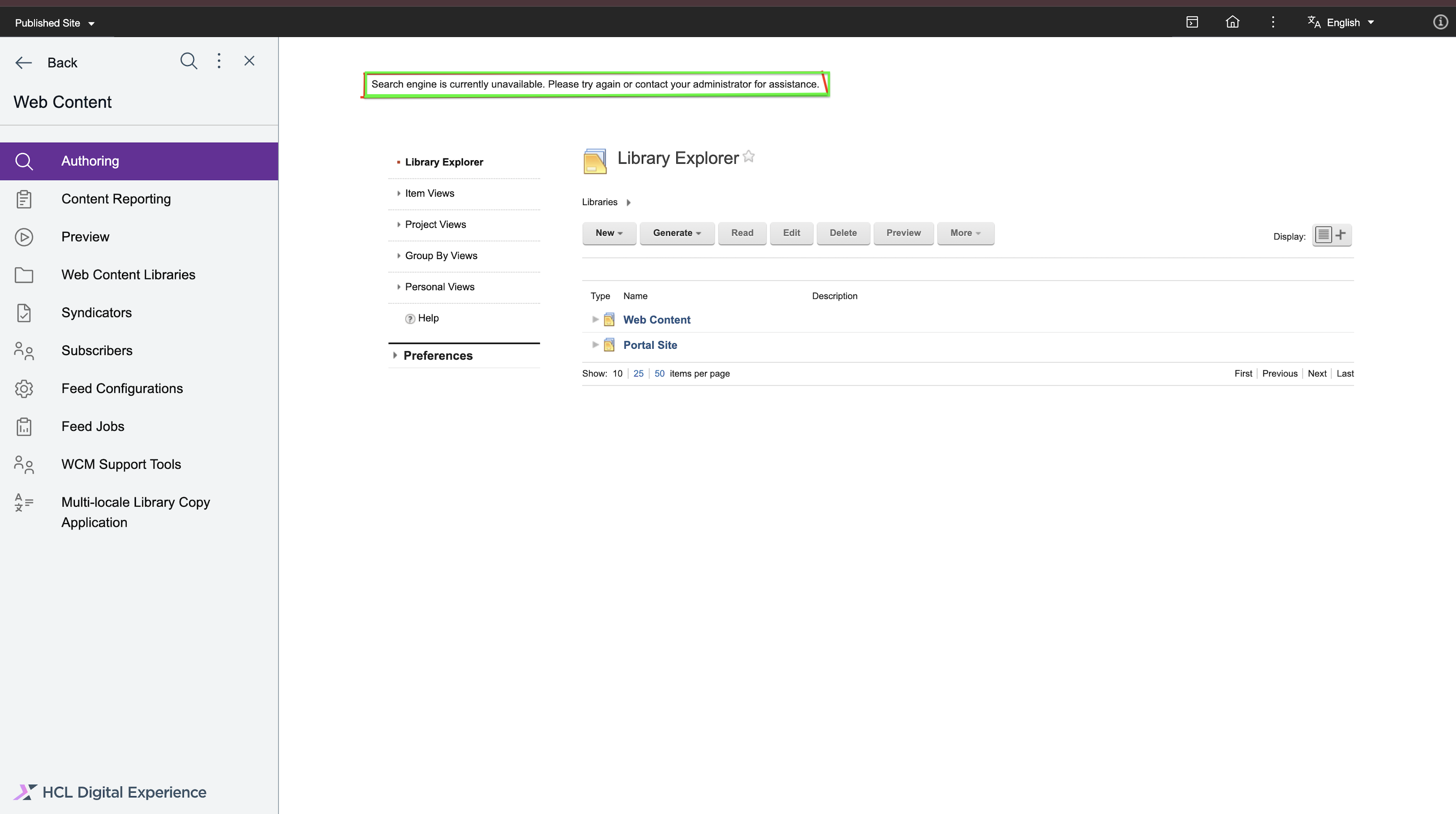

If the search engine is down or unavailable, the following message is displayed.
