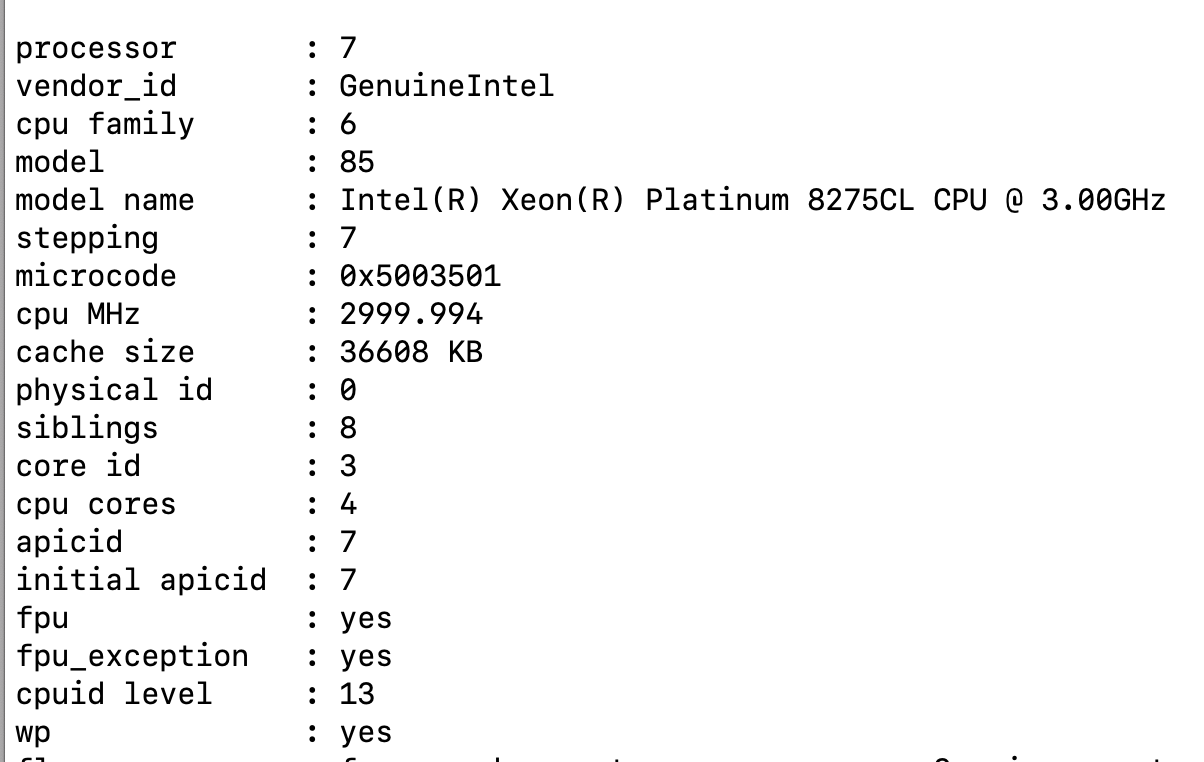

[Small Configuration - Single node] - [c5.2xlarge]
- Information

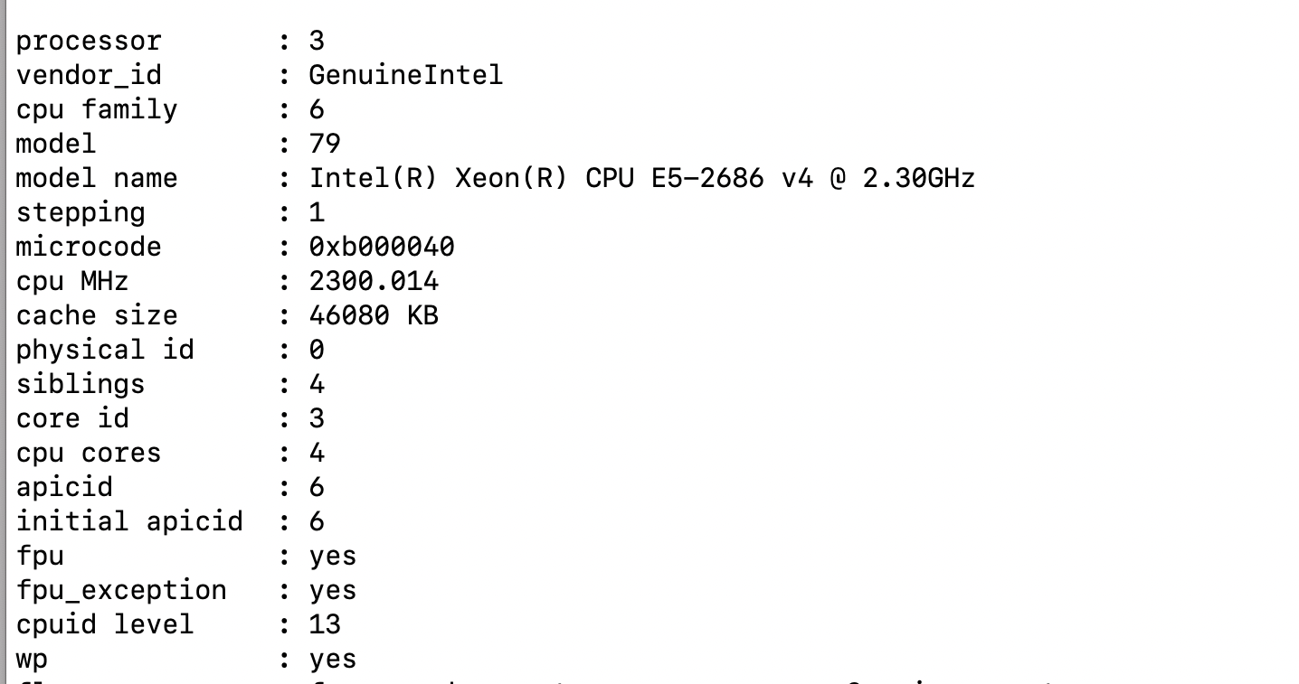

- Processor details

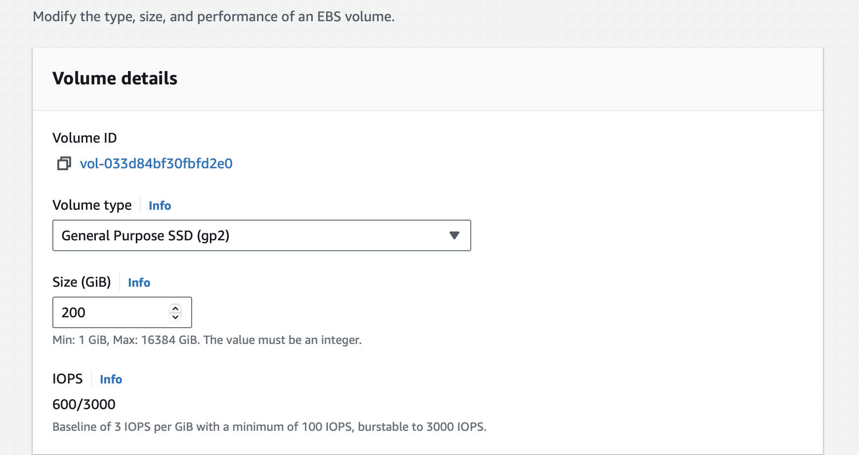

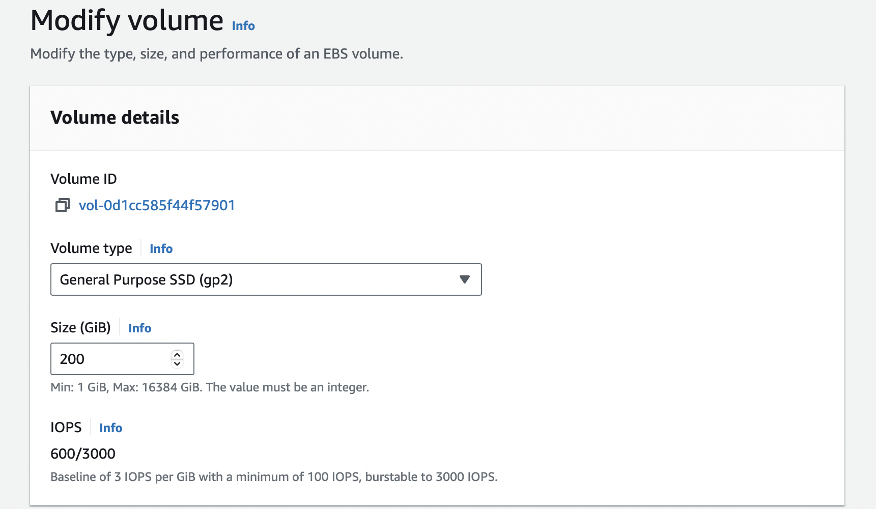

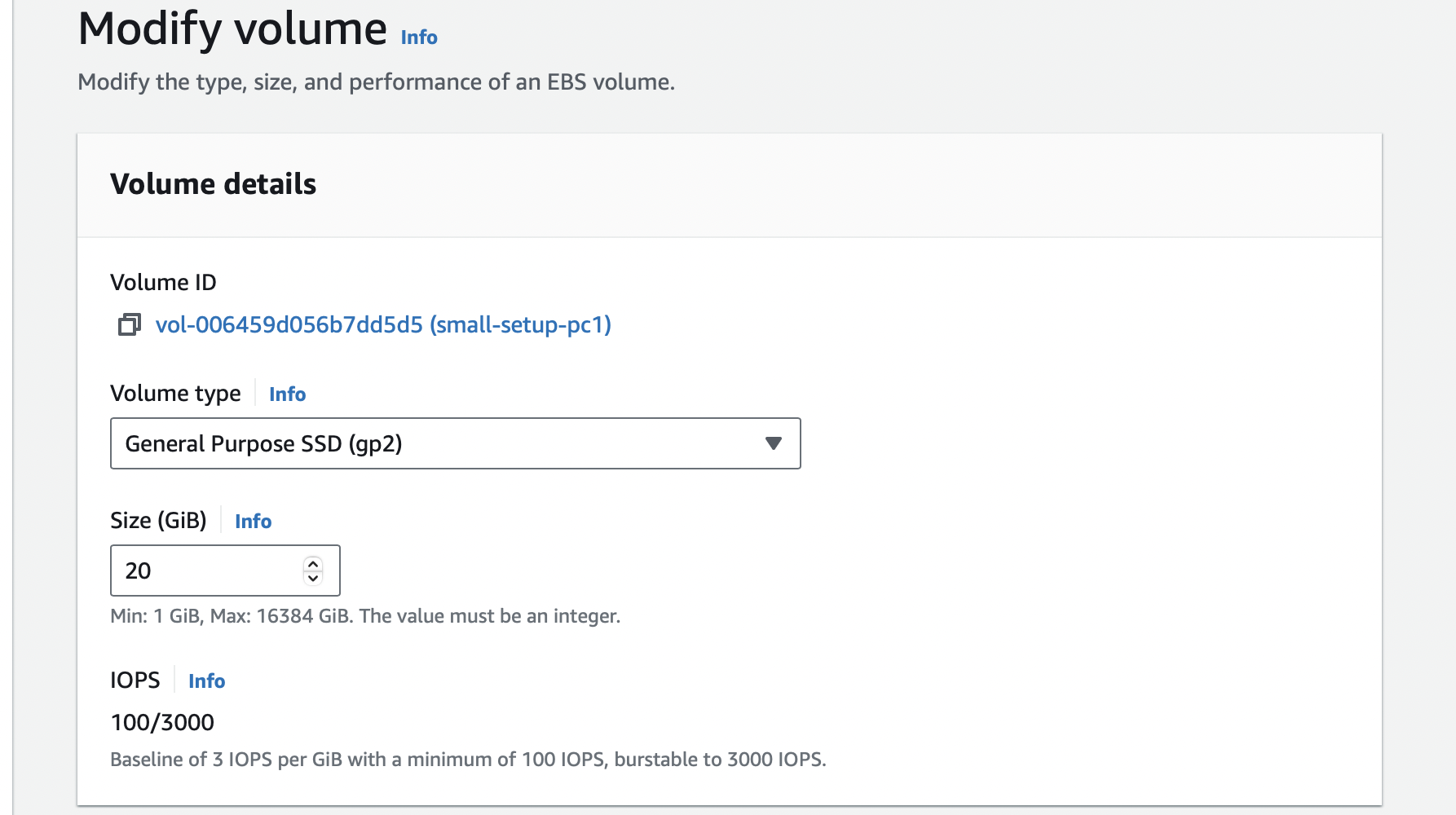

- Volume details

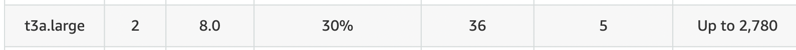

Remote DB2 - [t3a.large]
Processor details
Volume details

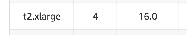

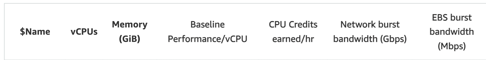

JMeter instance - [t2.xlarge]
To run the tests, a distributed AWS/JMeter agents setup consisting of one primary and two subordinates was used.
Processor details
Network details
