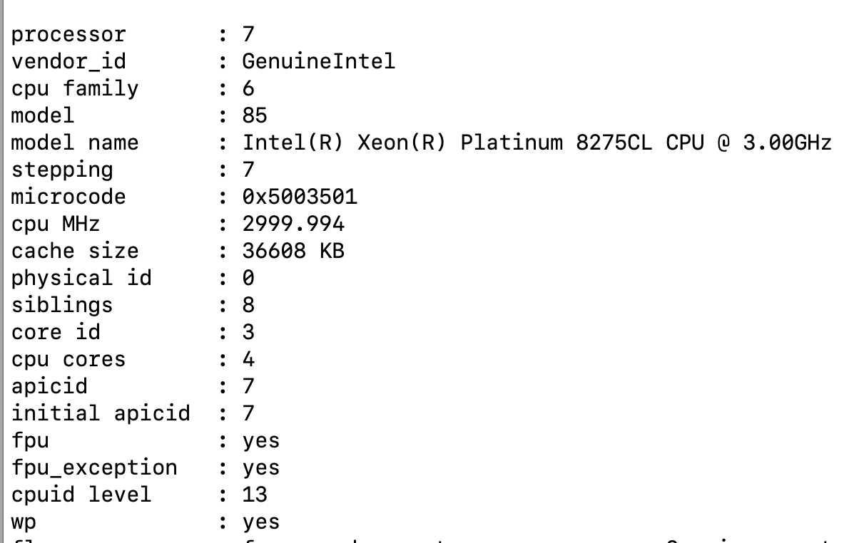

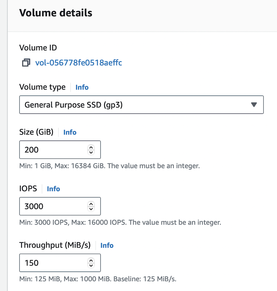

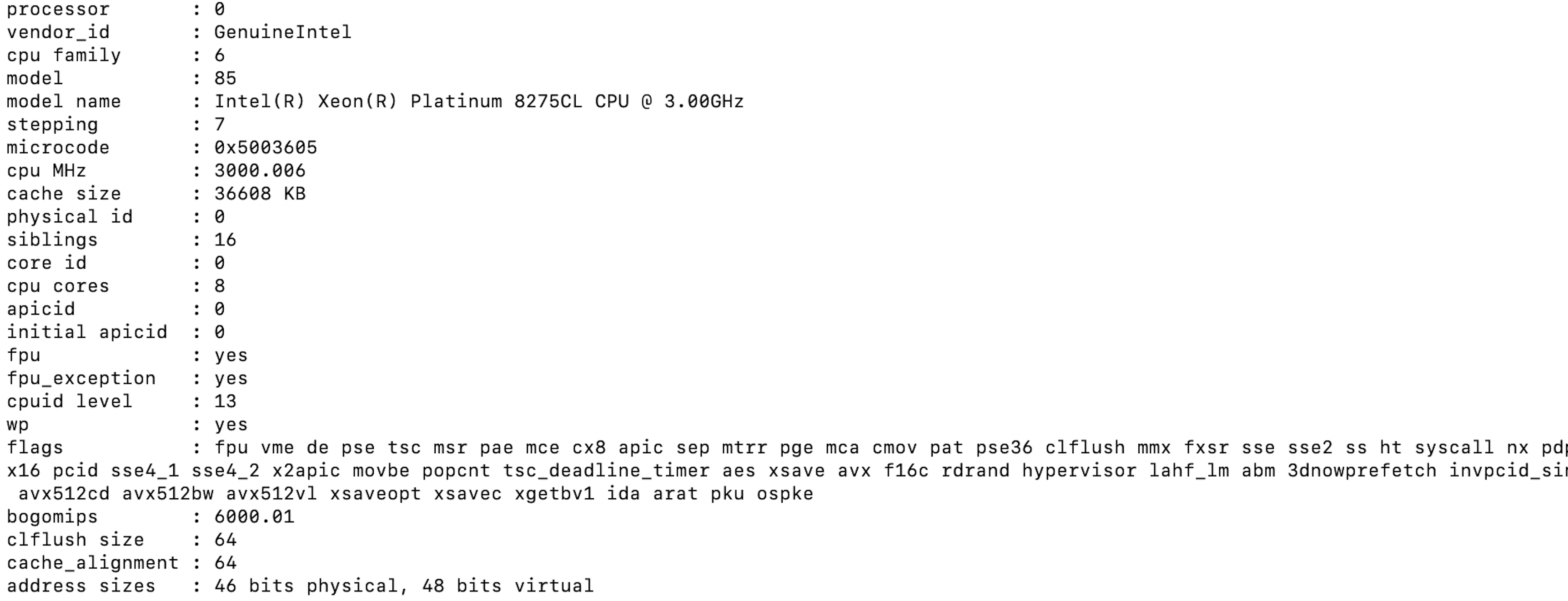

In AWS/Native Kubernetes, the tests are executed in EC2 instances with one master (c5.xlarge) and four worker nodes (c5.4xlarge).
The tests used a remote DB2 instance for the core database (c5.2xlarge).

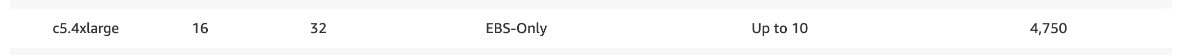

The tests started with worker node type c5.2xlarge, then moved to c5.4xlarge after analyzing test results and observations.
c5.4xlarge

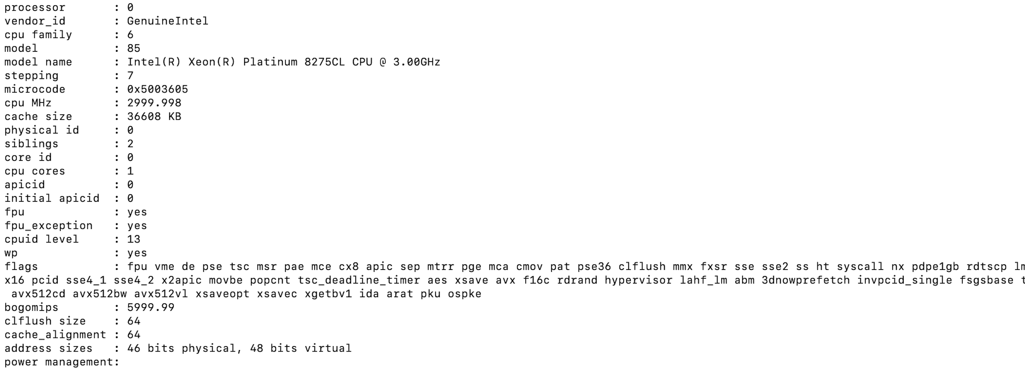

- Processor details

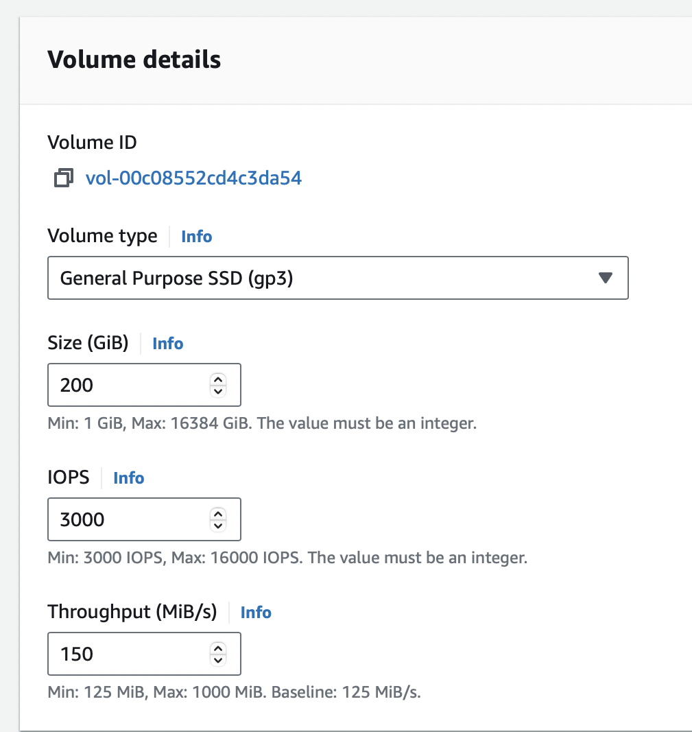

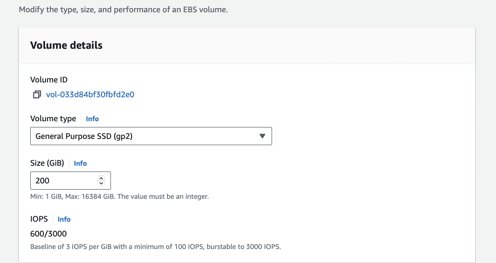

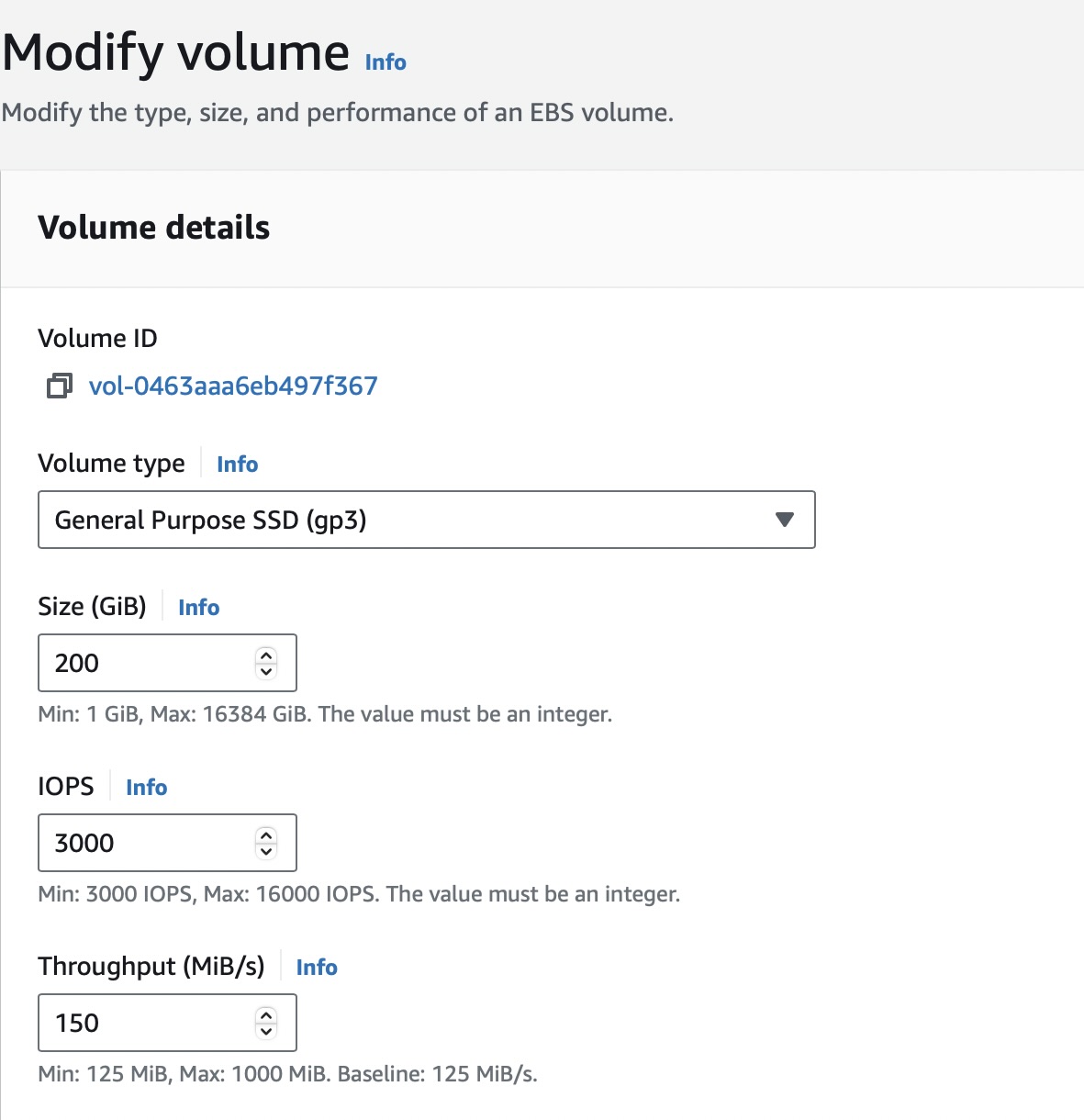

- Volume details

- Processor details
- Volume details

Processor details
Volume details

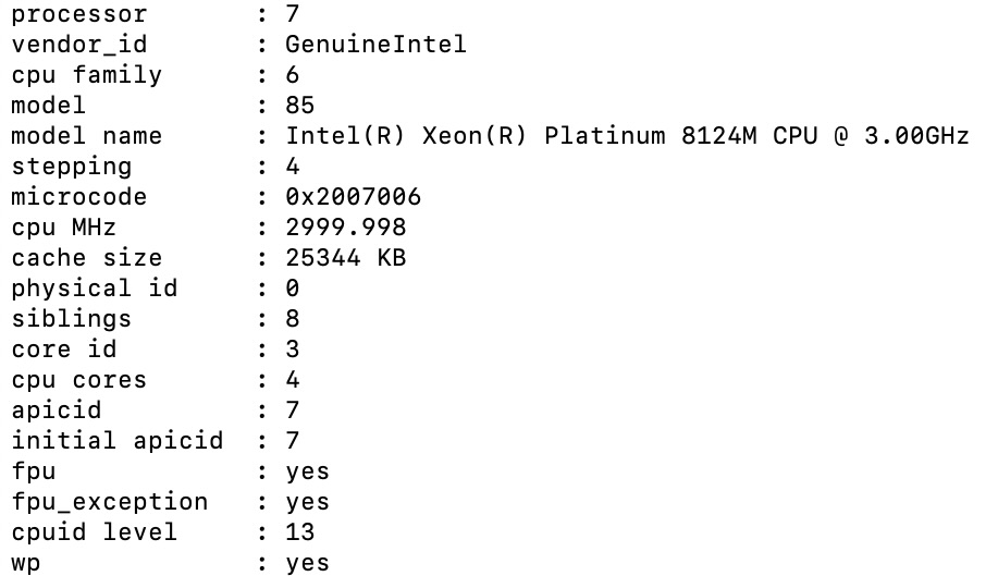

Processor details
Volume details
Processor details
Volume details

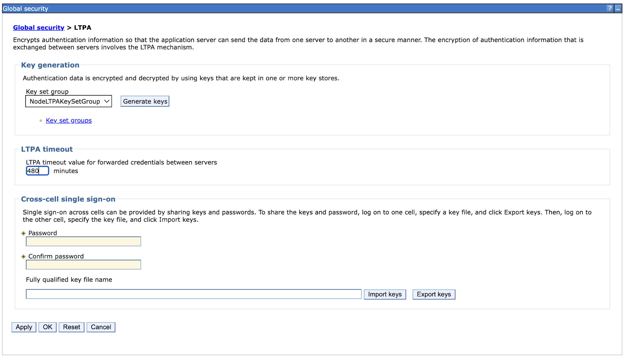

LTPA token timeout increased from 120 minutes to 480 minutes for rendering tests execution.

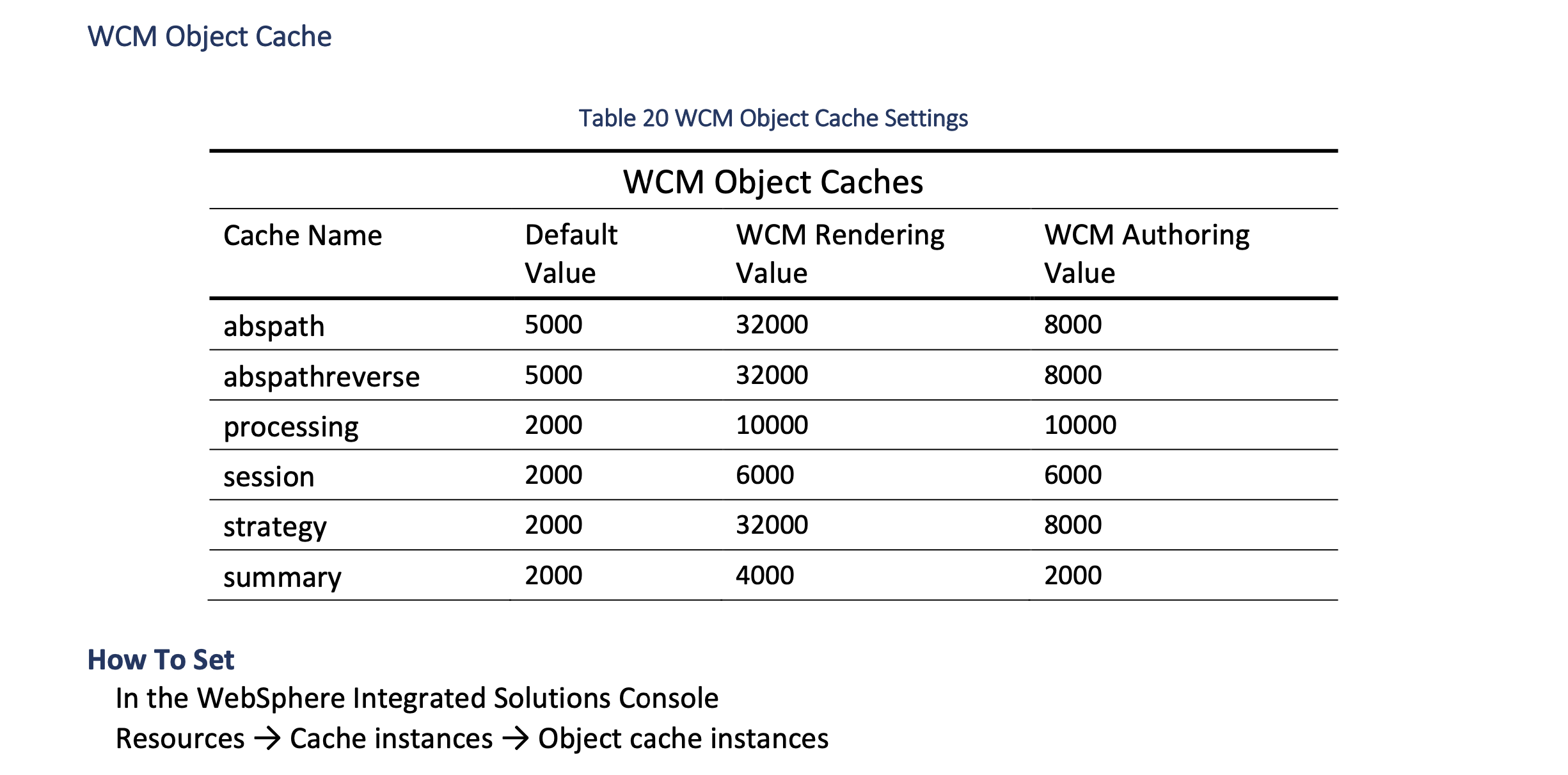

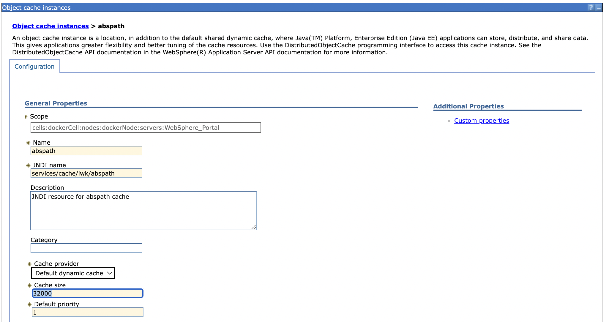

WCM object cache for rendering is updated as per DX Core tuning guide.
Updated abspath, abspathreverse, processing, session, strategy, summary values, and WCM rendering values as per DX Core tuning guide.

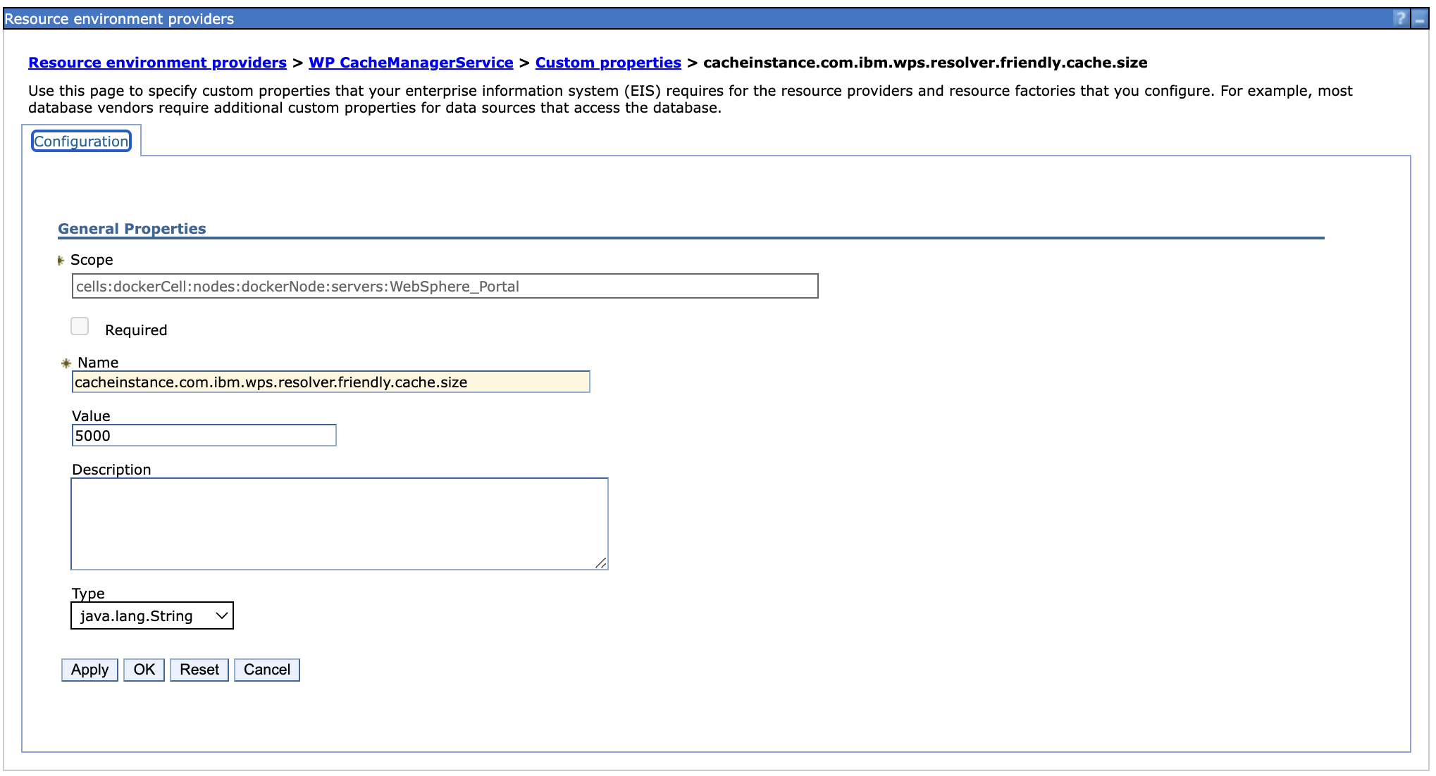

Added a new custom property under Resource environment providers > WP CacheManagerService > Custom properties > cacheinstance.com.ibm.wps.resolver.friendly.cache.size.

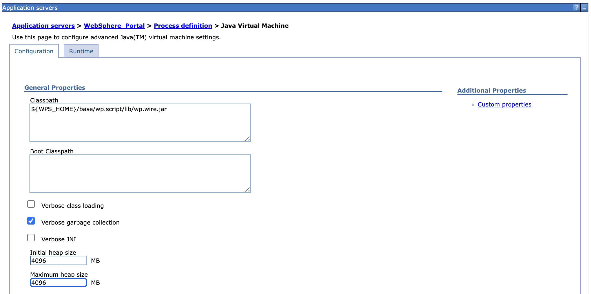

Adjusted JVM Heap size from 3584 to 4096 under Application servers > WebSphere_Portal > Process_definition > Java Virtual Machine.

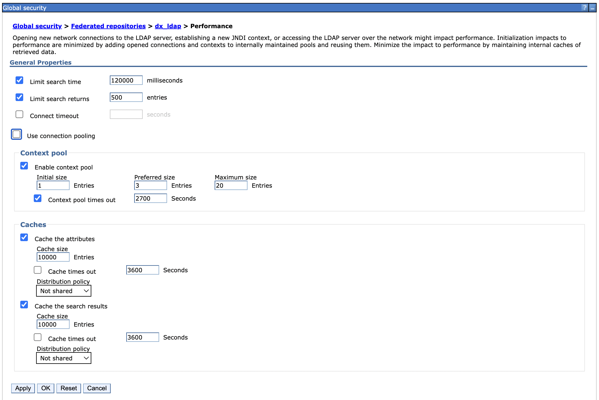

Set LDAP user cache attributes and search to 10000.

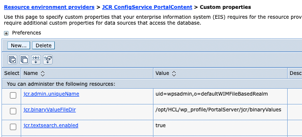

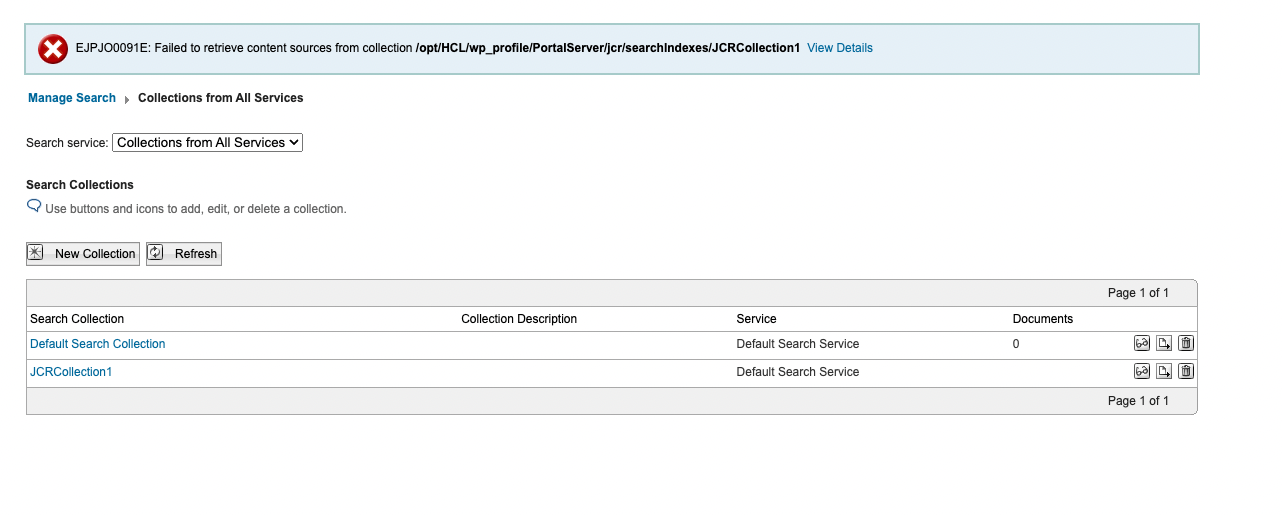

Disabled jcr.text.search under Resource environment providers > JCR ConfigService Portal Content > Custom properties because there is currently no authoring search functionality in these tests.
Deleted search collections in Portal > Administration > Search > Search collections (both JCRCollection1 and Default Search Collection).

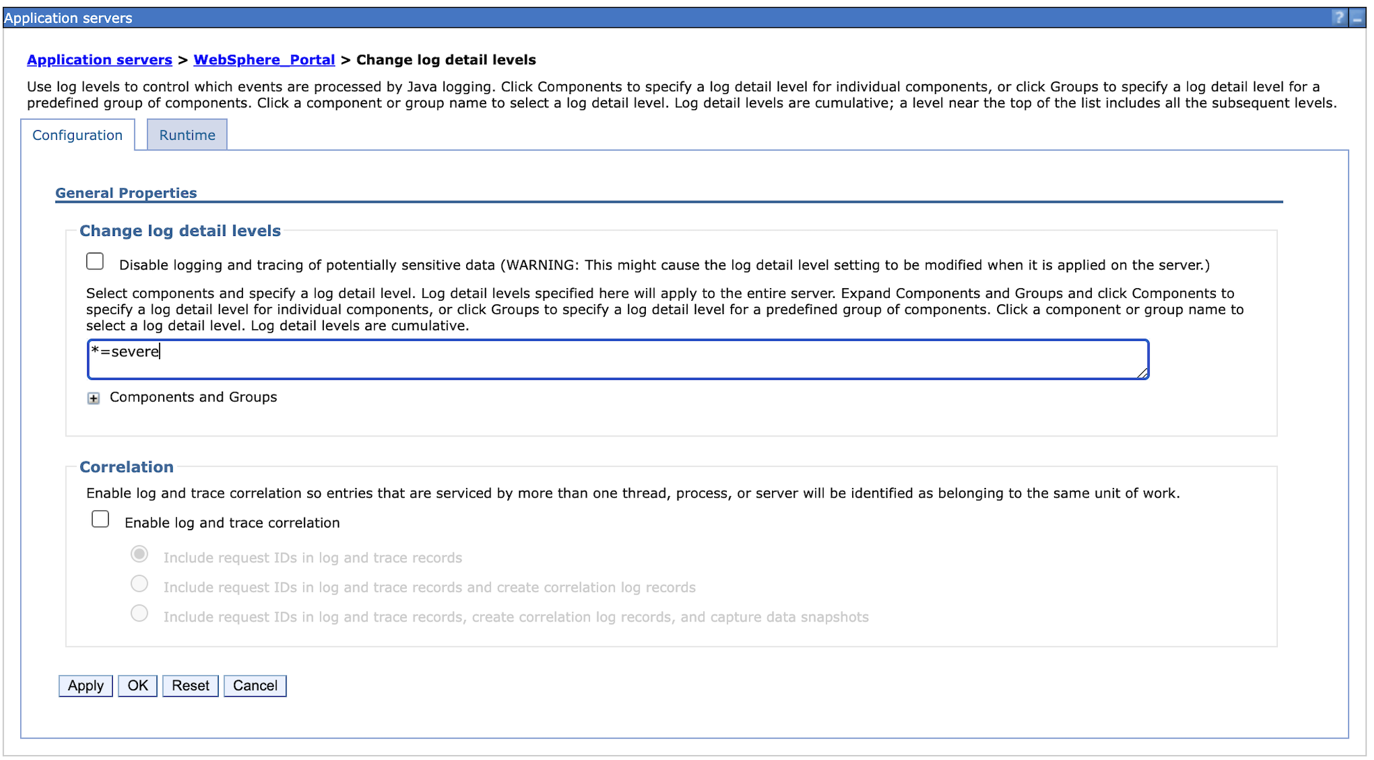

Logged level changes from info to severe in WAS for both configuration and run time.
