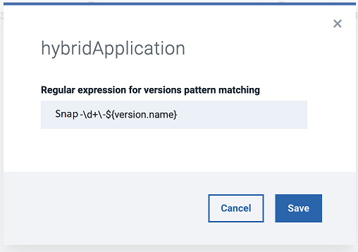

    • Regular expression matching: To perform the regular expression matching of CI and CD application versions, perform the following steps:

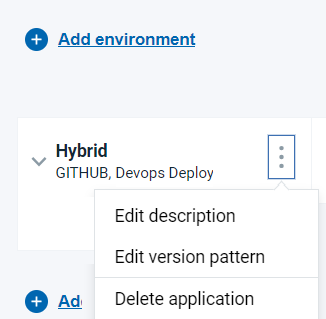

      1. On the Hybrid CI and CD pipeline, click , and then select Edit version pattern.
      2. On the hybridApplication window, perform any of the following actions to match the application versions in the CI application with the CD application.
        • Component version pattern matching: Add component version name for the CD application in the Regular expression for versions pattern matching field. Ensure that component version name of the CD application is same as the component version name of the job in the CI application.
        • Snapshot versions pattern matching: Add snapshot version name for the CD application in the Regular expression for versions pattern matching field. Ensure that snapshot version name of the CD application is same as the snapshot version name of the job in the CI application.
      3. Click Save.

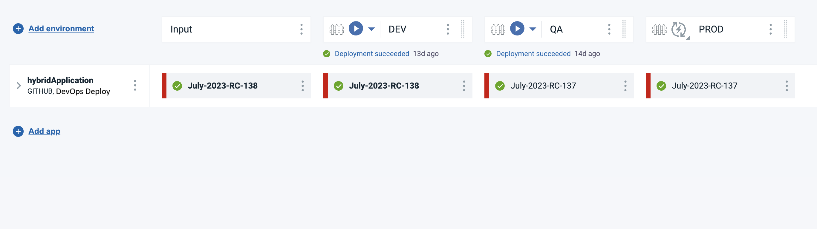

  11. The following image is an example of the hybrid CI and CD pipeline with DEV, QA, and PROD environments.
