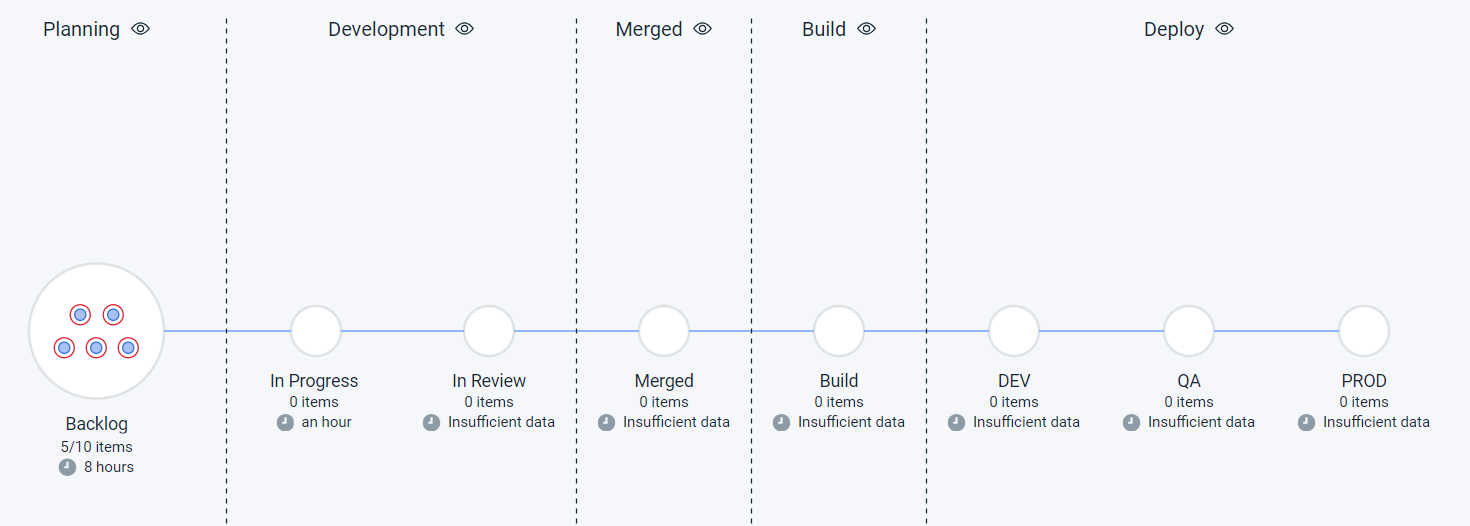

  1. Perform the following steps to configure the Phases and Stages in the value stream:
    1. On the Value Streams page, select the value stream that you created in Lesson 4: Creating the value stream.
    2. Click Edit value stream map.
    3. Modify the phases in the JSON file as shown in the following example:
        "phases": [
            "name": "Planning",
            "description": "",
            "stages": [
                "name": "Backlog",
                "query": "(issue.status=\"To Do\")",
                "description": "",
                "targets": [
                  "In Progress"
                "wipLimit": 10,
                "showAlerts": true,
                "showSpeed": true,
                "gates": null
            "name": "Development",
            "description": "",
            "stages": [
                "name": "In Progress",
                "query": "(issue.status=\"In Progress\") AND (pr.status!=\"open\")",
                "description": "",
                "targets": [
                  "In Review"
                "wipLimit": null,
                "showAlerts": true,
                "showSpeed": true,
                "gates": null
                "name": "In Review",
                "query": "(issue.status=\"In Review\") AND (pr.status=\"open\")",
                "description": "",
                "targets": [
                  "Merged"
                "wipLimit": null,
                "showAlerts": true,
                "showSpeed": true,
                "gates": null
            "name": "Merged",
            "description": "",
            "stages": [
                "name": "Merged",
                "query": "(issue.status=\"Done\") AND (pr.status=\"merged\") AND build.status!=success AND deployment.env!=DEV",
                "description": "",
                "targets": [
                  "Build"
                "wipLimit": null,
                "showAlerts": true,
                "showSpeed": true,
                "gates": null
            "name": "Build",
            "description": "",
            "stages": [
                "name": "Build",
                "query": "(issue.status=\"Done\") AND (pr.status=\"merged\") AND build.status=success AND deployment.env!=DEV",
                "description": "",
                "targets": [
                  "DEV"
                "wipLimit": null,
                "showAlerts": true,
                "showSpeed": true,
                "gates": null
            "name": "Deploy",
            "description": "",
            "stages": [
                "name": "DEV",
                "query": "(issue.status=\"Done\") AND (pr.status=\"merged\") AND build.status=success AND deployment.env = 'DEV' AND deployment.env != 'QA'",
                "description": "",
                "targets": [
                  "QA"
                "wipLimit": null,
                "showAlerts": true,
                "showSpeed": true,
                "gates": null
                "name": "QA",
                "query": "(issue.status=\"Done\") AND (pr.status=\"merged\") AND build.status=success AND deployment.env = 'QA' AND deployment.env != 'PROD'",
                "description": "",
                "targets": [
                  "PROD"
                "wipLimit": null,
                "showAlerts": true,
                "showSpeed": true,
                "gates": null
                "name": "PROD",
                "query": "(issue.status=\"Done\") AND (pr.status=\"merged\") AND build.status=success AND deployment.env = 'PROD' AND deployment.status =success",
                "description": "",
                "targets": [],
                "wipLimit": null,
                "showAlerts": true,
                "showSpeed": true,
                "gates": null
    4. Click Save.
      The value stream page displays the Phases and Stages for the integration.
