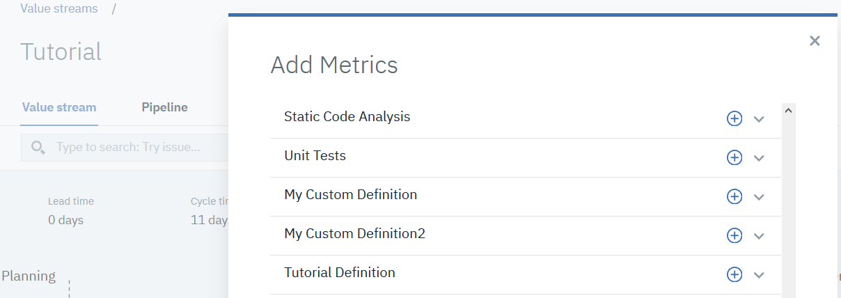

In addition to dashboards, metric data can be added to value streams. To see how this works, open a value stream and make sure that the Metric bar is displayed. Next, click Add a metric, , and then select the Tutorial Definition chart. The chart is displayed on the value stream's metric bar. If you want to see meaningful data in the metric bar chart, add the tutorial metric definition to the value stream JSON file.
Figure 3. Adding charts to value streams
