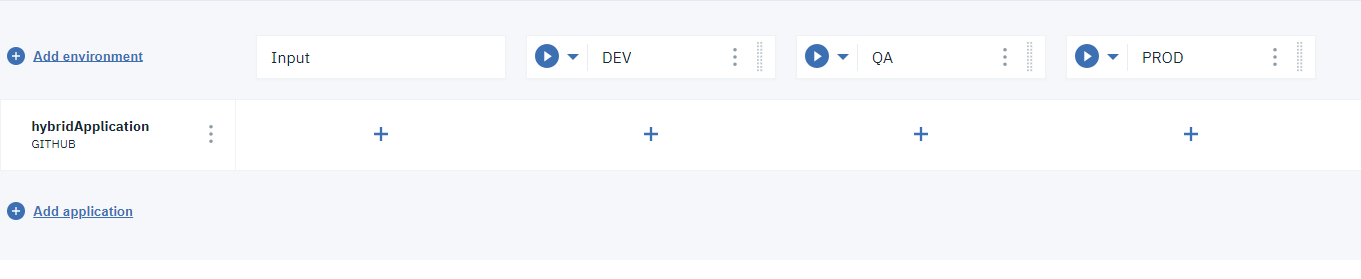

  2. To add a CI application to the pipeline, perform the following steps:
    1. To add the CI application, click Add button Add application
    2. On the Add apps - Choose the apps window, in the Managed by list, select a CI application.
    3. In the Application name field, enter a name for the application.
    4. Click Save.
    5. Under the Input environment, click Add button to open the Create version window.
    6. In the Create version window, select the required job from the list.
    7. Click Save.
      You have successfully added a CI application to the pipeline.
    8. In the CI application, run the build job selected in step 2.f.
      You can see the build number under INPUT, after the build is successful in the CI application.

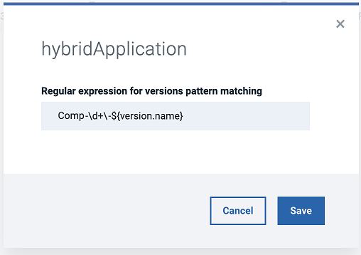

    • Regular expression matching: To perform the regular expression matching of CI and CD application versions, perform the following steps:

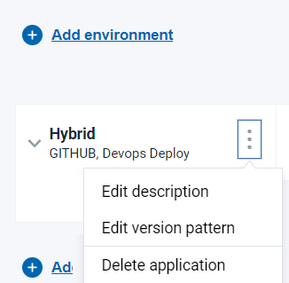

      1. On the Hybrid CI and CD pipeline, click , and then select Edit version pattern.
      2. On the hybridApplication window, perform any of the following actions to match the application versions in the CI application with the CD application.
        • Component version pattern matching: Add component version name for the CD application in the Regular expression for versions pattern matching field. Ensure that component version name of the CD application is same as the component version name of the job in the CI application.
        • Snapshot versions pattern matching: Add snapshot version name for the CD application in the Regular expression for versions pattern matching field. Ensure that snapshot version name of the CD application is same as the snapshot version name of the job in the CI application.
      3. Click Save.

  9. Optional: To edit the hybrid CI and CD application components already created on the pipeline, click stage context menu on the right side of the application and select Manage components to add and remove components of the application, Edit description to modify the description of the application in the selected pipeline, or Delete application to delete the application in the selected pipeline.

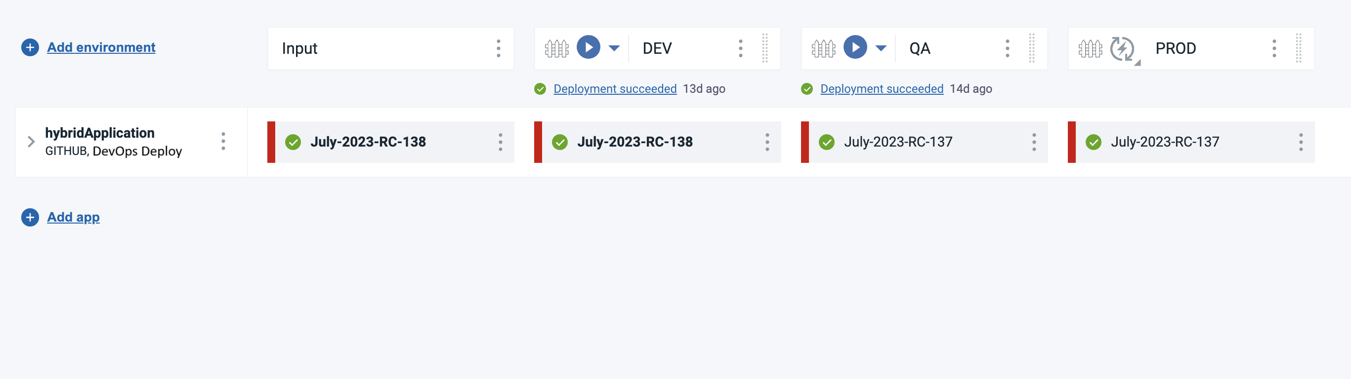

  11. The following image is an example of the hybrid CI and CD pipeline with DEV, QA, and PROD environments.
