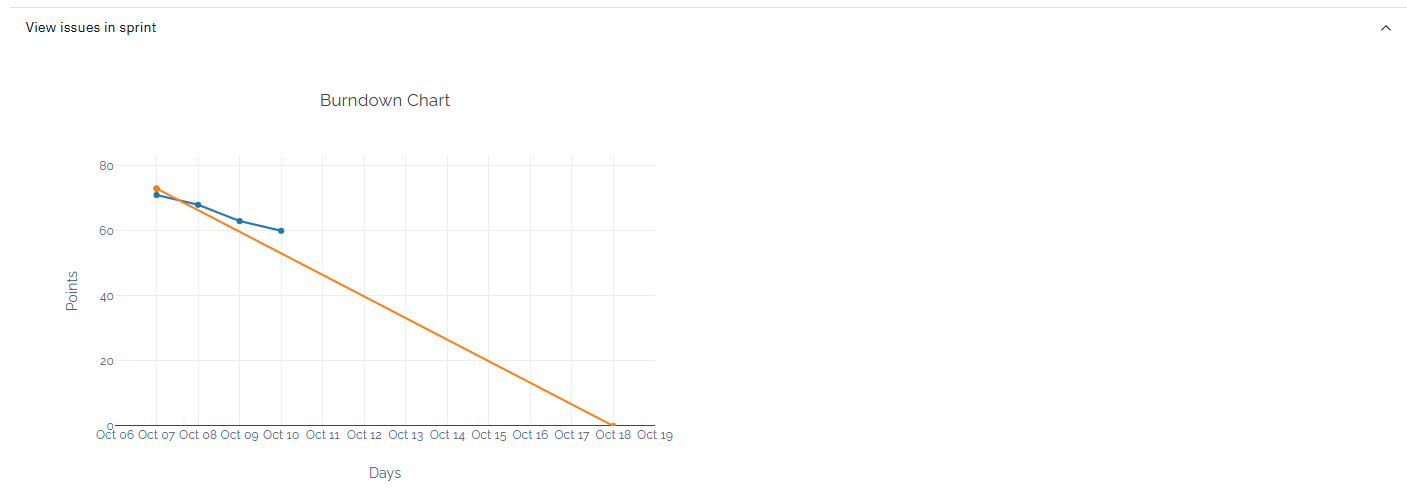

The Pointed vs Not Pointed and Planned vs Done bar charts are both interactive and you can hover over any areas of the chart to dynamically display values and plot tool icons providing extended functionality. You can click on different areas of the blue shaded bar chart above to display the stage name with number of related issues.
Click View issues in sprint bar to extend and display the burndown chart
and related issues for each stage of the value stream
The red vertical bar indicates alerts for issues such as over median time, no owner, and so on. You can click the issue link to open the ticket in a browser window to view detailed information for that item.
