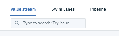

After the page refreshes, the dot will be displayed based on the query mentioned in helloWorld-vsm.json file.Note: You can also use DQL queries in search box available in value stream page to filter the required data.
