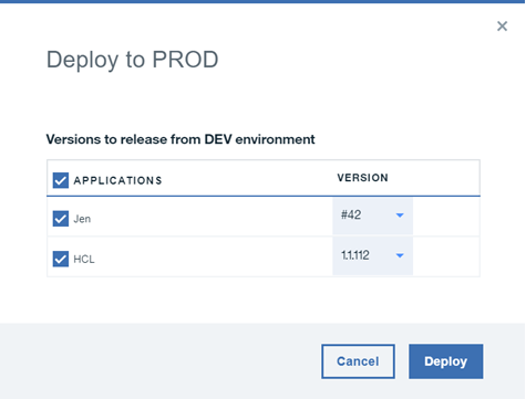

    1. If Deploy is selected as the default deployment mode, the Deploy modal window is displayed.
      Figure 1. Deploy modal window
      Deploy modal window

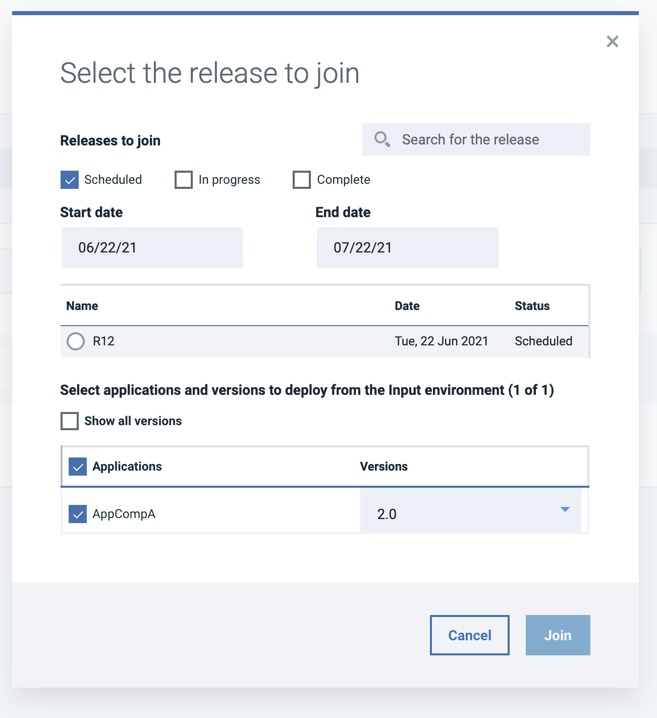

    2. If Join release is selected as the default deployment mode, the Join release modal window is displayed.
      Figure 2. Join release modal window
      Select the type of release from the below list to join,
      1. Scheduled release
      2. In progress
      3. Completed
      With the release selected, select the date range to filter the available releases.
      Select the required release Name from the list to join.
      Select the Application and the required Version then click Join to join the release.
      The below screen capture is an example for Scheduled release - R12 in the date range of 06/22/2021 to 07/22/2021 for the version 2.0 of application AppCompA. Join release modal window

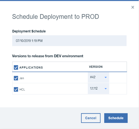

    3. If Schedule deployment is selected as the default deployment mode, the Schedule deployment modal window is displayed.
      Figure 3. Schedule deployment modal window

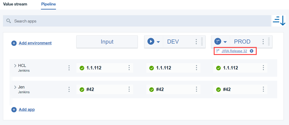

    After Join release is scheduled, the join release link appears below the PROD environment including the join release graphic and name. You can click the link to view the deployment plan page.
    Figure 4. Join release link
