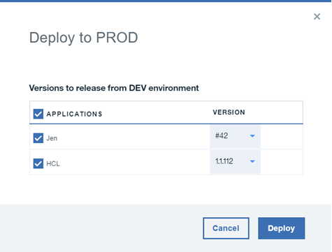

    1. If Deploy is selected as the default deployment mode, the Deploy modal window is displayed.
      Figure 1. Deploy modal window
      Deploy modal window

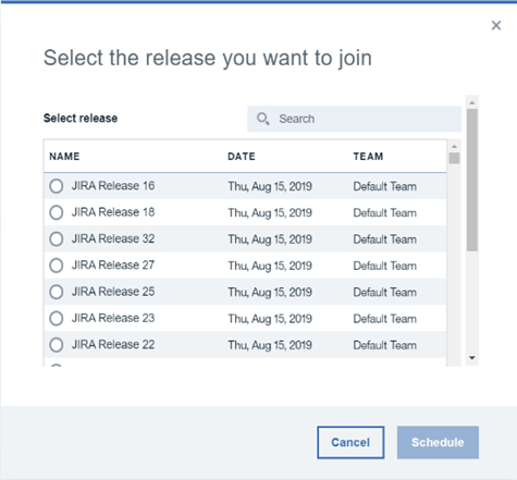

    2. If Join release is selected as the default deployment mode, the Join release modal window is displayed.
      Figure 2. Join release modal window

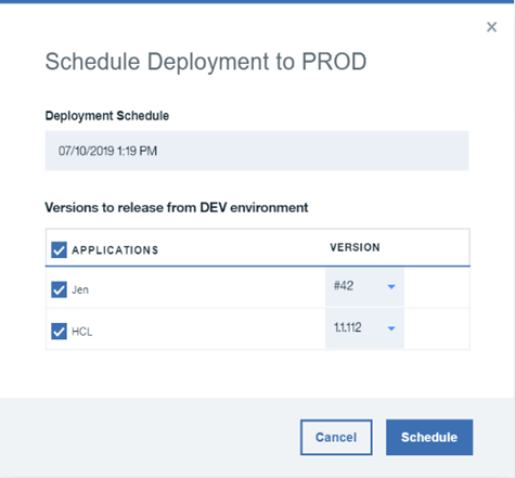

    3. If Schedule deployment is selected as the default deployment mode, the Schedule deployment modal window is displayed.
      Figure 3. Schedule deployment modal window

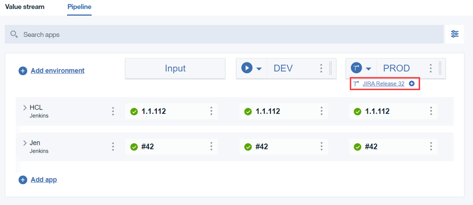

    After Join release is scheduled, the join release link appears below the PROD environment including the join release graphic and name. You can click the link to view the deployment plan page.
    Figure 4. Join release link
