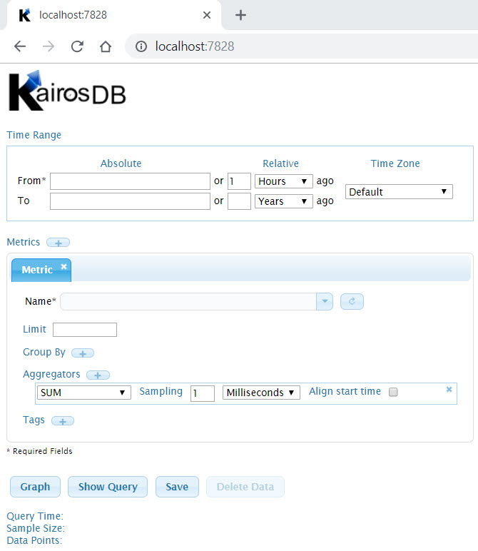

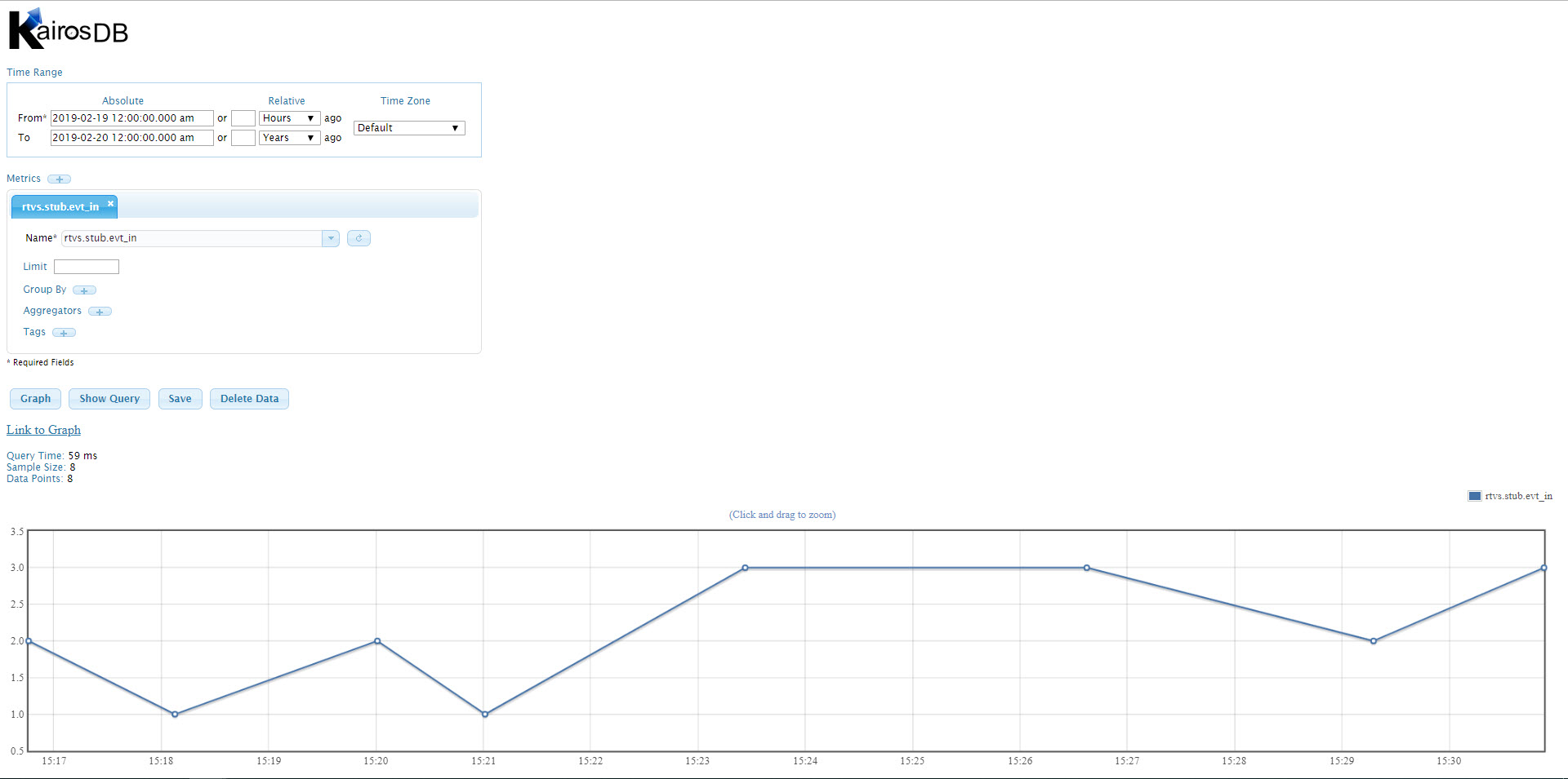

  1. Use the URL http://localhost:7828/ to launch the KairosDB UI.
    The KairosDB UI is displayed as shown in The KairosDB UI.
    Figure 1. The KairosDB UI
    image of the kairosdb UI.
    The mandatory fields to be selected are marked with an Asterisk (*).

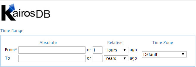

Selecting a time range and the time zone
You must first select the time range during which the KairosDB collected the metrics for the stubs. The time would correspond to the time when the stubs ran on Test Virtualization Control Panel.
You can also find the time when the stubs ran by using the Usage page accessed from Test Virtualization Control Panel. For more information, see Viewing usage statistics of virtual services in DevOps Test Virtualization Control Panel.
  1. Launch the KairosDB UI.
    See Launching the KairosDB UI. The Time Range panel in the UI is as shown in The Time Range panel.
    Figure 2. The Time Range panel
    image of the time range panel in the UI.
  2. In the Time Range panel, select one from the following options:
    1. Select an Absolute range.
      You can specify a definite time range. You must select the date and time from when the stubs were run on Test Virtualization Control Panel in the From field by clicking the field and selecting the date. You can set the time by using the slider against Hour, Minute, second, or millisecond. Click Done to set the date and time. Optionally, you can set the date and time in the To field for the end time for this range. If not, the time from the set time until the current time will be considered as the time range.
    2. Select a Relative range.
      You can specify a relative time range. You must enter a number in the first box and select the unit from the list of options that includes Years, Months, Weeks, Days, Hours, Minutes, or Seconds. For example, you can select the relative time as 1 Week ago, from the current date. Optionally, you can set the relative time in the To field for the end time for this range. For example, if you want to select the time as the previous two months, you can set 3 Months ago, in the From field and 1 Month ago, in the To field.

  1. From the list in the Name field, select any one metric. For example, rtvs.stub.evt_match. See Selecting metrics in the KairosDB UI.
    Figure 3. Selecting metrics in the KairosDB UI
    image showing selecting a metric in the UI
    The following metrics are supported starting from 9.2.1 onwards:
    • Events passed through (rtvs.stub.evt_passthrough). You must have set the pass-through configuration for the stubs. See Configuring stub pass-through behavior.
    • Events that match input filters and are processed (rtvs.stub.evt_match).
    • Events handled by a stub (rtvs.stub.evt_in).
  2. Set the number of records for which you want to view the metrics in the Limit field. For example, 100.
  3. You can view the graph of the metric by clicking Graph or you can proceed to view the graph after you group metrics and add aggregators to the grouped metrics.

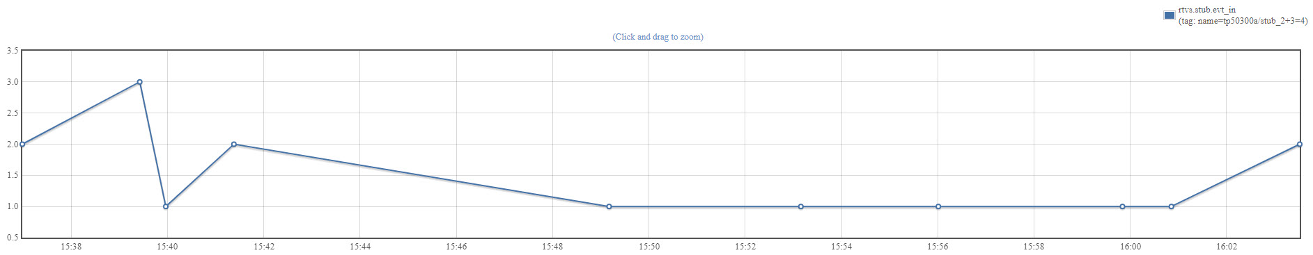

You can view the basic graph for the query or you can customize the view by grouping the data points and assigning aggregators to the grouped metrics.

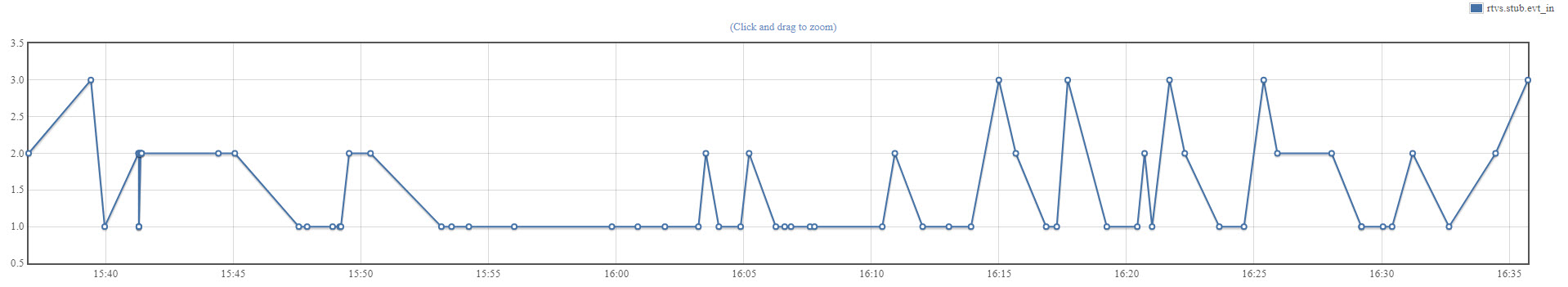

A sample of the graph generated by the query for a single metrics is shown in Graph showing the stub metric values. The graph shows the different stubs grouped with their names as tags.
Figure 4. Graph showing the stub metric values
image of the basic graph showing the stub metric values.

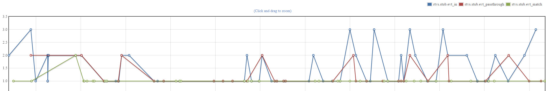

Another sample in Graph of the three stub metrics shows the graph for the different metrics collected for the stubs. The metrics queried include rtvs.stub.evt_in, rtvs.stub.evt_match, and rtvs.stub.evt_passthrough.
Figure 5. Graph of the three stub metrics
image of the basic graph showing the three stub metric values.

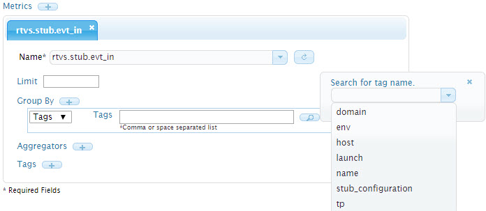

Grouping by tags
  1. To add a grouping item, click the image of the add icon icon adjacent to Group By label.
  2. Select Tags from the list. The screen shown in The Group by panel is displayed.
    Figure 6. The Group by panel
    image of the group by panel.
  3. Enter the tags you want to select for the data points in the Tags field. You can also use the Search icon (image of the search icon) and add the tags from the list displayed for the metric. See Adding Tags to the group.
You can add multiple Group by items for the same metric by completing the tasks in Step 1 to Step 3.

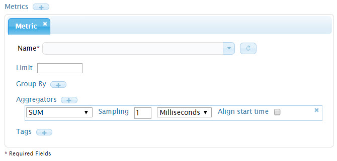

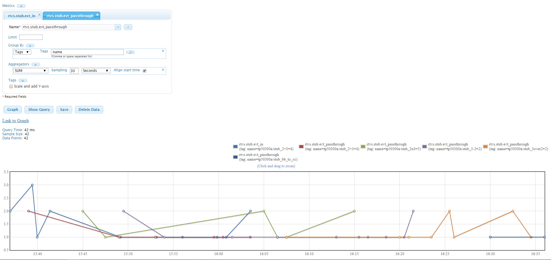

Assigning aggregators
After you group the data points, you can assign aggregators to the grouped data points so that the selected operation is performed on the data points. For example, you can count the number of data points that exist in a 10-minute time period.
  1. To add an aggregator, click the image of the add icon icon adjacent to Aggregators.
    The screen shown in The Aggregators panel is displayed.
    Figure 14. The Aggregators panel
    image of the aggregators panel.
  2. Select an aggregator from the list.
    The list shown in List of aggregators is displayed.
    Figure 15. List of aggregators
    image of the list of aggregators.
  3. Enter the number of data points you want to group in the Sampling field.
  4. Select the time value from the list for the grouping.
  5. Optional: Click the Align start time check box if the grouped data points must have the same starting point in the graph.
  6. Click Graph to view the graph for the query created.
The graph is displayed for the query you created.
Graph showing metric values grouped and an aggregator assigned shows a sample graph displayed when the query is set up by grouping by the tag name and an aggregator (Sum) is set to sum the data values of the stub metric (rtvs.stub.evt_in) in a 30-second interval.
Figure 16. Graph showing metric values grouped and an aggregator assigned
image of the graph of a metric grouped and an aggregator assigned

Viewing a basic graph
  1. In the KairosDB UI, click Graph.
    The graph shown in Graph of the stub metrics, as an example, is displayed for a query for the stub metrics in the selected time range.
    Figure 19. Graph of the stub metrics
    image showing a simple graph of the stub metrics.

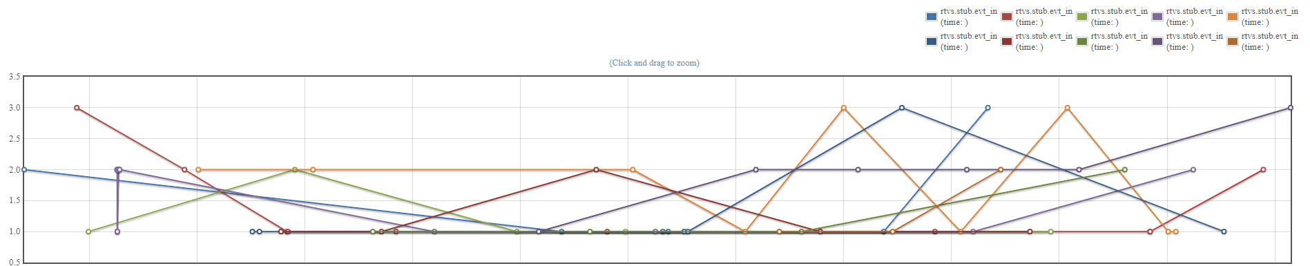

Viewing a graph

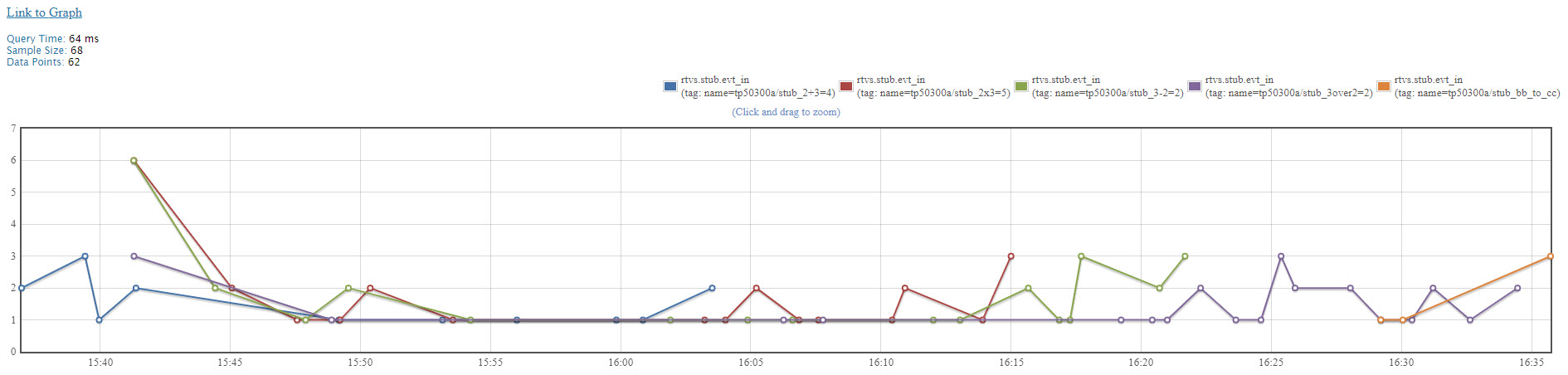

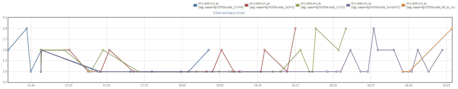

  1. When you create a query for multiple stub metrics with one of the metrics that is grouped by tags, and an aggregator (SUM) is assigned, and you click Graph, the graph displays. As an example, see the graph displayed in Graph of the metrics query for such a query.
    Figure 20. Graph of the metrics query
     image of the graph for the stub metrics queried.

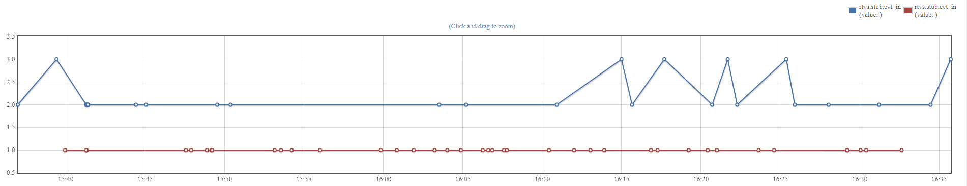

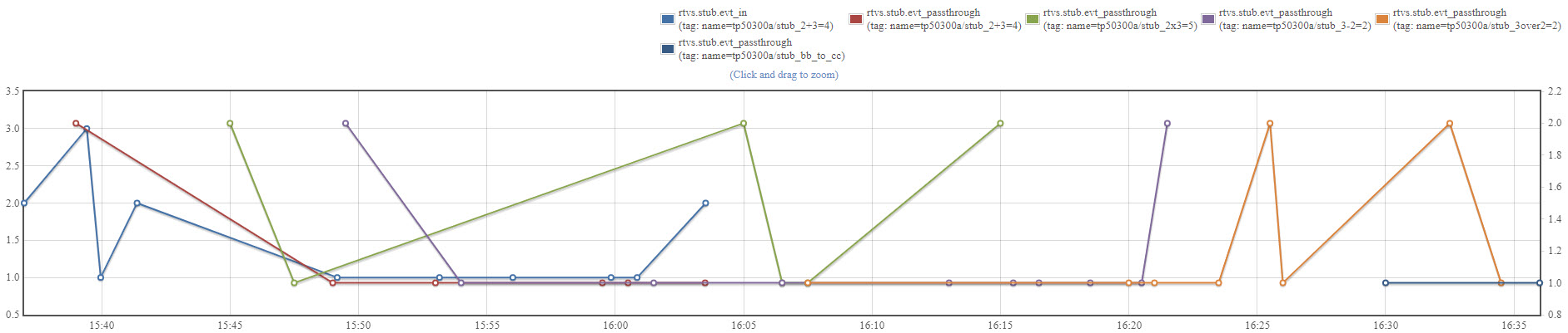

Scaling and adding the Y-axis
  1. When you create a query with multiple stub metrics, the Scale and add Y-axis field is displayed. Select this option to add the Y-axis and scale the data series. An example graph is shown in Graph of the metrics query with scale and Y-axis added. You can compare the displayed graph to the graph in Graph of the metrics query to see how the display differs because of the scaling and with the Y-axis added.
    Figure 21. Graph of the metrics query with scale and Y-axis added

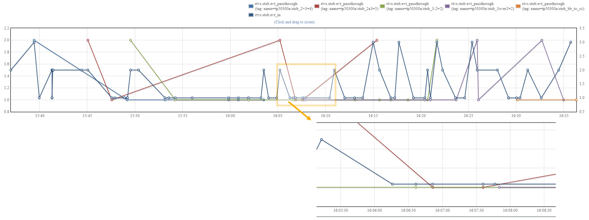

Using the zoom feature
  1. You can zoom in and enlarge part of the graph by clicking on the graph and selecting an area you want to zoom in on as shown in View of the zoomed part in the graph.
    Figure 22. View of the zoomed part in the graph
    Image of the graph showing the zoomed part.

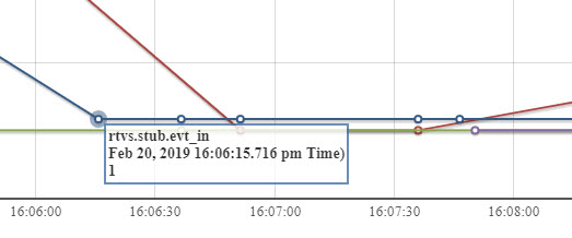

Viewing data point details
  1. You can view the details of the data point by hovering over the data point in the graph as shown in Hovering over a data point.
    Figure 23. Hovering over a data point
    view of the hover message displayed for a data-point.

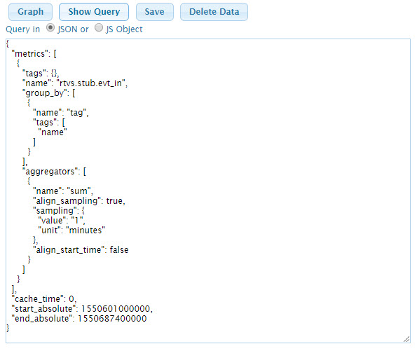

Viewing and saving the query
After you create your query by using the KairosDB UI, you can view the query and save it to the local folder that you can use later to reload the query in the KairosDB UI.
Viewing the query
  1. Click Show Query to view the query you created by using the KairosDB UI. You can view the query in the JSON format or as a JS Object by selecting the appropriate button in the displayed query.
    The query is displayed as shown in the following sample.
    image of the query box
Saving the query
  1. To save the query to your local folder, click Save.
    You can save the query as a CSV file or a JSON query text file by clicking the appropriate button in the dialog displayed.
  2. Navigate to the folder you want to save the file in, provide a name for the file, and then click Save.
You can save your query as a JSON query text file that you can use later in the HTTP requests to get the data points and their values in the HTTP response.

  2. Use the URL http://localhost:7828/api/v1/datapoints/query to send the request.
  3. For HTTP POST, place the JSON query in the body of the request.
  4. For HTTP GET, there is no message body, the JSON query is appended to the URL in the form of a query string. Encode the JSON query in HTML format as shown in the following example:
    http://localhost:7828/api/v1/datapoints/query?query=%7B%22metrics%22
The response to the HTTP GET or HTTP POST request returns the data points and their values in the JSON format.
