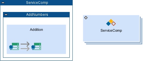

Expanding and collapsing components
You can view Service components in an expanded (default) or collapsed state.
To change the current state of a component, simply click the expand/collapse icon (in the title bar). The image illustrates the same component in its expanded and collapsed states:
