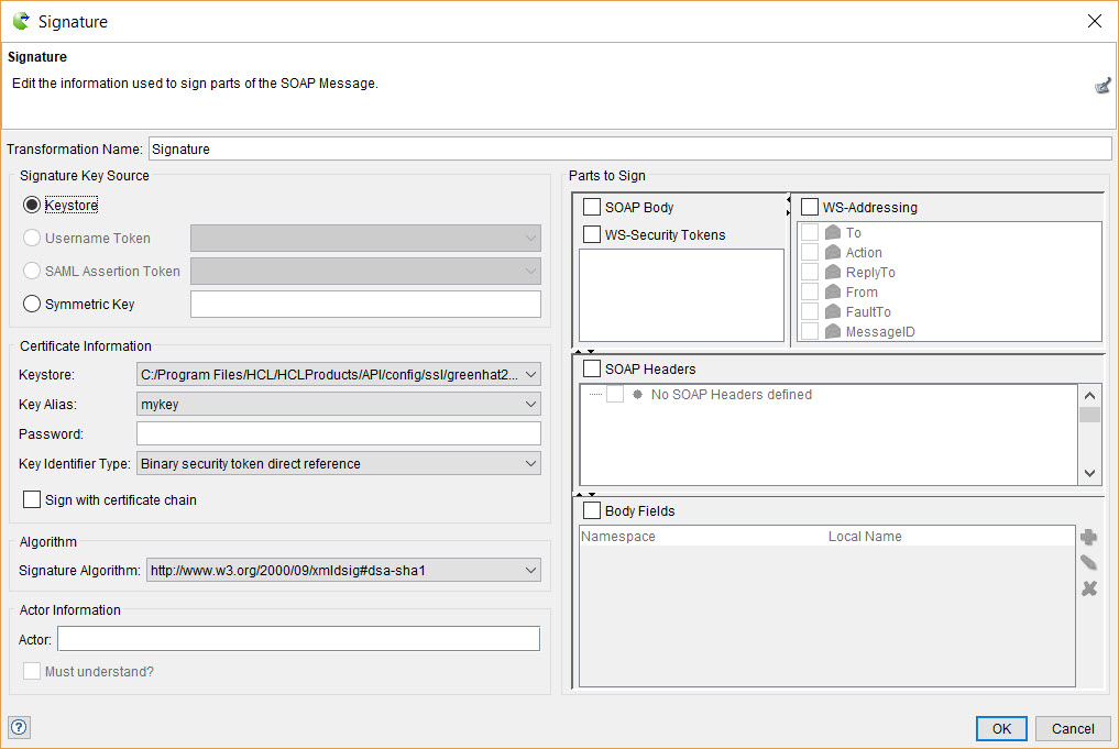

  7. Perform the following steps to use the asymmetric key-based signature algorithms to sign messages:
    Image of the Signature window.
    1. Perform the actions indicated in the following table:
      Option Description Action
      Transformation Name Specifies a user-defined name for the security action. The name helps you to identify the action in the main list. Enter a name for the action or continue to use the default name listed as Signature.
      Signature Key Source panel
      Keystore Specifies whether to sign with a keystore (identity store) provided by HCL DevOps Test Integrations and APIs (Test Integrations and APIs).
      The keys used in the keystore are asymmetric keys and are based on any of the following signature standards that are supported:
      • DSA-SHA1
      • ECDSA-SHA1
      • ECDSA-SHA256
      • ECDSA-SHA384
      • ECDSA-SHA512
      • RSA-SHA1
      • RSA-SHA256
      • SHA1
      • SHA384
      This is the default option that is selected.
      Retain this default option as selected.
      Username Token Specifies whether to sign with a user token.
      These fields are enabled only if you created a user token by using Digest or Nonce and with the Created options enabled.
      Enter the user token and the assertion token.
      SAML Assertion Token
      Symmetric Key Specifies whether to use the symmetric key-based signature algorithm for signing. Do not select this option if you want to use asymmetric key-based signature algorithms.
      Certificate Information panel
      Keystore Specifies the keystore that contains the digital certificates and private keys. Select the keystore to use.
      Key Alias Specifies the private key alias to use that is defined in the selected keystore. Select the key alias to use.
      Password Specifies the password to use for the certificate that is in the keystore. Enter the password to use.
      Key identifier type Specifies how the signature key is referred.
      Select from the following options:
      • Binary security token direct reference
      • Issuer serial
      • X509 key identifier
      Sign with certificate chain Specifies whether the signing is done by using the certificates that are available in the keystore. Select this option if you want to use the certificate chain for signing.
      Algorithm panel
      Signature Algorithm Specifies the asymmetric key-based signature algorithm to use for signing. Select the signature algorithm from the following algorithms that are supported:
      • DSA-SHA1
      • ECDSA-SHA1
      • ECDSA-SHA256
      • ECDSA-SHA384
      • ECDSA-SHA512
      • RSA-SHA1
      • RSA-SHA256
      • SHA1
      • SHA384
      Actor Information panel
      Actor Specifies a specific message receiver (either the ultimate receiver or an intermediary). For each actor or role that is defined (that is, in multiple tokens), a separate security header is added to the SOAP header. Specify a message receiver.
      Must understand Specifies the following action:
      • When enabled, makes the SOAP header mandatory for the specified actor or role. In this case, either the header block must be processed or the entire SOAP message is ignored, and a SOAP fault is generated.
      • When not enabled, the specified actor or role may or may not process the SOAP header.
      Perform any of the following actions:
      • Retain the default option as unselected.
      • Select this option.
      • Clear the selection, if it is selected.
    2. Continue to configure the other settings for the outgoing messages as described in Step 9.

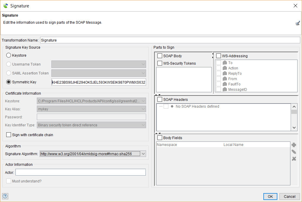

  8. Perform the following steps to use the symmetric key-based signature algorithms to sign messages:
      Transformation Name User-defined name for the security action. The name helps you to identify the action in the main list. Enter a name for the action or continue to use the default name listed as Signature.
      Keystore Specifies whether to sign with a keystore (identity store) provided by Test Integrations and APIs.
      This is the default option that is selected. Do not select this option if you want to use symmetric key-based signature algorithms.
      Select the Symmetric Key option to clear this default selection.
      Username Token Specifies whether to sign with a user token created by using Digest or Nonce.
      These options are not enabled when you select the Symmetric Key option.
      Symmetric Key Specifies whether to use the symmetric key-based signature algorithms. Perform the following steps:
      1. Select this option if you want to use symmetric key-based signature algorithms.
      2. Enter the hexadecimal key that is used to sign the outgoing messages.
      Algorithm panel
      Signature Algorithm Specifies whether to use the symmetric key-based signature algorithm for signing. Select the signature algorithm from the following algorithms that are supported:
      • HMAC-MD5
      • HMAC-SHA1
      • HMAC-SHA256
      • HMAC-SHA384
      • HMAC-SHA512
