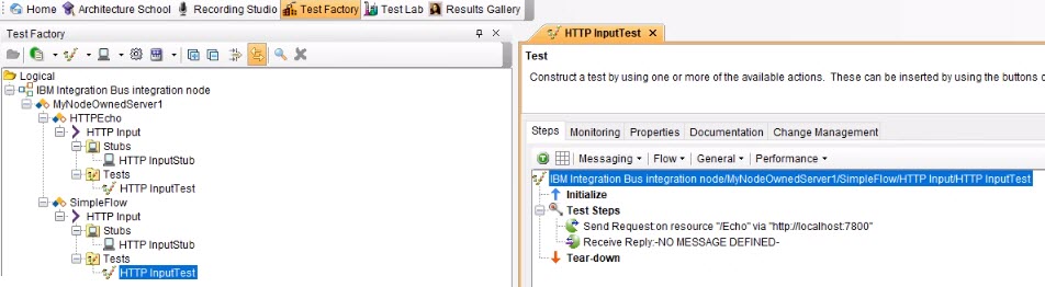

If you completed the synchronization with IBM® Integration
Bus, the Test
Factory view is displayed with the tests that were created.
- Select the test or stub that you want to run.
Right-click the test or stub and select
Run.
The selected test or stub runs, and the Test Lab view is displayed with the results of the run.Note:You can select one or multiple tests or stubs that were created and run the tests or stubs.
