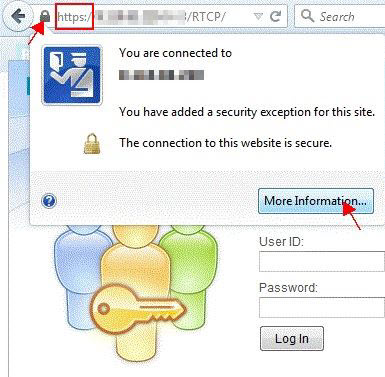

  2. Open Test Virtualization Control Panel in a browser by using its secure URL. For example, https://myServer:5443/RTCP.
  3. Click the lock symbol shown in the address bar.
  4. Click More information in the dialog.

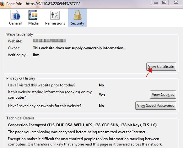

  5. In the Page Info window, open the Security tab and click View Certificate.
  6. In the Certificate Viewer window, open the Details tab and export the "Test Integrations and APIs Root CA certificate".

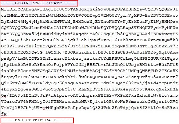

  7. In the Save Certificate To File dialog, select PEM against Save as type. For example, X.509 Certificate (PEM) (*.crt,*.pem).
  8. Click Save. If you open the saved certificate in a text editor, it looks similar to the following snippet:
The Test Virtualization Control Panel server certificate is exported to a file.

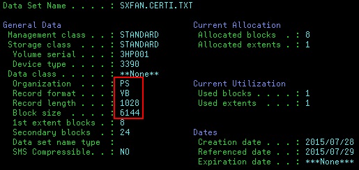

  1. Allocate a dataset with the parameters highlighted in the following screen shot:

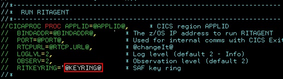

  7. Set the key ring name in the RITAGENT, changing the value @KEYRING@ to the name of your key ring:
You have configured the CICS® Distributed Program Link (DPL) Agent to use HTTPS. You can now define resources and start the CICS Transaction Server Agent.
