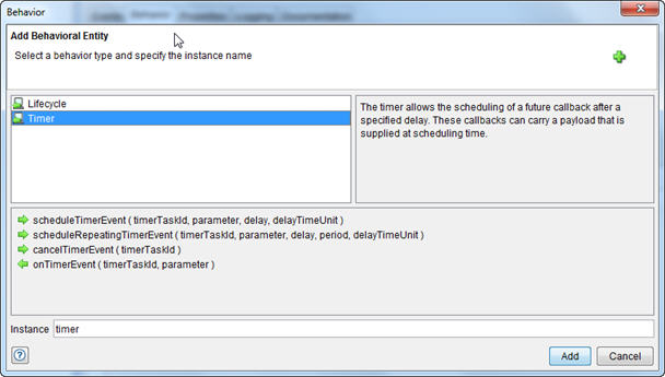

| Add | Opens the Add Behavioral Entity dialog. ![]() The upper left side of the Add Behavioral Entity dialog displays the available behavior-types. The upper right side of the Add Behavioral Entity dialog displays a description for each selected behavior-type. The
default available behavior-types are as follows:
The lower half of the Add Behavioral Entity dialog displays the available sample behaviors for the currently selected behavior type. The Instance field is used to refer to the behavioral entity in function actions. This field is optional so that you can create multiple instances of a behavior. Based on the selected behavior, a default instance name is displayed. If required, you can specify a different instance name. The following sample
behaviors are listed:
The following table describes each of the Timer function
behaviors that you can use to schedule a single timer event, schedule
a repeating timer event, or cancel a timer event.
An example of calling a Function Action from the logon
event for setting a timer to log out the user from a session after
a specified time period. In
this example:
Tip: To select multiple behaviors for a behavioral
entity, hold the Ctrl key and click each behavior
after you select a behavior-type on the upper left side of the Add
Behavioral Entity dialog. After you specify the properties of a behavior, click Add to create the behavior and to close the Add Behavioral Entity dialog box. Tip: Although behavioral entities
display on the list window on the upper left side of the Behavior tab,
each new behavioral entity also has its events (qualified by the name
of the behavior instance) available as values in the Events field
on the Events tab for the stub. For more information,
see The Events tab. |
