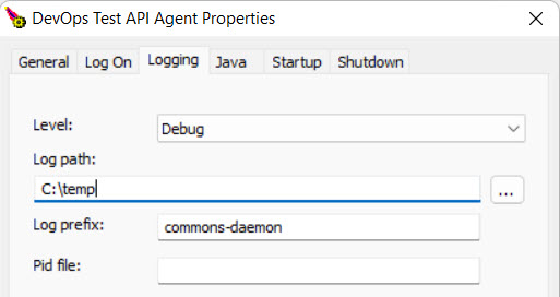

- It is possible to add low-level logging to the service itself. Run the
following command:
prunmgr //ES//OneTestAPIAgent
- Set the Level to Debug and configure the Log path folder name.
- Restart the service and check the log files. Three log files are produced:
commons-daemon.2023-09-22.logonetestapiagent-stderr.2023-09-22.logonetestapiagent-stdout.2023-09-22.log
