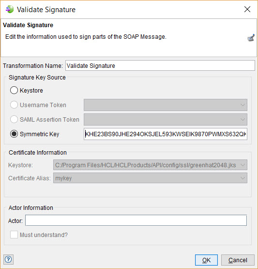

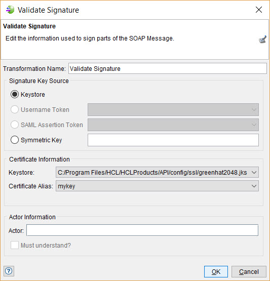

Perform the following steps to configure the validate signature action if the asymmetric
key-based signature algorithms was used to sign messages:
Perform the following steps to configure the validate signature action if the symmetric
Complete the following steps:
