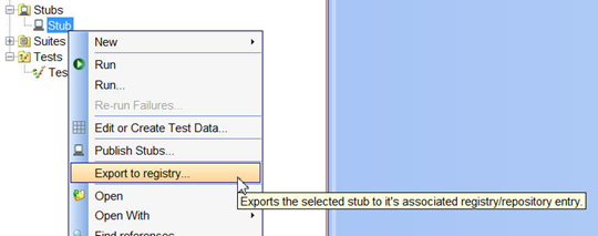

Right-click it in the Test Factory and select Export to registry from
the menu.

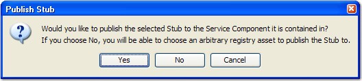

When you are publishing the stub, you are asked whether you want to publish it to the service component that contains it.
- If you choose Yes, the stub is published to the containing service component on the CentraSite server. If you choose No, the registry browser is displayed. You can then locate and select a different asset to which the stub is published.

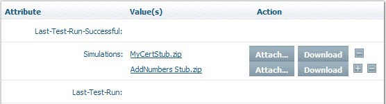

In CentraSite, published stubs can be seen under the GH Tester tab when you are viewing a service from the Asset catalog.
