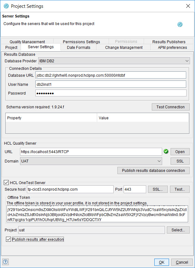

You can configure the auto-publishing option for publishing test result reports to HCL OneTest™ Server by using the Project Settings menu option. When the auto-publishing option is activated, the test result report is automatically published to HCL OneTest™ Server whenever you run a test suite or test in HCL OneTest™ API.
Click , and then click the Server
Settings tab.
Use the fields under Results Database to
create or modify a database connection:
In the HCL®
Quality Server section, complete the following steps:

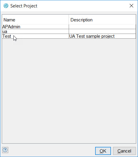

In the HCL
OneTest Server section, complete the
following steps:
Click OK.
You have configured HCL OneTest™ API to publish test result reports to the selected project on HCL OneTest™ Server.
