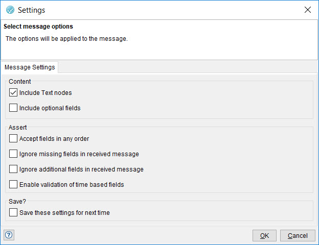

- Click Options to open the Select message
options dialog, and enter additional settings for messages.
- Click OK.
