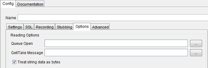

Setting the message reading format
The
option Treat string data as bytes, when selected,
enables HCL OneTest™ API to read the body of the MQ messages that
are in MQSTR format as raw bytes instead of as a string.
By using this option, you
deal with bytes rather than with string data. This is useful when
the character set information for a received message is incorrect.
After enabling the option, do these steps:
- Go into a test or stub and manually apply a bytes schema to the data field of the message body. Within HCL OneTest™ API, an MQ message that is of MQSTR format contains a text field in the body by default. To update the message so that it can handle bytes data, first delete the existing text field, add a data field, and then apply the bytes schema.
- Select an encoding method that should be used to treat the message as a string. Doing so eliminates the need for automatic conversion. Automatic conversion sometimes produces unexpected results due to incorrect character set information.
When the message is sent back from HCL OneTest™ API, for example, by using pass-through action in a stub, the conversion of MQSTR to bytes is automatically undone and the message arrives in the queue in its original form (in MQSTR format).
