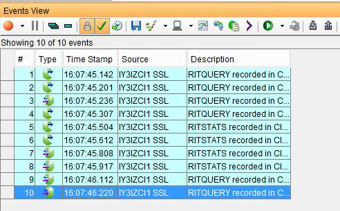

Note:CICS programs RITQUERY and RITSTATS are installed as part of the installation of the CICS® Transaction Server (TS) agent. Clicking Test Transport calls RITQUERY by using the ECIRequest API. The RITQUERY program links to RITSTATS to retrieve information such as the CICS job name, CICS level, and OS level. Recording the resource, while clicking Test Transport captures the data flows.
A COBOL copybook is provided in
HCL OneTest™ API Installation Directory\examples\COPYBOOK\RITSTATS.CPY. This copybook can be imported as a schema for the message data.
